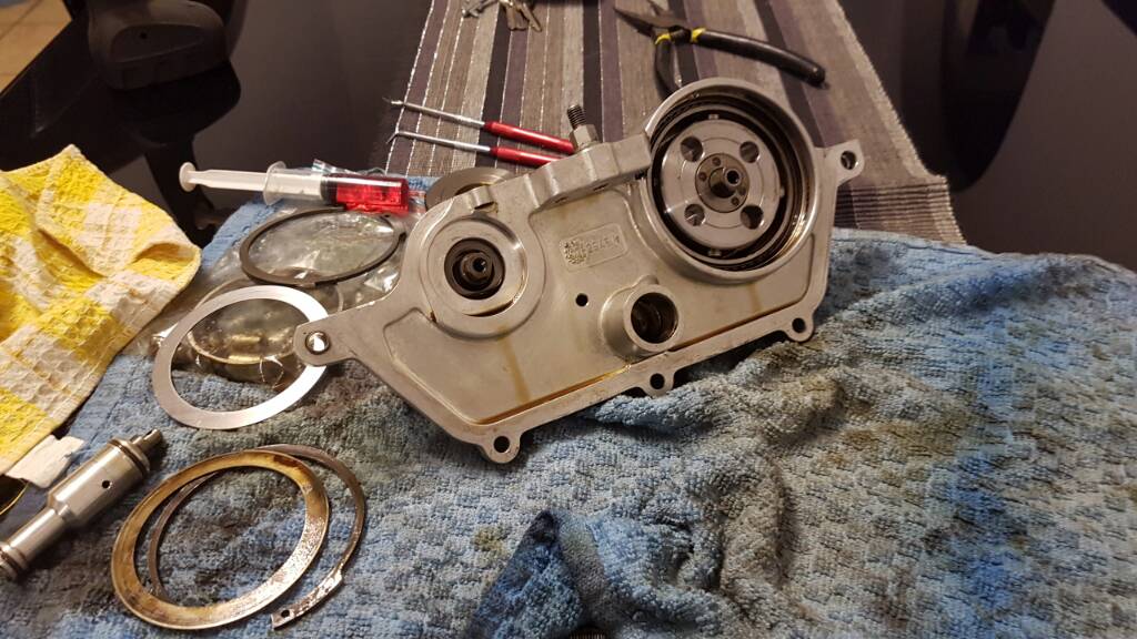

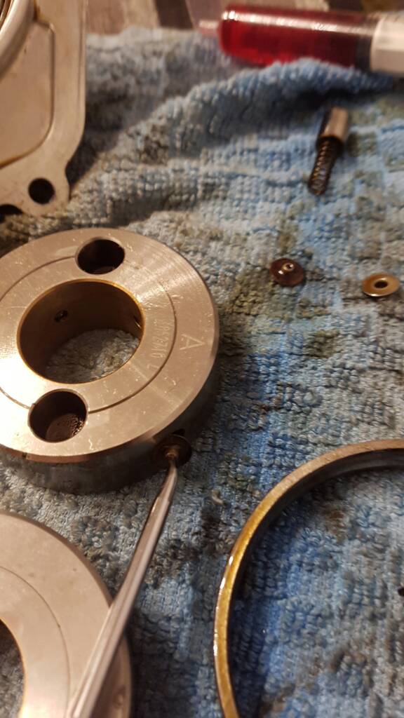

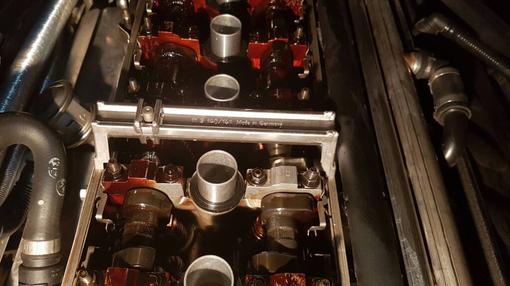

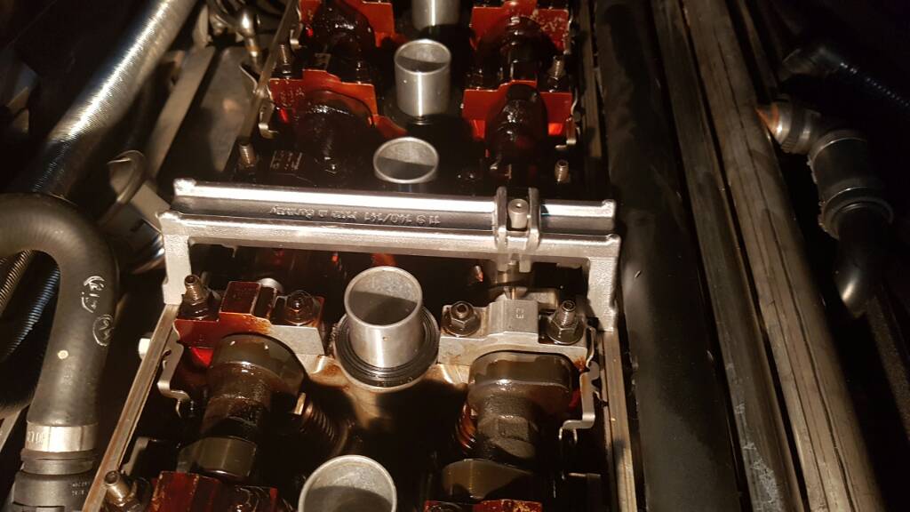

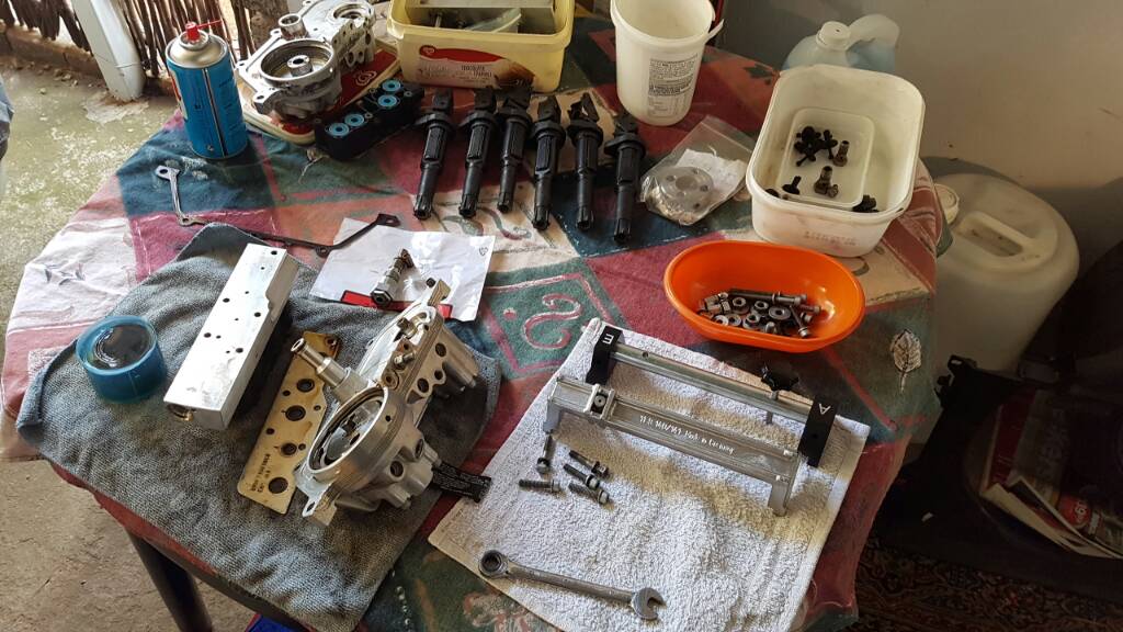

So there was an intermittent hesitation that popped up and I suspected Vanos. Having checked the timing not long ago I was curious to see what the issue was.
I decided to strip everything down and inspect.
Vids to follow...

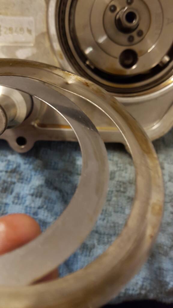

Now this was interesting to find. Leads me to think the car was worked on before.
Luckily I had a spare vanos lying around so swapped out the good bits
Oil pump disc exchange
Assembled using BMW AG TIS and pleased with the results

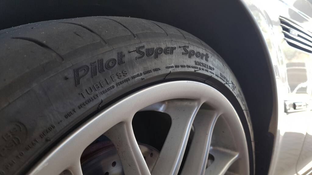

Since the big end bearings were done I've done around 2000kms including today's supertraxx sunday at Zwartkops
Seeing as I found some Michelin Pilot super sports for her I decided to punish the Toyo's that are on her at the moment.

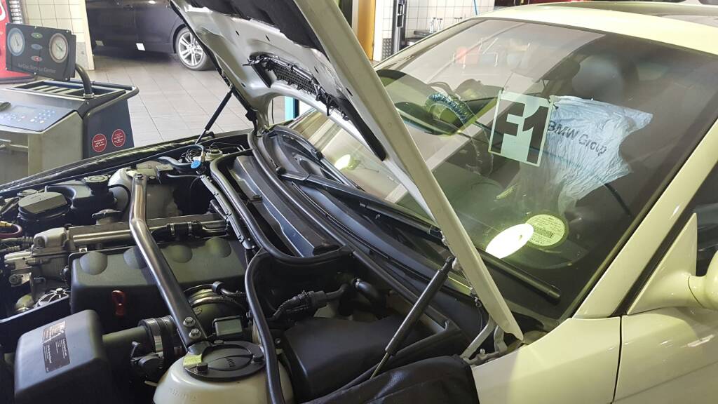

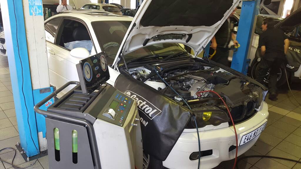

After having the lovely new tyres fitted I decided to pay John at Leo Haese Pta a visit.
Booked her in for a brake fluid flush and aircon topup.
Pics to follow
Andy1GP
Also had the vanos test ran and she passed with flying colours!
I can not thank John enough for the work carried out on the car at the rate they charge as well. I will always support them

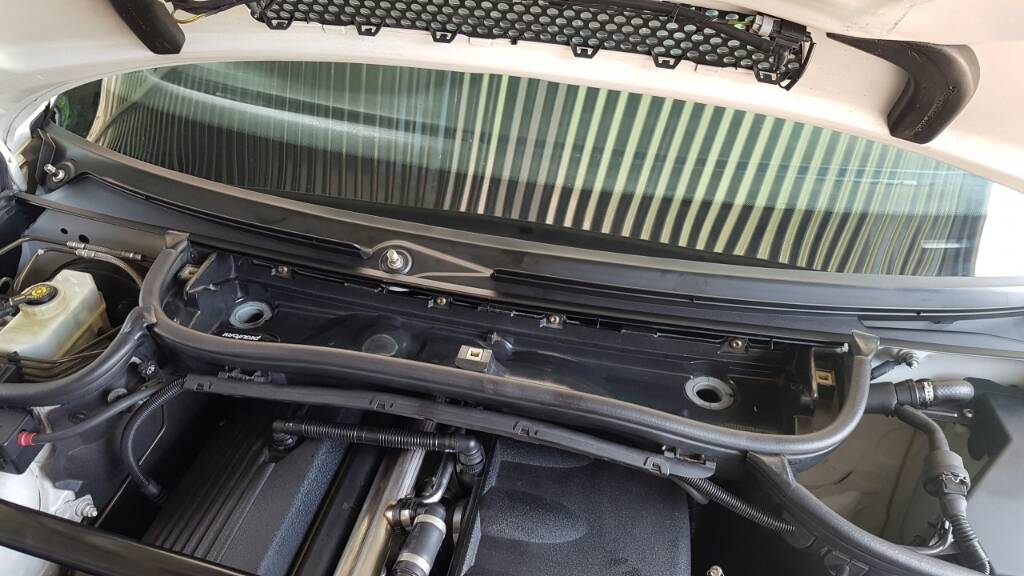

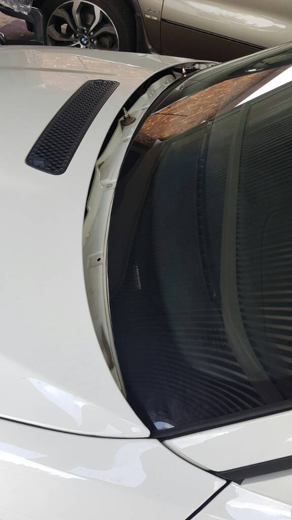

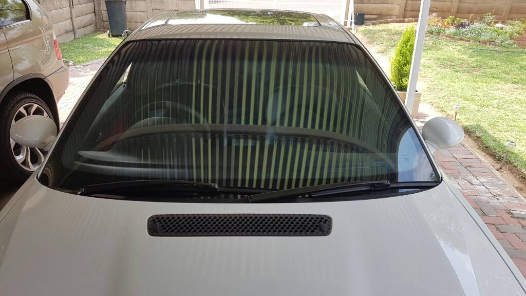

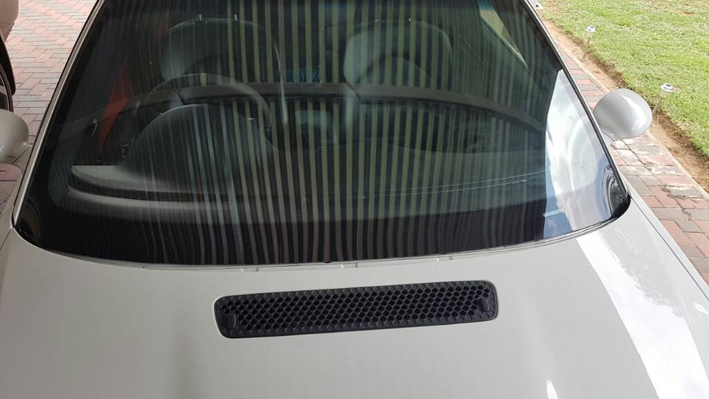

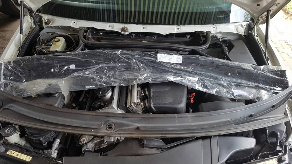

From using it as a daily I picked up some stone chips on the windscreen and ended up replacing it this week.
At the same time I figured it a good time to replace the windscreen cover as well. The old one is still pretty good but what the hell.
New vs old
New one fitted

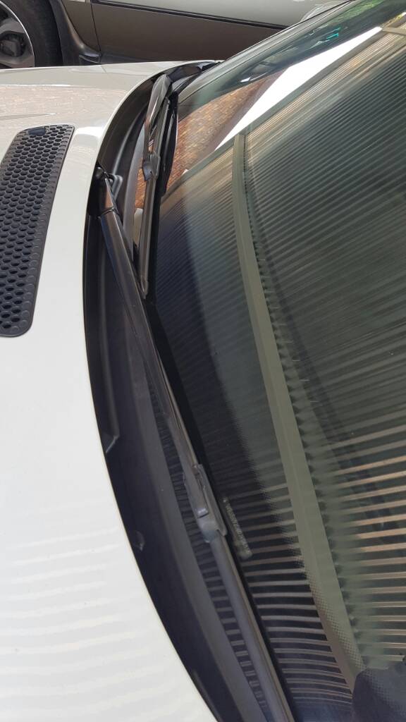

Also adjusted the wipers blades a little lower. For aerodynamics ofcourse :) and then its also nice to have them hidden away while driving and clear from view.
