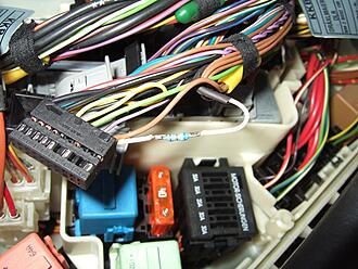

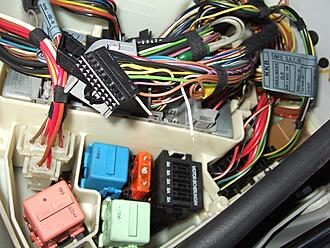

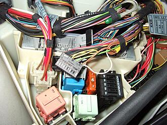

agree 100% , had smg for five years and used some tricks to help it stopping it from "popping" out of gear :)
if you intend to keep smg do service on smg pump asap!!!, check the actuator as well
also please for sake of all man kind DONT MAKE SMG YOUR DAILY!!..The pump gets very hot especially in traffic and the actuator does not like that at all, there is a fix for the SMG HYD Pump temp sensor being mounted way too close to the engine.
all you need is a 500-1K ohm resistor and splice it in series with the temp sensor located in the in ecu box:

Thanks bro.
It's my weekend car, barely will be in traffic.
Still using my polo for daily.
