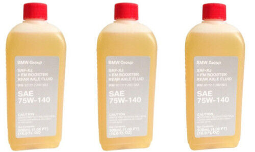

Howzit gents, for those who have the issue of the diff noise (not the clunk) when turning, sounds like suspension is rubbing.
I searched around and found the solution is a specific oil with Friction modifier (SAF-XJ 5) , its mainly for e92 m3 but according to an old BMW Sib notification you need to replace the diff oil with SAF oil + FM Booster (part # 83 22 2 282 583)
Did mine this morning and the noise is completely gone. Just some FYI

mine is COMPLETELY gone now , takes a bout week or 2 for the oil to completely mix through the shims and gears, i will do a video
AveshanM3
Thanks alot. I just ordered the oil now from BMW. I had some work done on the diff when i serviced the car and suspect the the oil that was replaced does not have FM Booster in it hence the noises from the diff now when turning.
