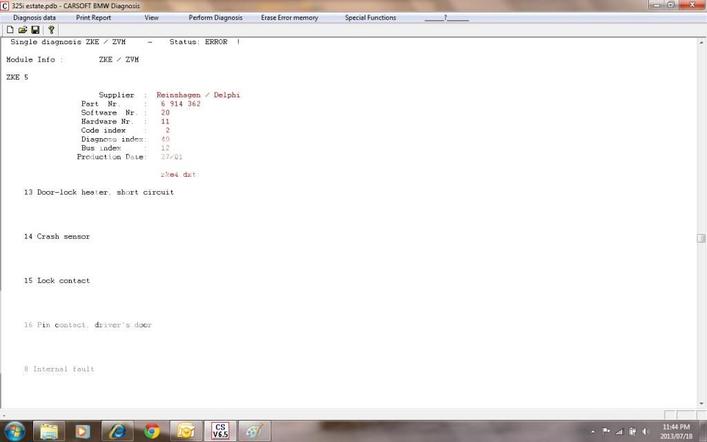

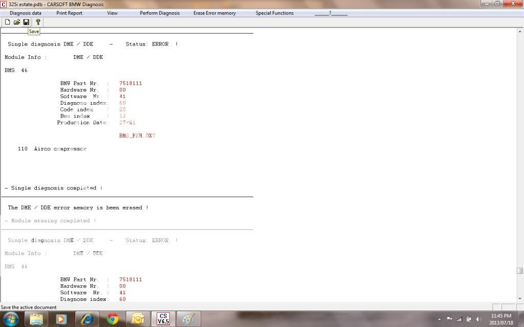

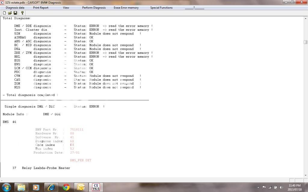

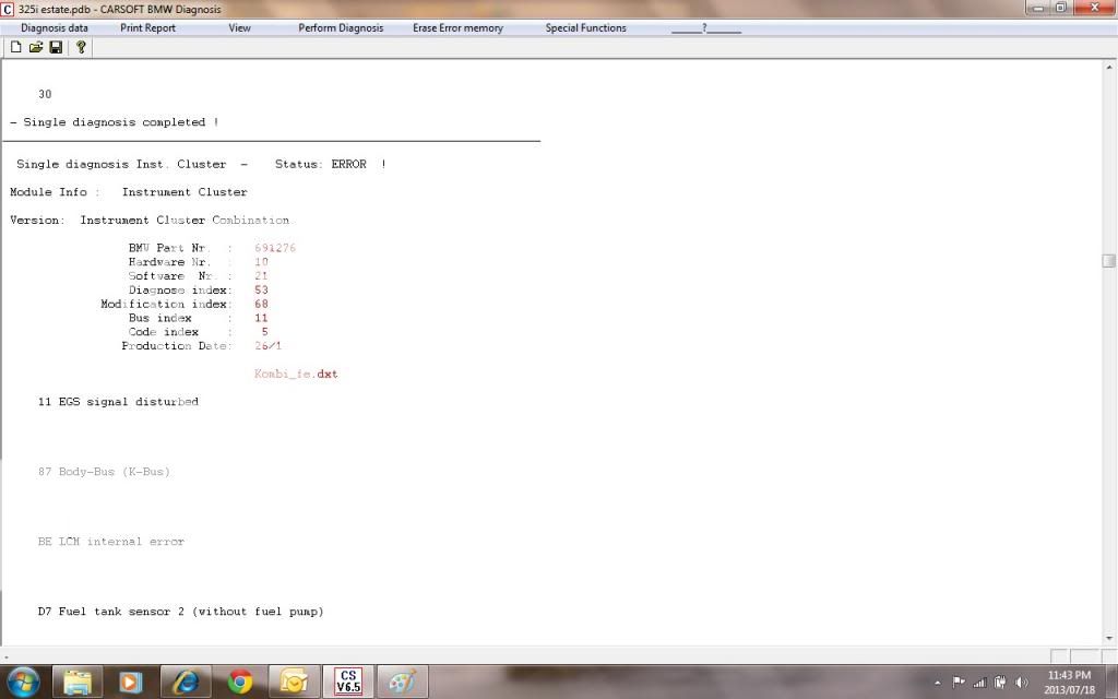

junaid watson
I would like to thank everyone who gave input much appreciate the help BIG thanks to ICEMAN who was so generous to come out and run the checks the error code we pick up was MAIN RELAY(switching delay)does anyone maybe know what that means and where the main relay is located.MANY THANKS once again:praise:
