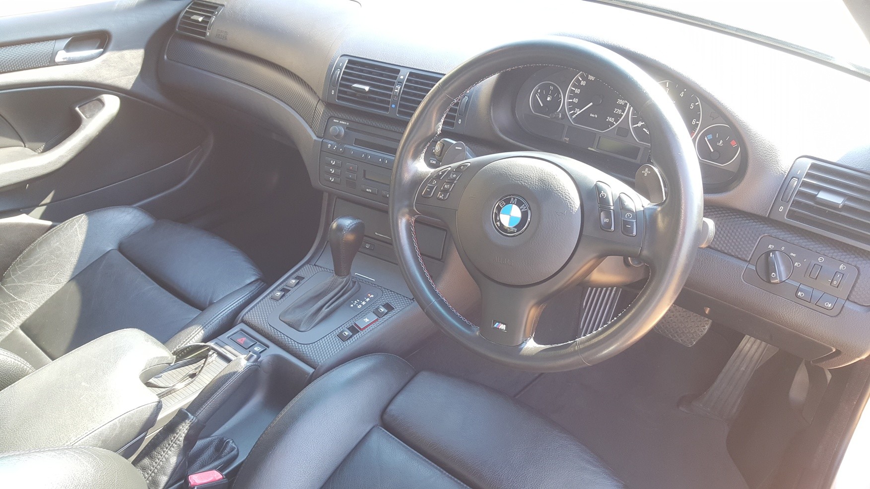

I have done such a retrofit on my 330i.

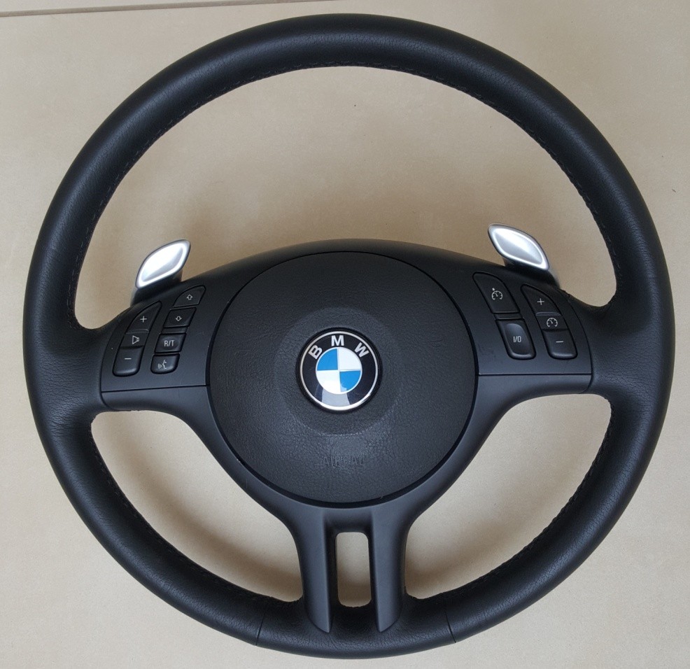

This is an SSG wheel:
The other type of SMG paddle shifters are found on E46 M3 cars with SMG gearboxes, these can be used without modifications on auto gearbox E46 cars.
This is an SMG wheel:
In both cases, you will need an SMG slipring which has the two additional contacts for the SMG switches. I have such a slipring but it is not for sale as I hope to also retrofit an SMG steering wheel to my own Touring as soon as I find another M3 SMG steering wheel.
You will also need to make up a simple wiring harnass to connect the slipring with the gear shifter in the center console. There are many DIY instructions on the ol' interwebs.
