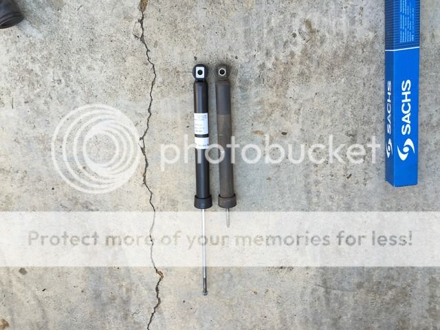

Changed the rear shocks this pass Saturday for all the guys that don't know whats behind all the panels on the touring now you can have a nice look
Old shocks versus new ones

moranor@axis said:
Hope you remembered to fit the shock tower plates :rollsmile:
Yep and the poly inserts for the shock mounts, was a very quick and easy fit:praise:

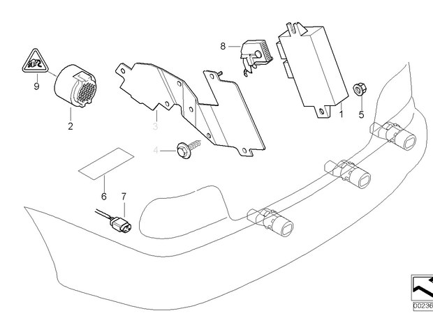

Does anybody know where the PDC control unit is situated on a touring?
Behind the carpet on the right side of the boot.
No. 1 in the diagram

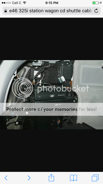

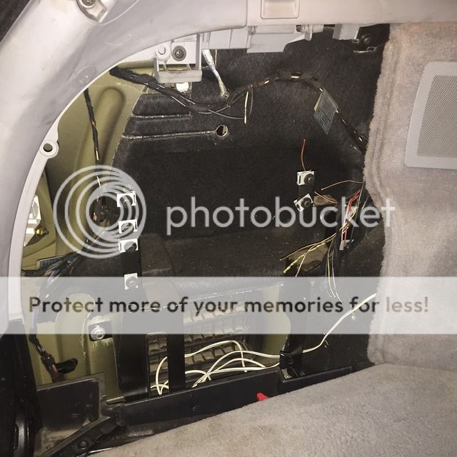

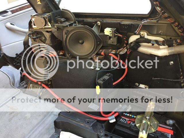

I have checked under the carpet but don't seem to find it on that side
This is what happened in CT in 2014, trying to source parts and repair
Is it not the black box on the top right corner of the picture maybe

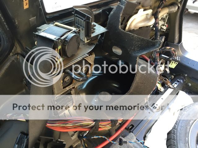

So got all my bush tools last week bought some bolts and started to strip and change halfway through clean forgot to take pics so carried on working:sorry:, all i can say that with out air tools they very hard to do. Only managed change 3 bushes because i stripped the nuts.
The bush extractor/installer works awesome used high tensile 10.9 grade bolts but still managed to strip the threads on the nut.
I either need to jack the car up much higher or get my car on the lift to work on, either way im enjoying the work for now.
Think im rather going to take the trailing arms off the car and try remove/install it that way as i still have to do the alignment as well.
