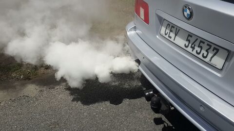

Here she is on idle for the last 15min and nothing water levels are good everything seems fine hope it not a cracked head! I really love my car sad day for me, not the Christmas gift I was hoping for lol!

kylebdnhrst82
Hey guys just a update!
Did the compression all good water and oil on the same levels since the incident, so I did the ccv valve and hoses took here for a drive andall looks good hope it was the problem!
