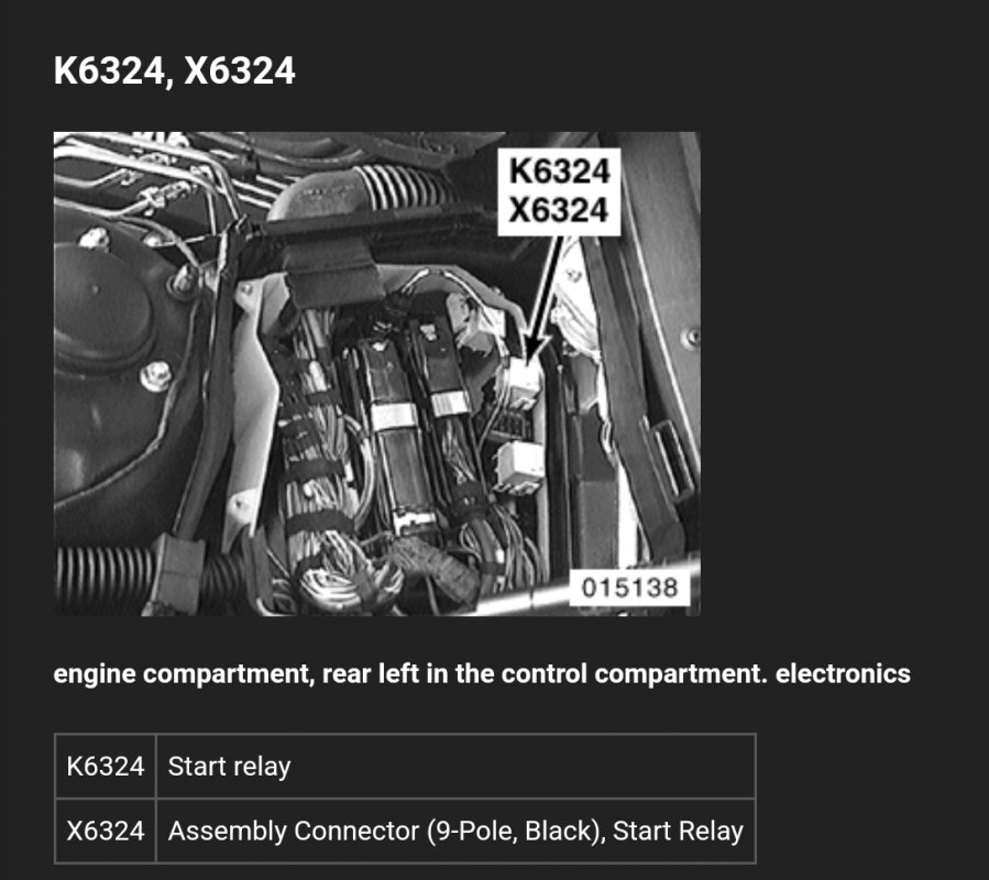

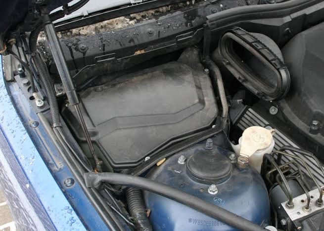

MARHD
Should be under the left cabin filter in the engine bay and be this relay.

nirvash
Thanks, will give that a try, never knew there were relays in that spot!

nirvash
When you mentioned the left side, I thought you meant where the brake booster and reservoir are. Not where the DME is. I tried replacing the relay for the started in the DME box, still no luck.
Will at least check on INPA tomorrow if the Relay error message still comes up.
