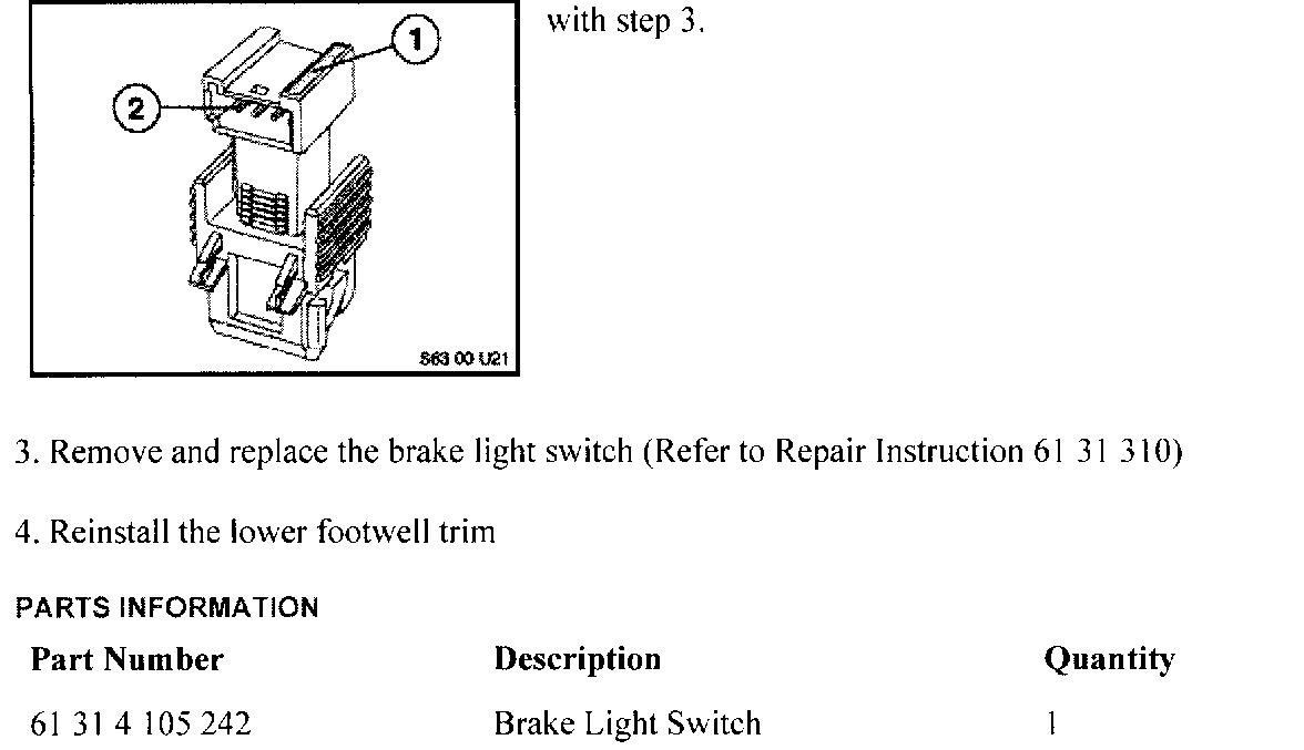

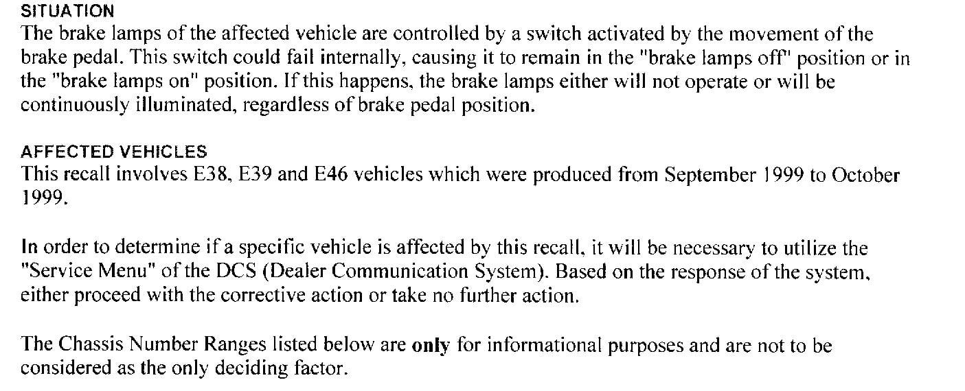

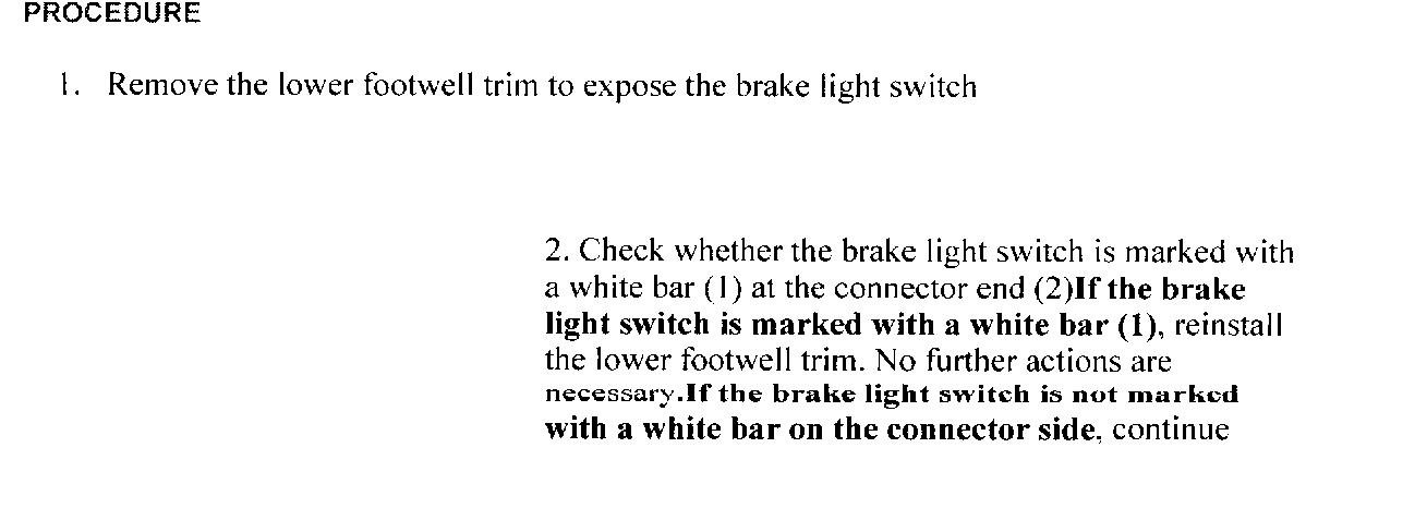

So I had an issue with my brake light switch on my 540/6.
Turns out I had the switch that was part of a recall that was never done on my car.
So a google, short call to BMW and the shock as they told me the price.
More google to find this.
WhatsApp Image 2022-11-08 at 14.07.53.jpgWhatsApp Image 2022-11-08 at 14.08.03.jpg

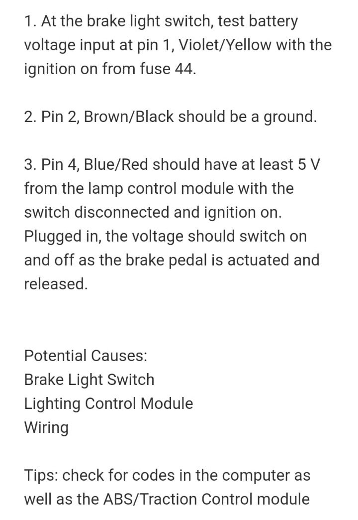

Also found this reply should you be bothered to check.

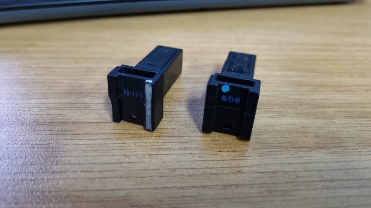

And then the picture of the two next to one another. Note I didn't pay dealer price and found one close to my work in another car. . . ;)
