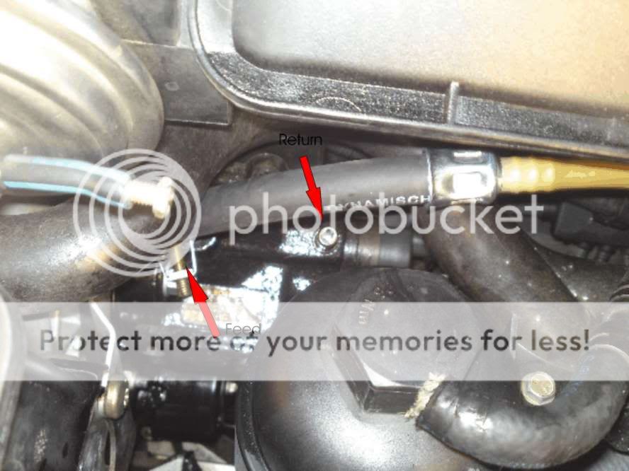

I have just replaced, some feed and return pipes on my 530d, I am sure that
other oilburners with around 200k kms should check theirs as well , the pipes
in time get vrot from the heat exposure and start to crack.
Here is a picture of the feed and return pipe connections that must be checked.

I'm going to strip the covers soon to see as it may possibly be these pipes spoken of in the original post.
It might also be an injector, as far as I've read.
