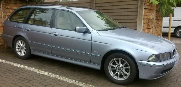

2003 Model - recently replaced the original shocks (mileage is on 175,000kms) fitted by a HiQ dealer (only Monroes were available according to them for this vehicle, otherwise the agents (who don't have and will need to order from Germany - 10 - 15 days shipping and R6,500 later for 2 rear shocks. I was told rear shock mountings were still fine and didn't need to be replaced. There was a terrible vibration on the rear for about 700kms, took it back and discovered that the directional tyres were put on the wrong way, this was rectified and a bent rim was swopped - put the tyre on the spare rim which was perfect, had the two balanced again, suspension was also tightened up as two of the bolts on the subframe were not as tight as they should have been (about 2 quarter turns). only noticed about a 20% improvement. Tyres do have a slight flat spots. shock is bouncing a bit and the shake test shows shocks need replacing? could it be faulty shocks or the tyres or am I missing something else completely here? please help. I have only had the car for about a month and already had to redo the alternator. It's a beautiful car, not many around, but I am worried as I am having these sort of hassles so early. any ideas here?[/size][/font]
