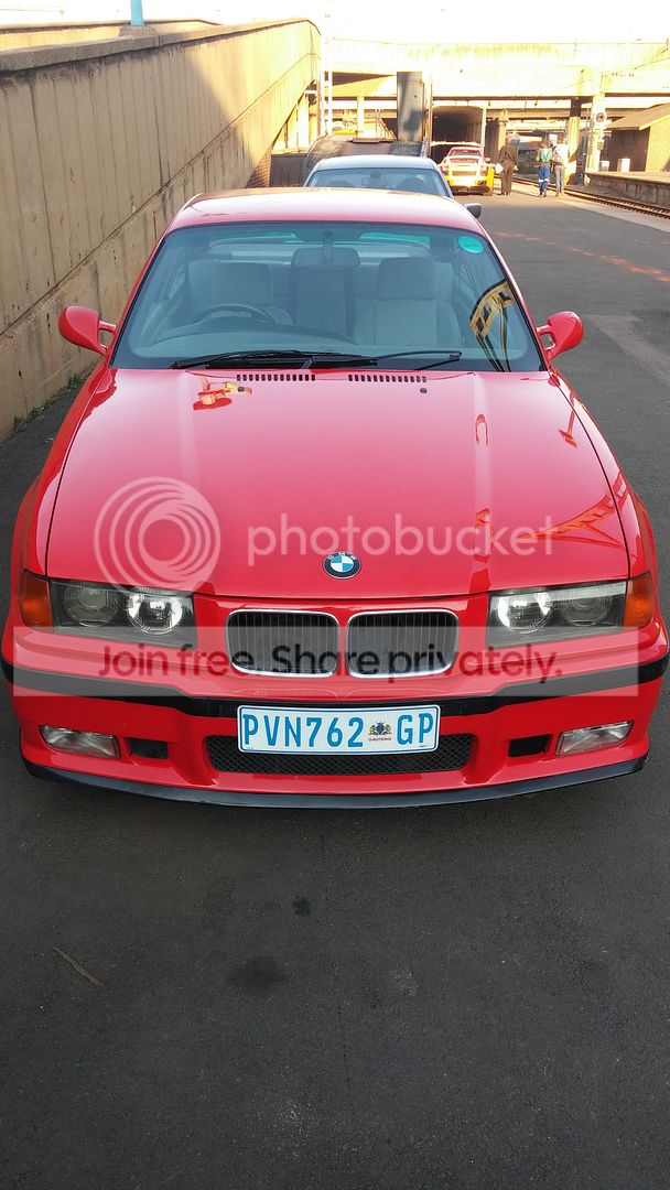

I am back from Joburg with my new purchase 1994 E36 M3 (one of the first 50 "lightweights" like Calypso's) BTW I weighed her and she comes in at 1420 (thats still with spare wheel in ) not sure how that matches up to the normal e36 M3. Anyway weight saving is gone when I get in :yuck:
She is in far far better condition than I had hoped, interior seats are all unmarked and oh how I love that steering wheel, and bar a small scare in Jozie with a fuel like, mechanically she seems fine to.
I will put up popper photos once she has been detailed.
