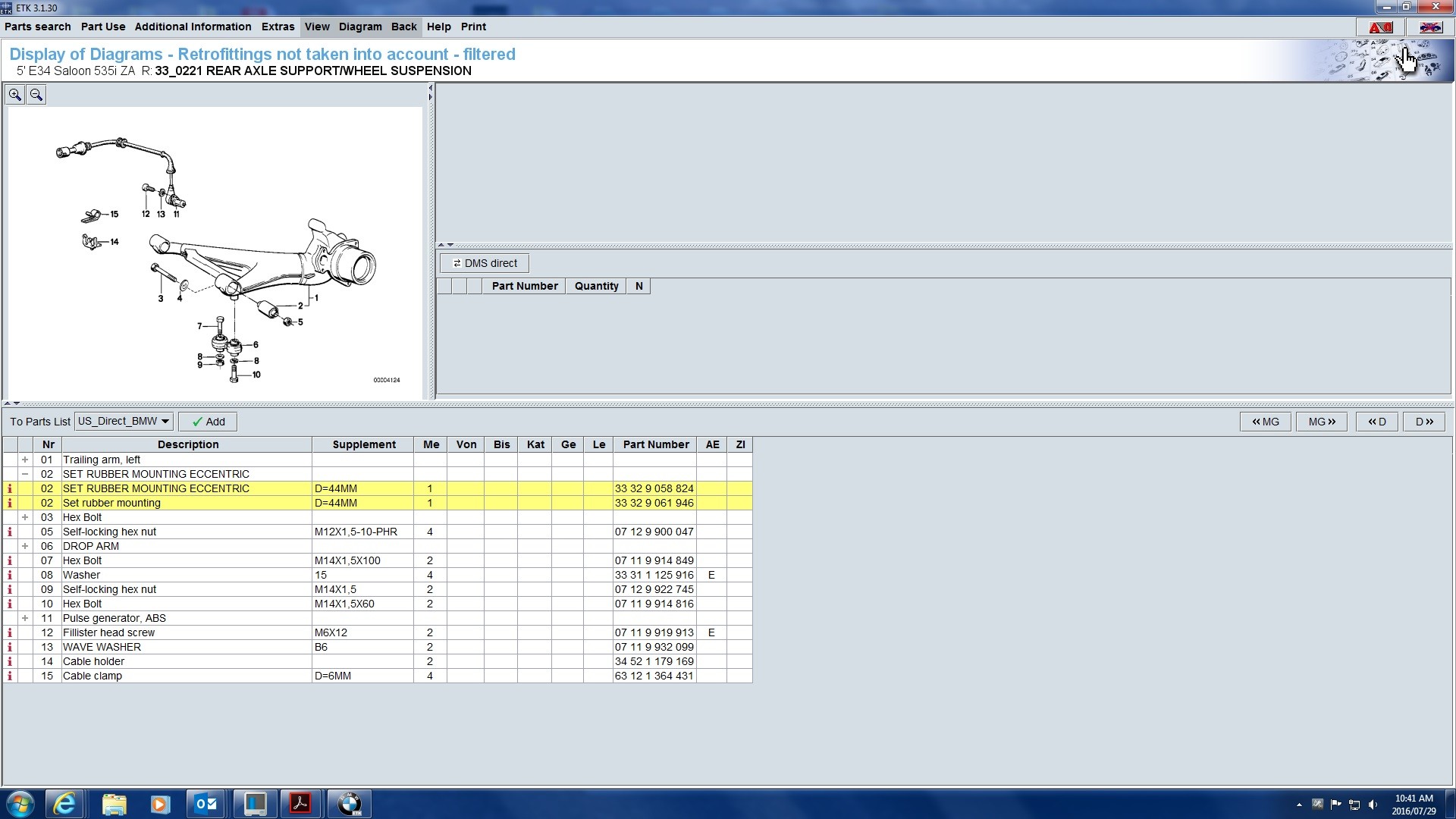

Hi,
have a look at number 2 on your car, they may be worn.
