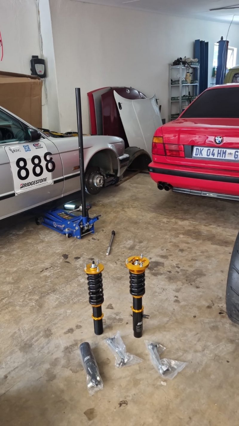

ISC coilovers finally arrived so we can start fitting them - we had to go for the shortest front spring due to space constraints which means the hardest available spring at 12k. The rear is still an 8k spring which I am worried might introduce even more understeer? I know one can adjust the dampers to try find a better balance, but logic dictates that the springs should at least be in a similar ballpark for neutral handling?
With the red M5 sold now, there should be more time and funds available to focus on this car
Benji
There has been criminally little time spent on this car, so we could not make the Time trail in February. Bummer. Made some time this past weekend to fit the ISC coilovers. I must commend Mo from Ultra Racing who has been exceptionally excellent to deal with. He helped me fit the coilovers, and made several trips to me to provide us with an optimal solution. The car "needs" to be very low and there is extremely limited space at the front for the coil spring since we are running a wide wheel and the spring perch needs to be fully above the front tyre. Car sitting suitably low:

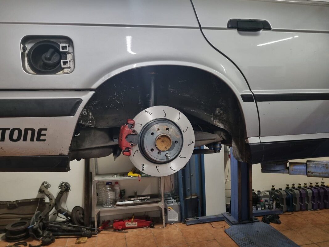

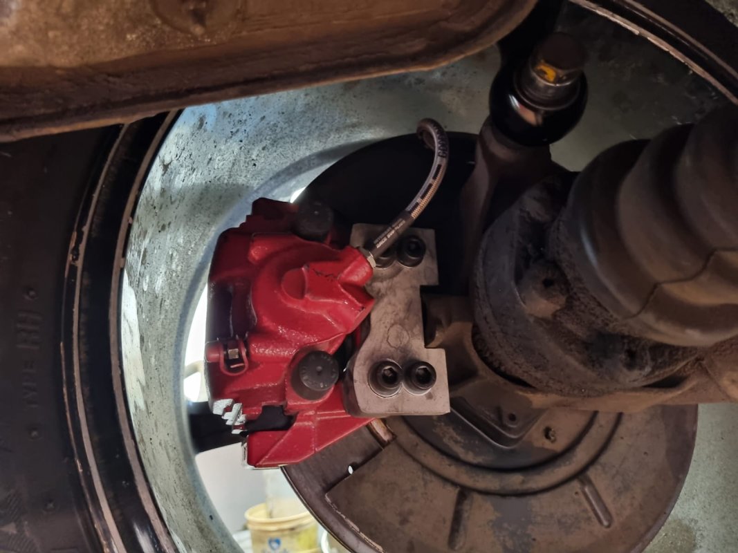

We had way too much forward bias on the brakes as the rear brakes are still stock items and were badly warped and in need of replacement. Locking up under braking really saps your confidence and destroys tyres. We did a few sums, found some "should" and "maybe" forums online, so bit the bullet and bought a set of E46 M3 rear calipers and discs. The disc bolts right up (even the handbrake works) but we had to build a bracket for the caliper. Slap it all on with some new braided hoses, and bob is your uncle.

Why the heavy E46 M3 rear brakes? Mainly, the piston is 2mm larger than the stock M5 calipers, which moves the bias nicely to the rear, but not as much as readily available alternatives such as F30 2-pots etc. The M3 disc also has the aluminium centre hat, which saves a bit of weight (still 1.5 kg heavier per corner) and is easily available. But mostly because we found a set of front and rear calipers with decent but skimmed discs for R2000. As per correct engineering methodology, we bought the parts first, and then did the research to determine if they suit our application after.

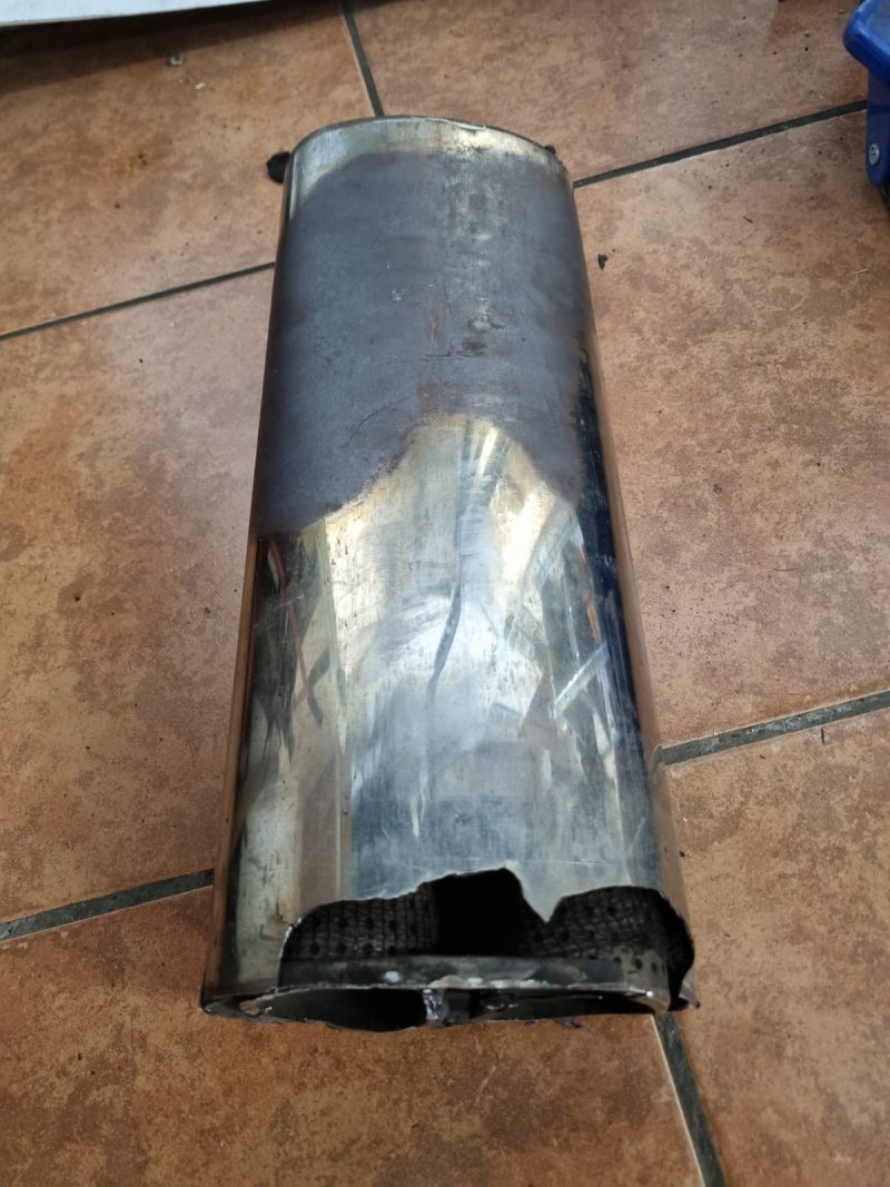

Also replaced the centre silencer/resonator, I have no idea what could do this to a silencer? Maybe some pretty epic backfires...it does like to shoot flames sometimes.

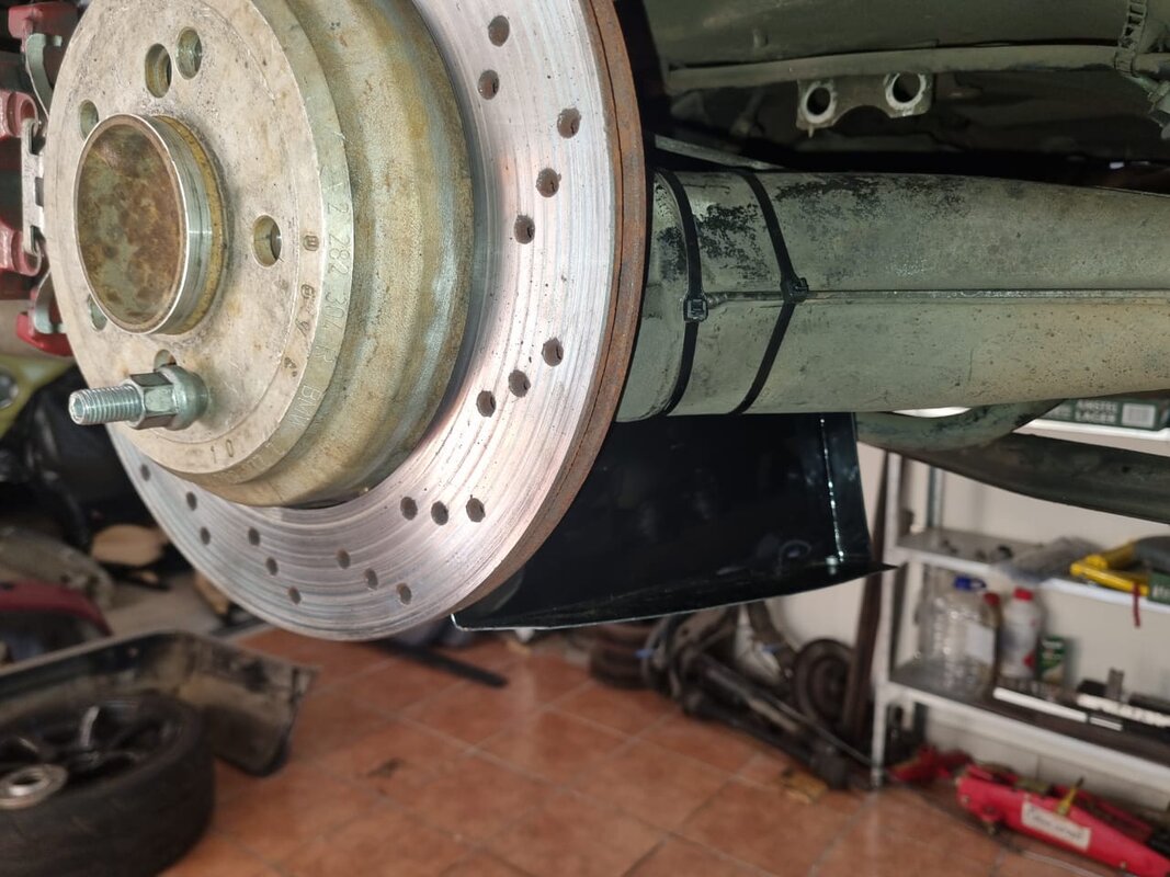

We built some "Porsche inspired" brake cooling scoops. It is hard to say if they work, but rear brake disc temps are now always lower than front brake temps - previously at Zwartkops, they were slightly higher.

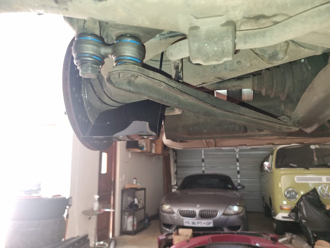

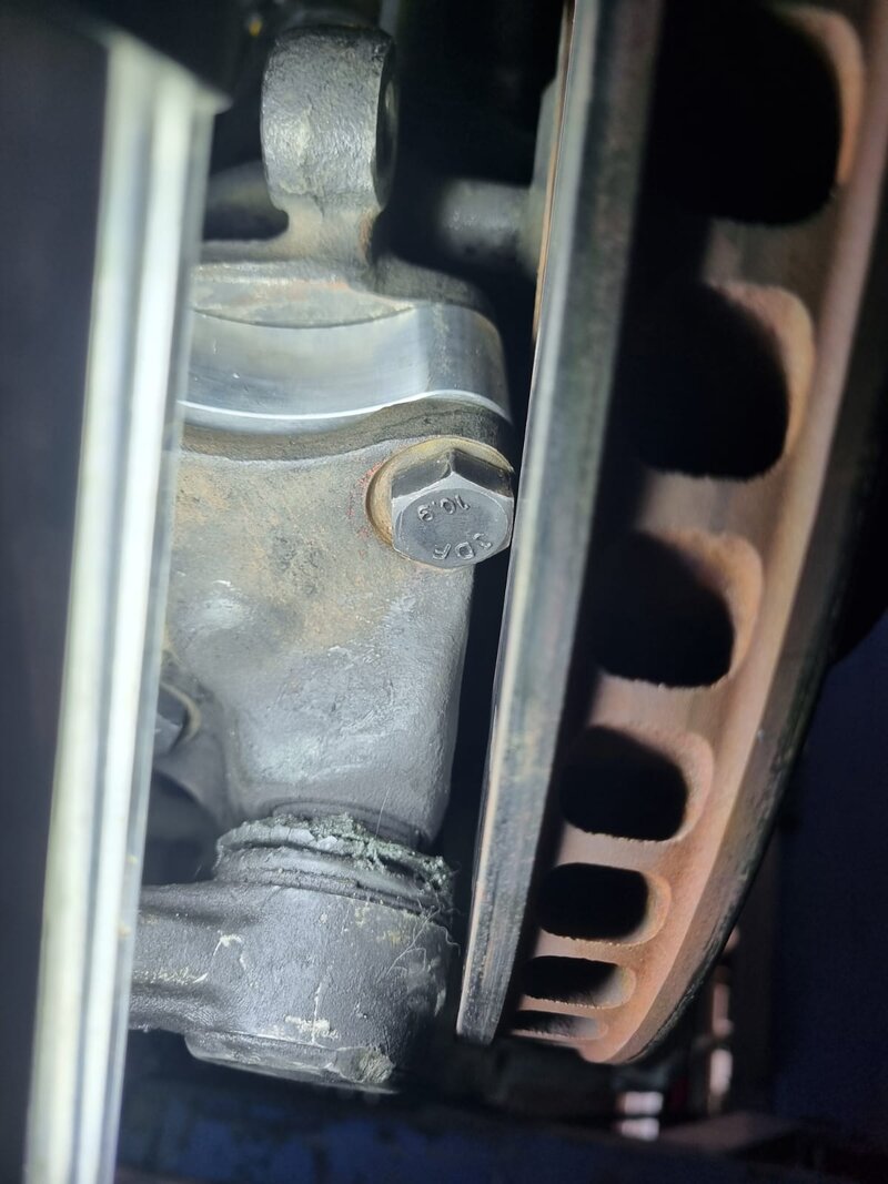

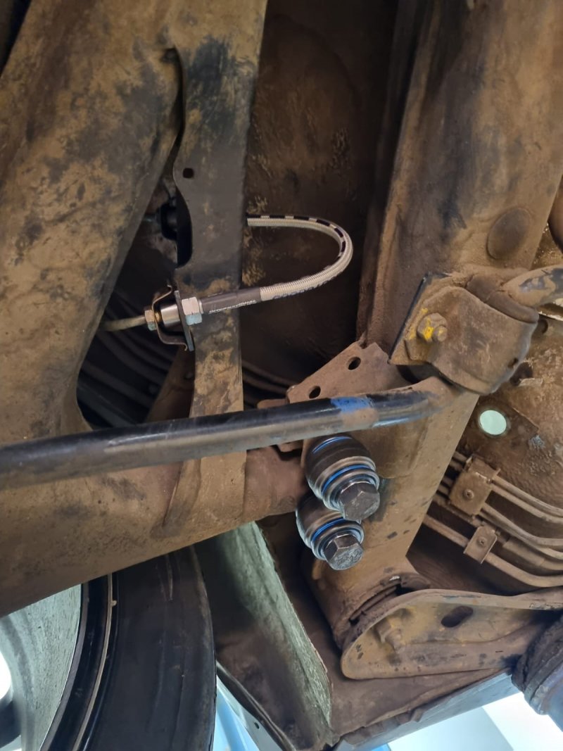

Bump steer correction plates were installed - a ball hair clearance is still clearance... We got new disc bells made to space the disc out 5mm and to distance the soon-to-be-changed lower control arm balljoint from the hot disc.

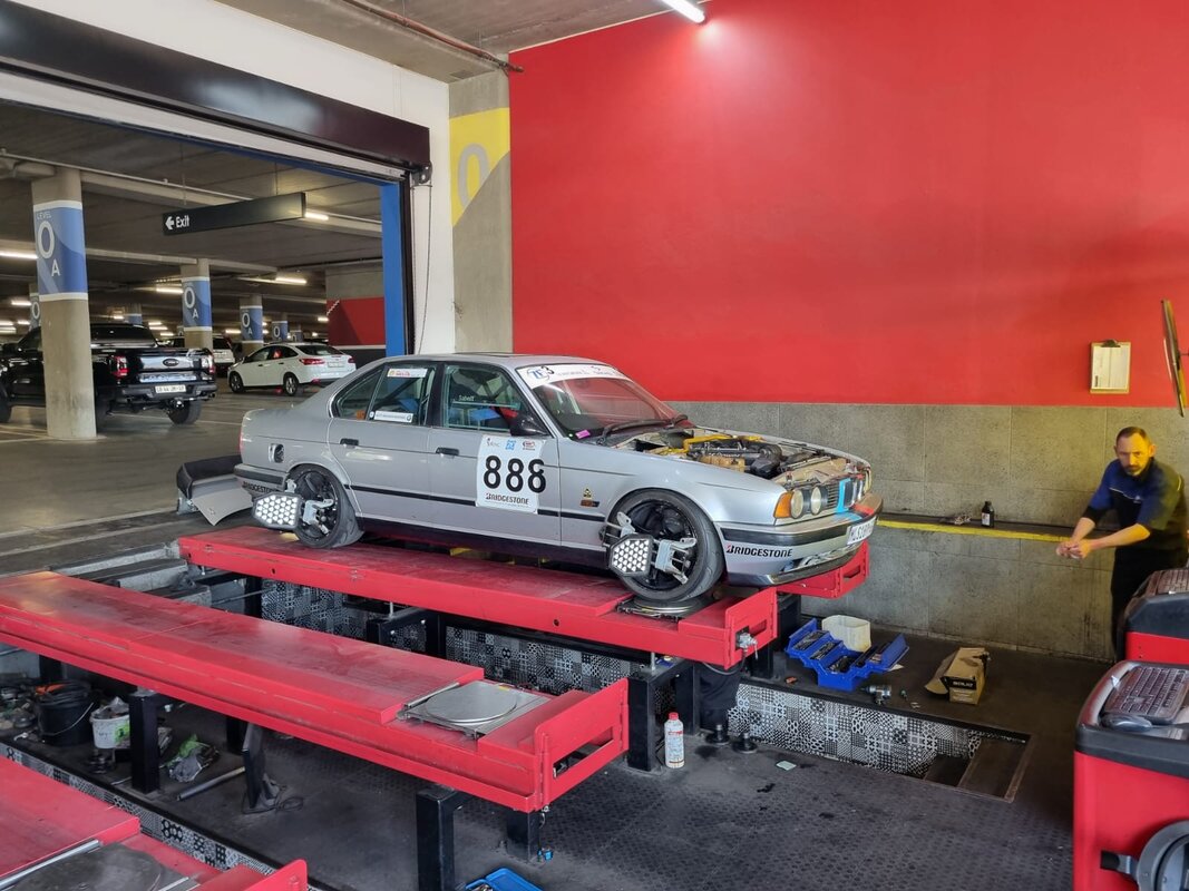

We removed 15kgs from the car by gutting the rear doors, removing the SLS system and ABS pump which was bypassed anyway. This weight loss nicely offsets the weight gain of the muppet behind the steering wheel. Embarrassingly, the car went for its first wheel alignment...the toe was all over the place. We went for a rather conservative front/rear total toe of 0.08/0.27 and camber -3/-1.5. We have plans to get a bit more camber at the front by building an offset bump steer plate... Car drives much better now, there is so much more feel through the steering wheel and it is more communicative before sliding. It is much more obedient on the track which does wonders for your confidence and therefore lap times (hopefully). Previously we were just along for the ride, now we feel like we are actually in control sometimes.

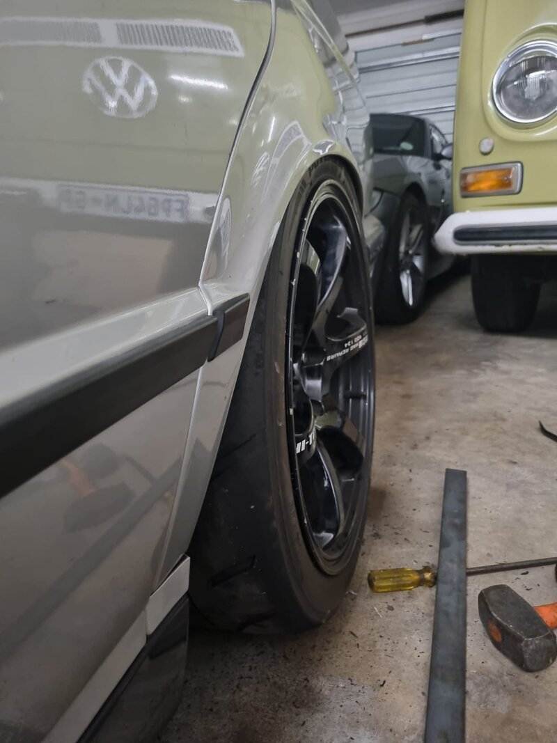

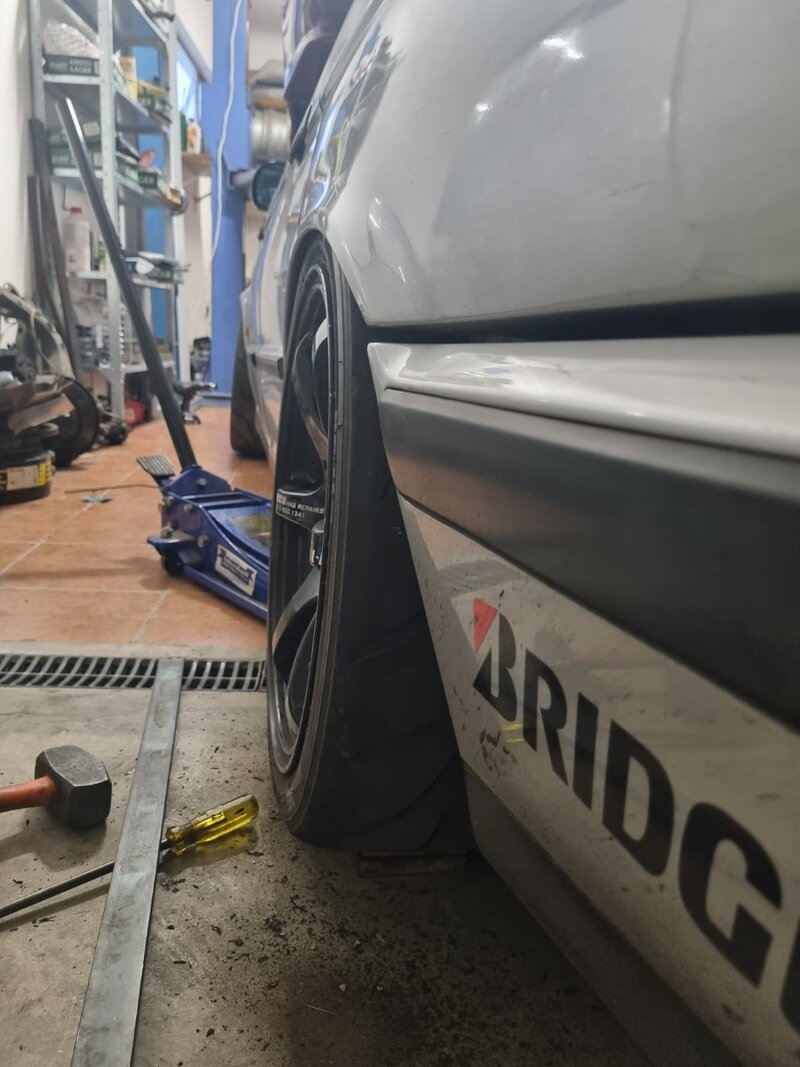

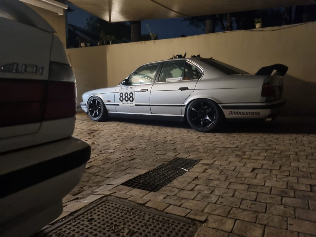

I found some 10mm wheel spacers lying around...so did the right thing and pulled out the 4 pound hammer, some heavy steel and a crowbar for a spot of light massaging. There may or not be rubbing, but it looks fu#king awesome! Doubt there will be any performance benefit, but at least the Stance guys will approve.

M3boi
Pity you can't get these wheels anymore, they look fantastic.
Do you know what the specs on them are?
Benji
They are also really heavy...They are 9.5J square setup running 265/35/18, but completely the wrong offset - et35 iirc, hence the need for some substantial spacers
