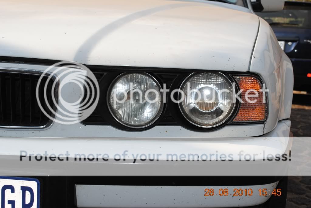

Net result is this

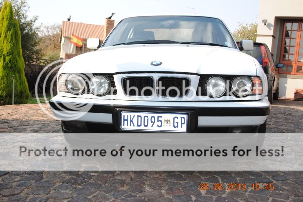

This DIY is kinda short, I will do this all again when I strip off the nose to realign it from a bad panel job, which is why the lights dont sit perfectly and I have that stupid line betweent he bonnet and the grill, but dont stress.... we will get it right
