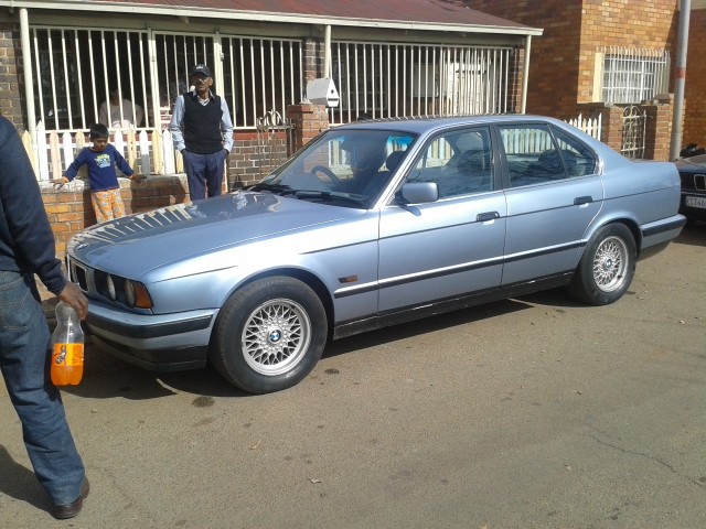

Morning team,
i drive a bmw e34 525i 1995 model. my car has oil leak(engine oil).
i really need your advise,where to check? i have replaced tappet cover gasket but still...

hi boss thanks a lot i don't have any oil leak, firstly i had to clean engine and i drove around then i sported an oil leak a clean leak it was coming from oil filter housing.i got one from spares shops,but i decided fixed everything....
valve cover gasket
oil sump gasket
oil filter hoising
o ring on the dipstick tube
no more oil leaks in my car bmw 525i
