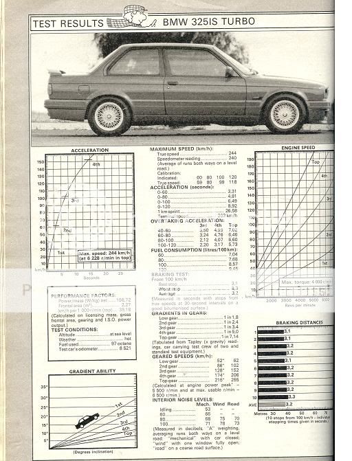

Hey, this is my post for the E30 club
Some of my archived documents

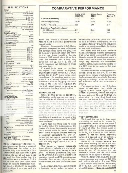

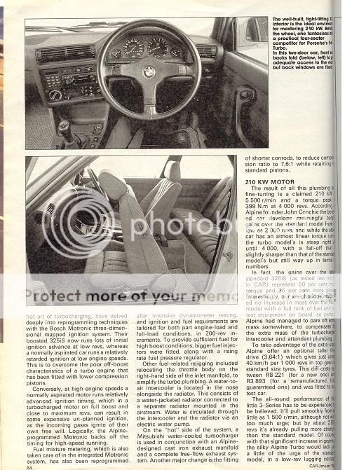

continued

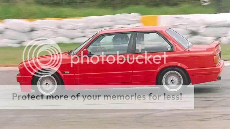

Some of my most beloved E30's :cry: , thought I'd share since I've just dived into my photobucket account in ages
Around the track

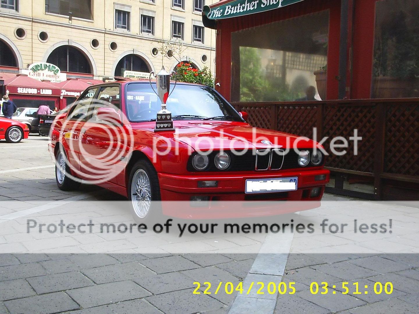

and my last E30 :cry:

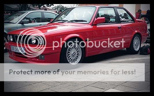

and the last one I've owned
