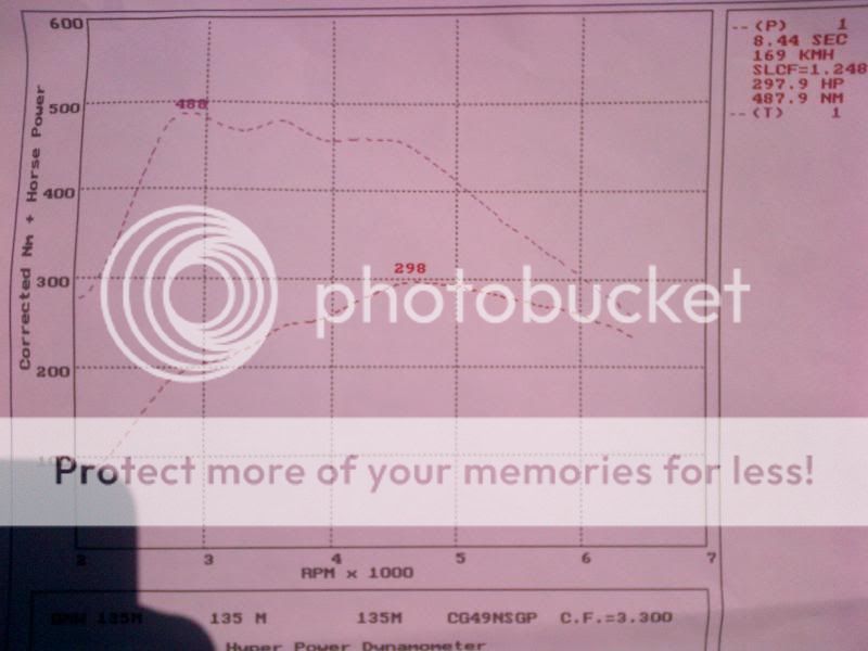

ok so i took my car to Motronix near gold reef and here is what the dyno said:
the car was a little hot as, as soon as i got there we put it on the dyno straight away, i know you have to let the car cool for at least 20 minutes then give it a go, but tell me what you guys think. and this is at the wheels.
sorry we never had time to do a stock vs Plug and play system.
so we looking at about 220kw on the wheels and 488nm
Thoughts?
Showing some good power the mate

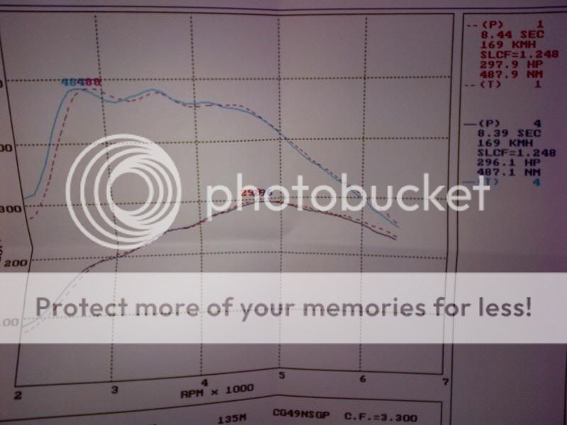

Ok So here is dyno nummber 2 with the PSI set to +5 on the JB4, looks like the setting i had before actually worked out slighlty better.
Mo said that is could be that with the stage 1 i have reached the max power output as the exhaust is limiting me, so he suggested downpipe but thats not going to happen cause of warrenty.
Burger tunning say that i should go with stage 2 as that will plug into a lot more features...

Yep...too much boost for the car to handle with no other supporting mods.

Those are good figures on Motronix dyno. It's known to be a bit stingy I guarantee on KAR dyno you will see better figures. :thumbs:
St Lunatic
ha ha he said th same thing lol, but would rather go on a stingy dyno than an over eager dyno lol
