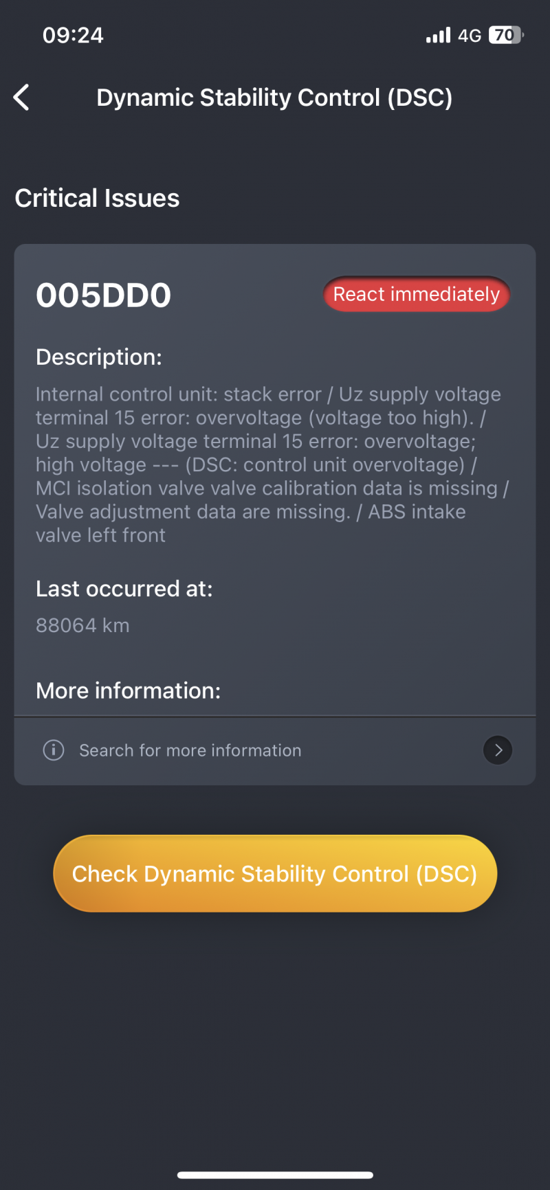

Thanks Bugger, I have Carly as well. Attached a pic of the error from Carly. Anyone seen this before?IMG_0438.png

So depending on where you look, you seem to get a variety of different answers as to what the issue is. Glad you have Carly though, that has saved me on more than one occasion.
It seems, at a quick glance, that it has to do with calibrations, something that seems to be only available by using ISTA. You, unfortunately, own one of the most temperamental cars ever made by BMW (hand up here for sitting for hours diagnosing faults on both my E63 M6s). So if the necessary parts have been replaced, as per the two workshops you've used, perhaps they haven't run a calibration on the system correctly. If you're in with someone at one of the dealerships, Claremont, SMG etc., the techs could spot you a favour and run a calibration for you. Shouldn't take too long I'd estimate.
Before throwing MORE money at parts and labour, try that avenue first. DM me if you want more help. Bloody S85 engined BMWs were my unfortunate forte at one point 🙈
