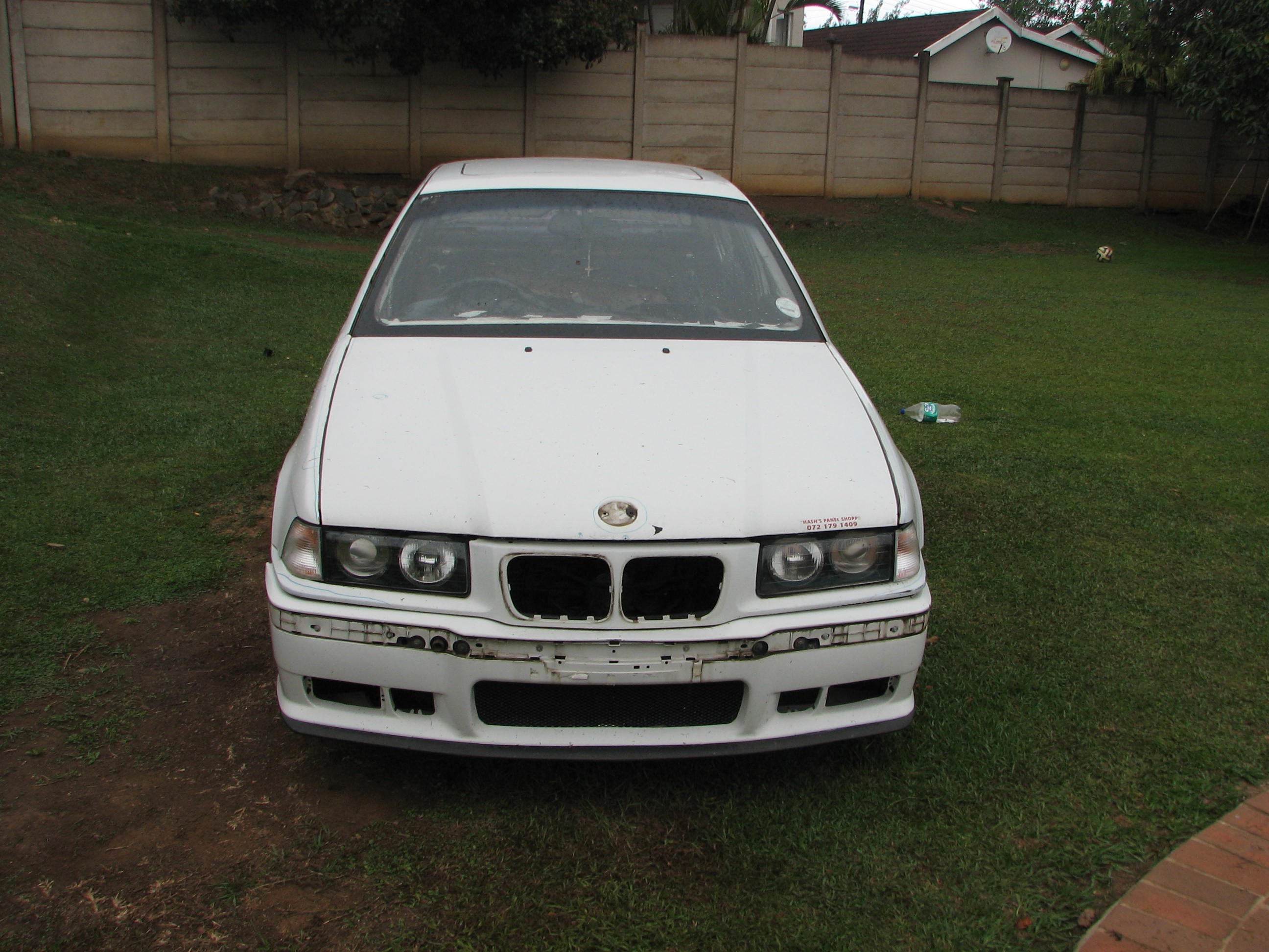

so my E36 was due for some minor touch ups as the paint had been burnt through when the previous owner tried to polish it but the touch ups turned into a full respray.
i bought it over from him after he got tired of it.
it is a E36 Alpine White 2, obd2, 328i motor sport according to the log book and is currently sitting on 231xxx km. i done a vin check and it is what the logbook says. not a 316i with a 328i engine.

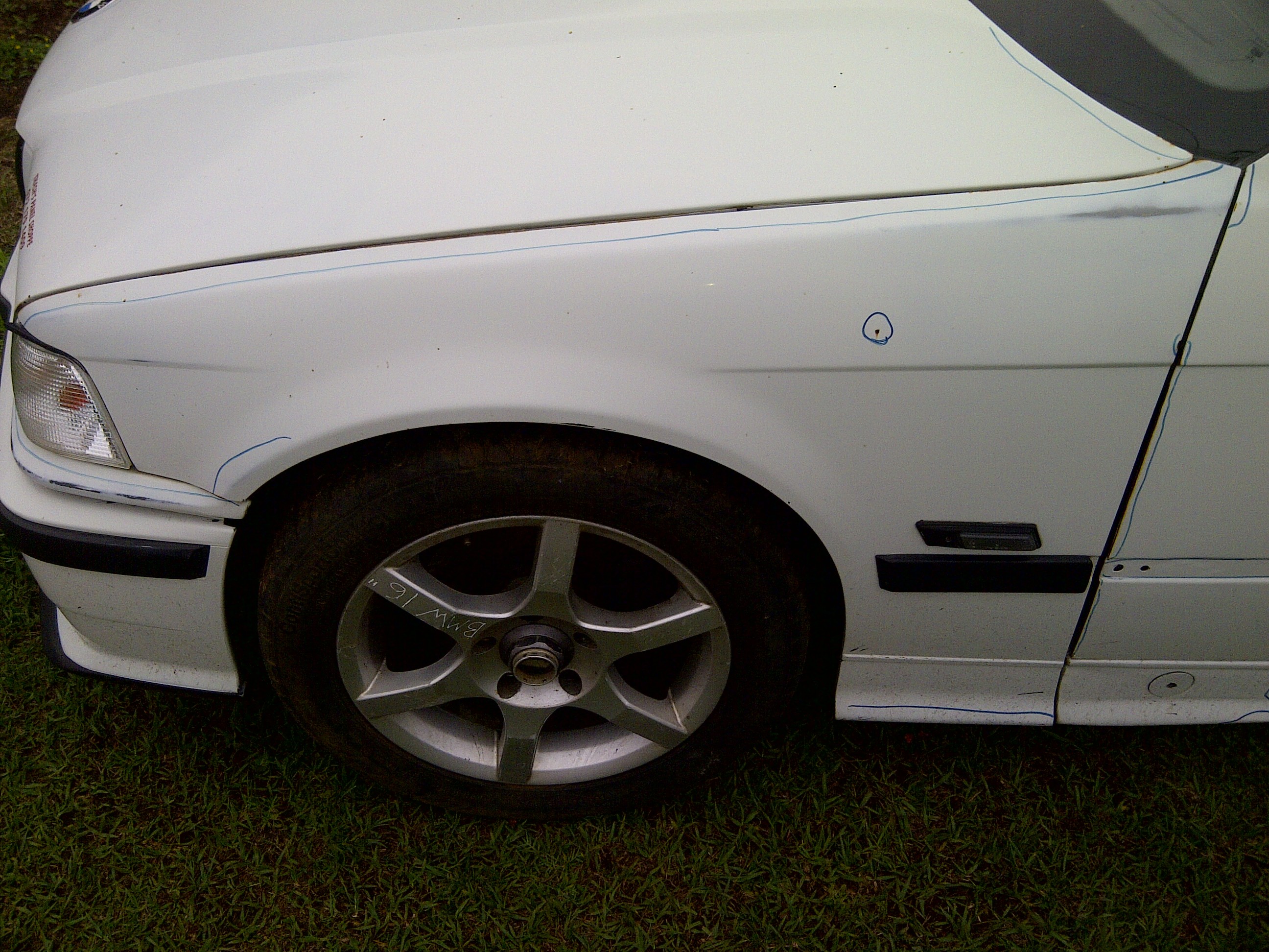

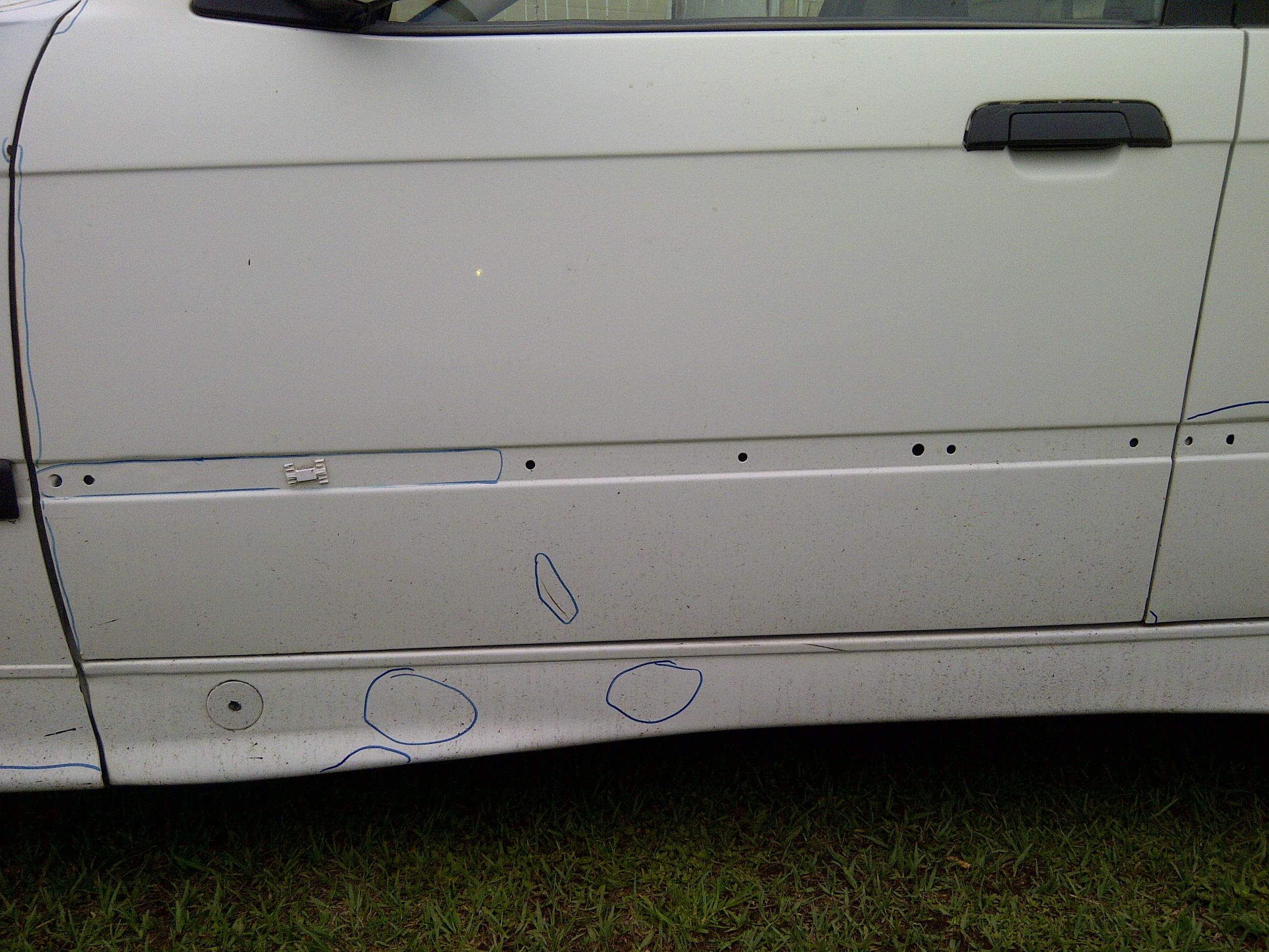

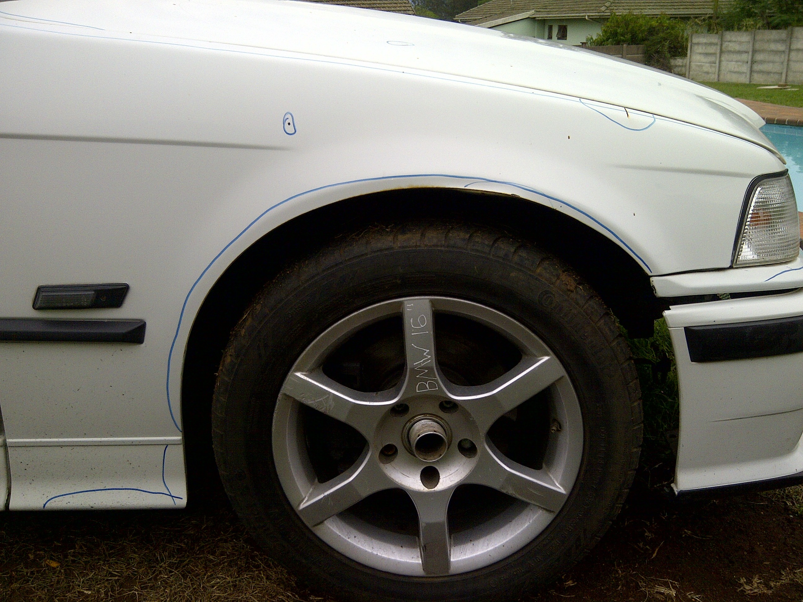

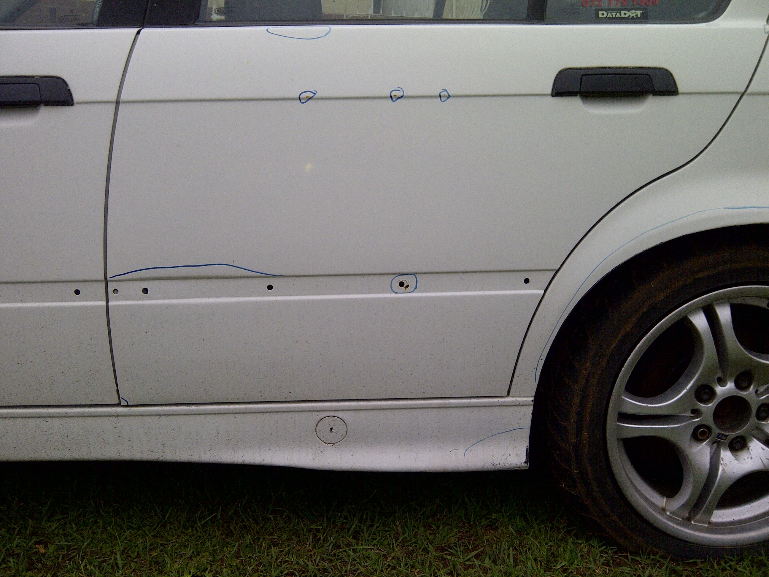

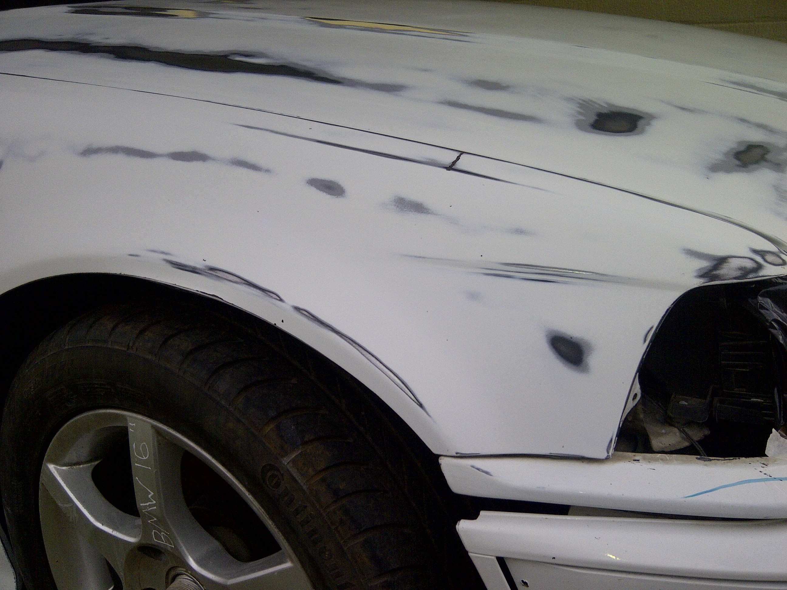

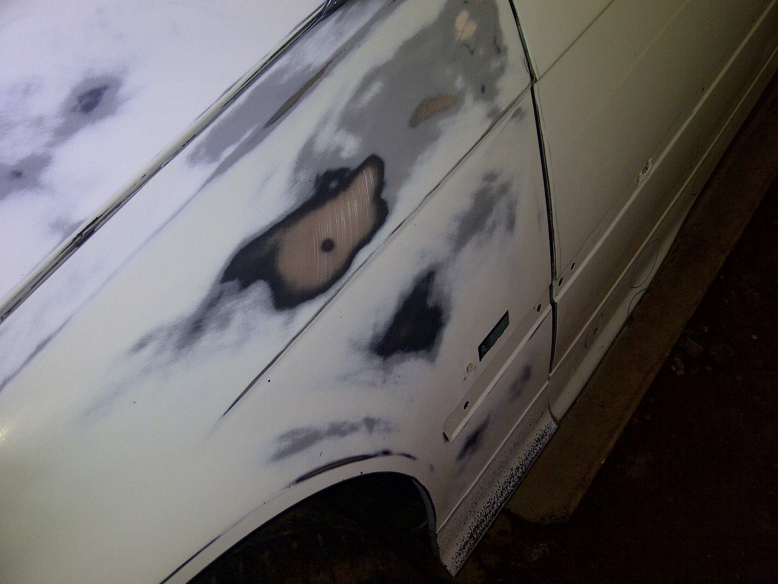

first step was to determine how much of the car needed painting so i had a look around the vehicle to see if i could pick up any high or low spots with my eye and i picked up quite a few and circled them with a marker so that i have a visual to work with.

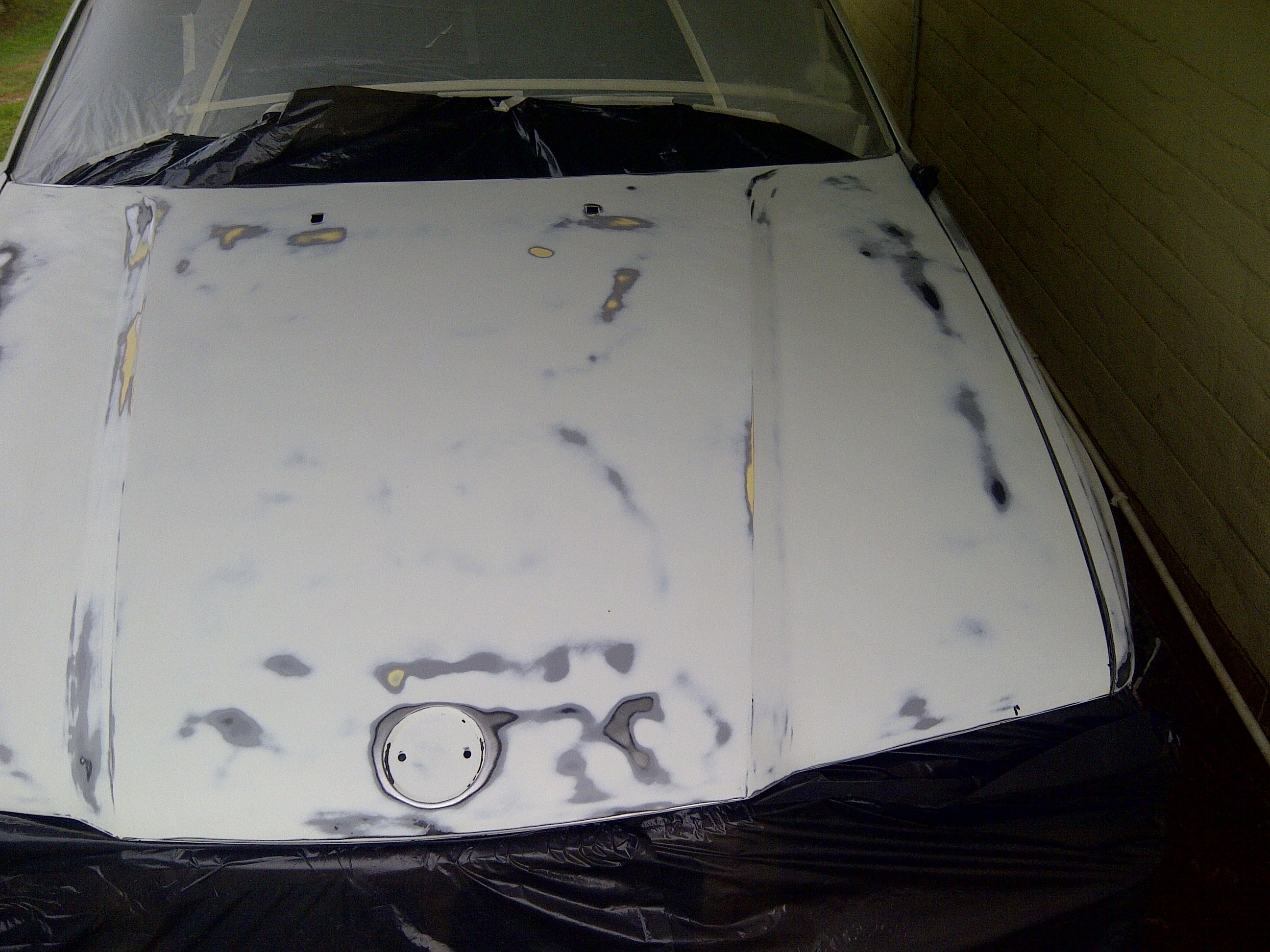

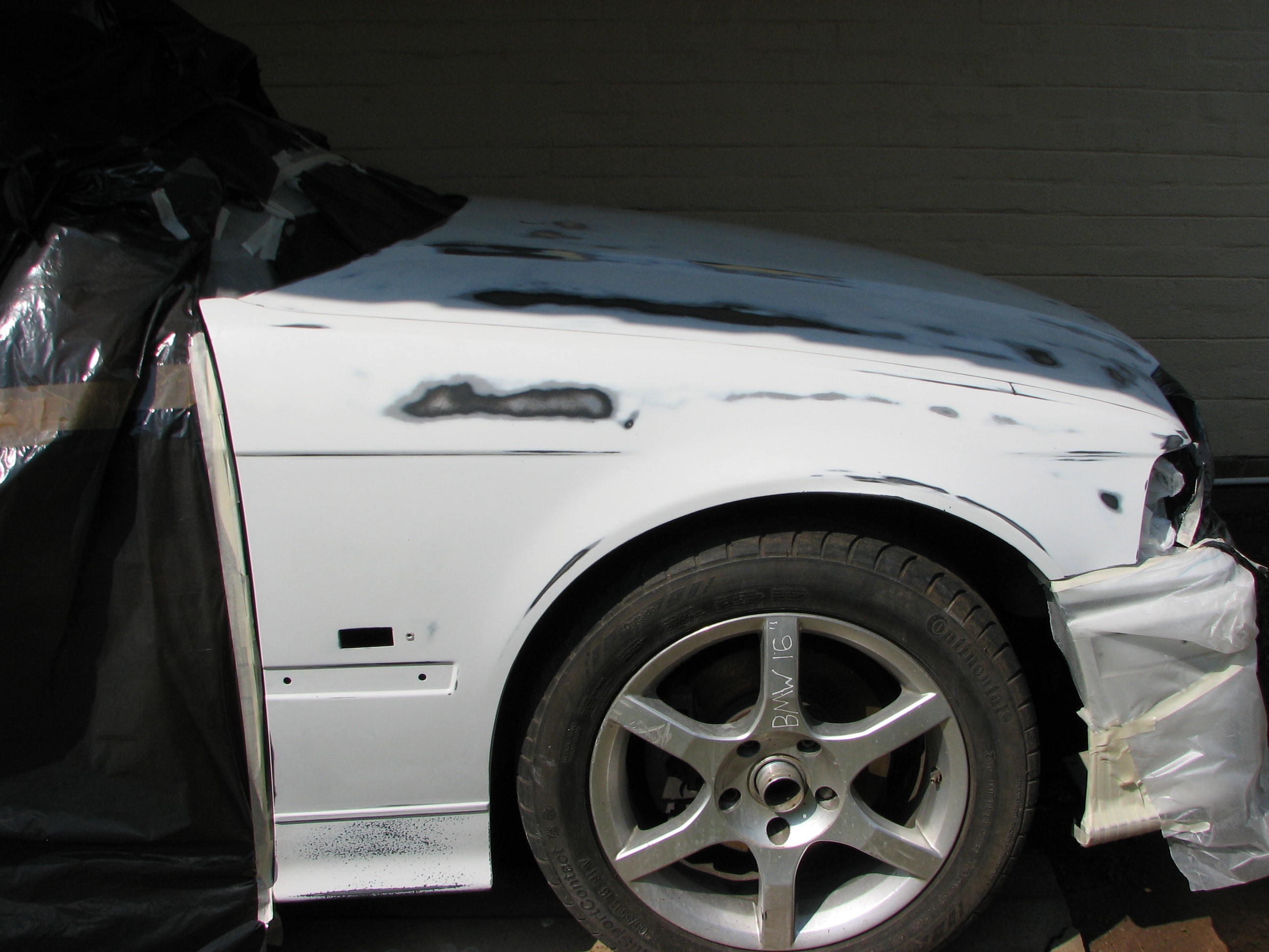

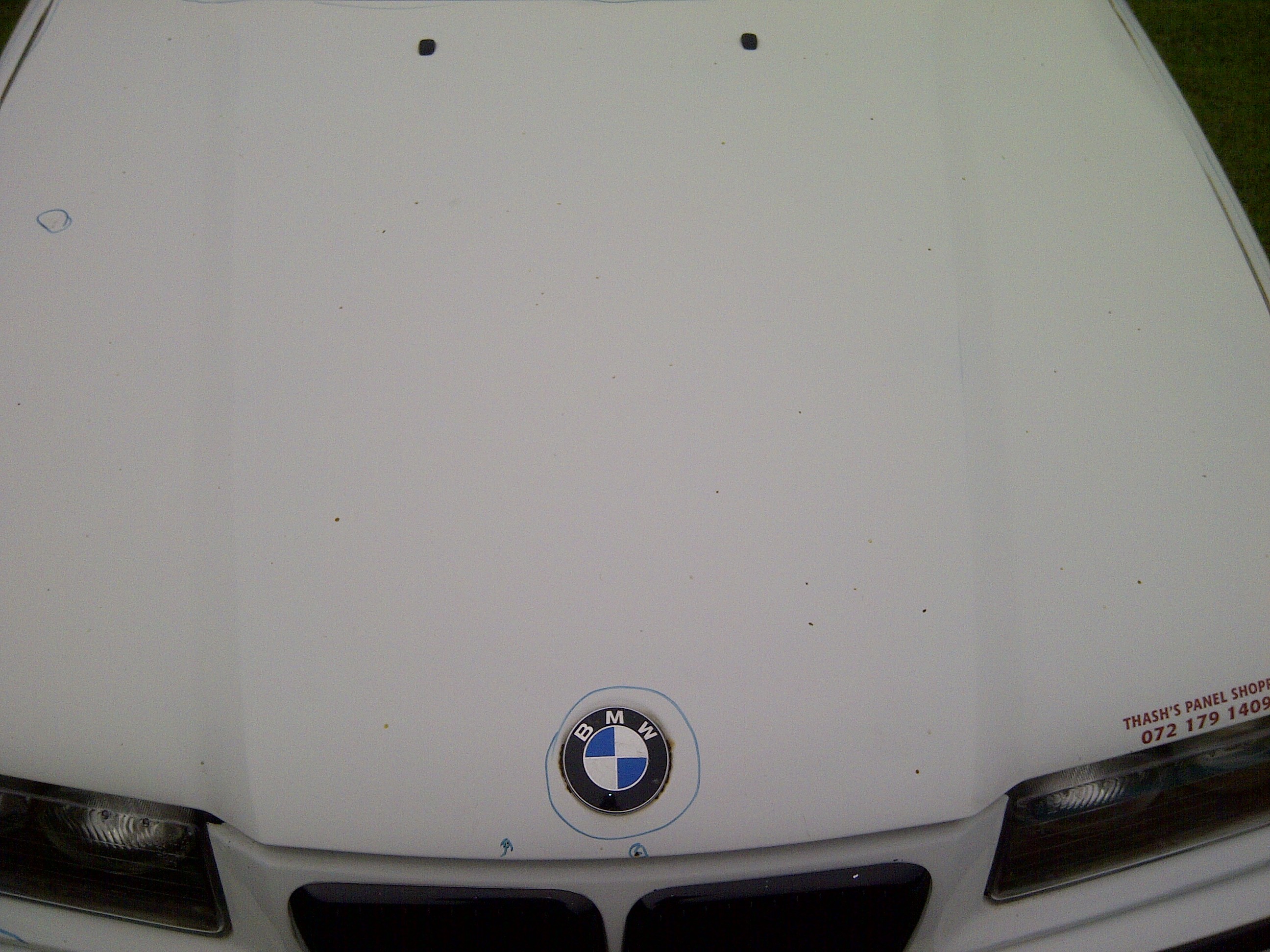

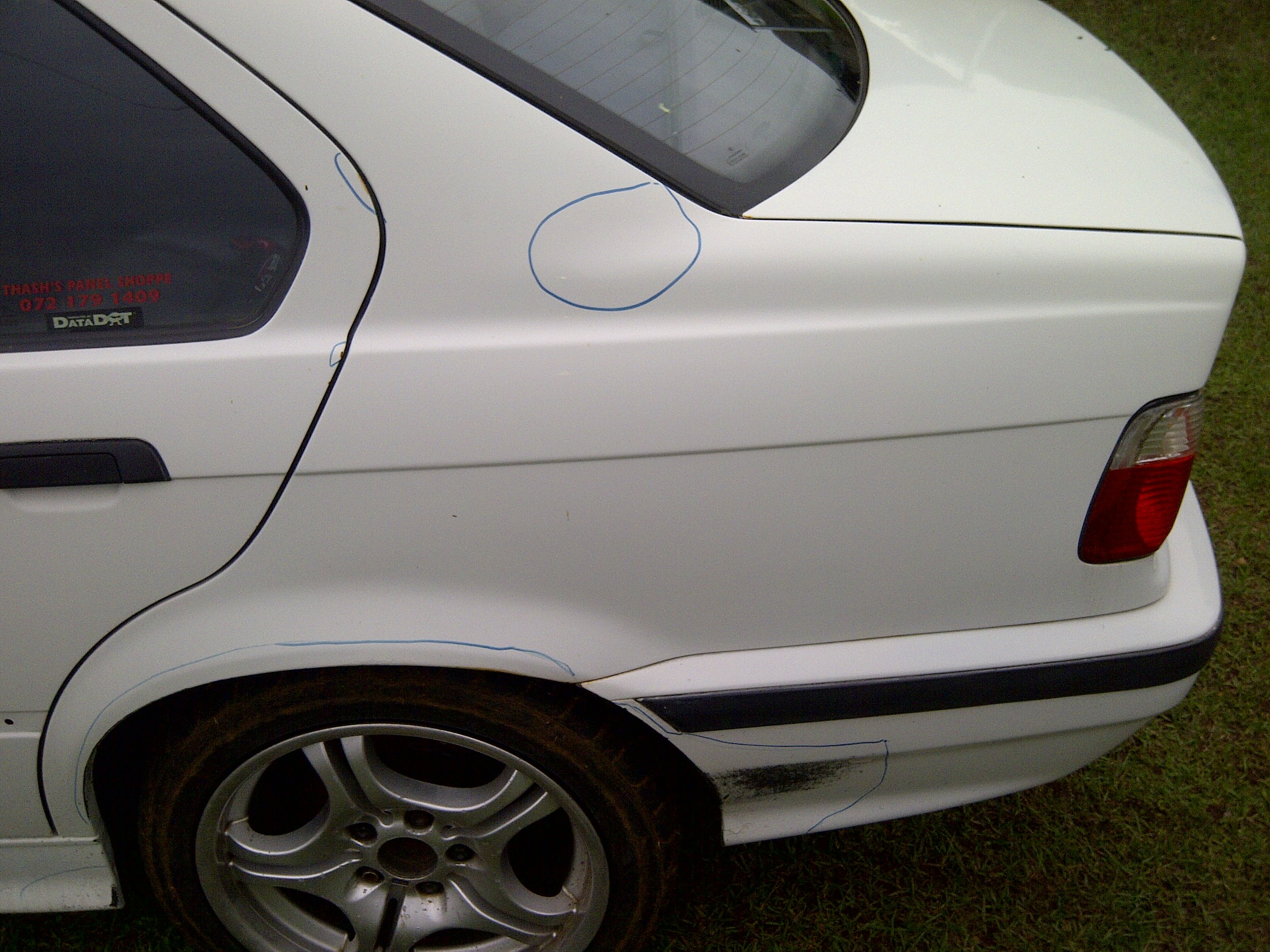

now the exciting part. from what i have learnt and researched the block sanding is the most important part in achieving a "glass like finish". my plan is as follows. my body is fairly straight with a few high and low spots. i starting off with 80 grit in the areas that have metal showing and apply body filler and level.
once those spots are sorted out, rub the whole body down with 180 apply primer wait for it to flash and apply guide coat. once i have flattened it with 180, where there is still guide coat i know i have low spots and where there is not i have high spots. i will either sand until the flat spot has been removed or fill it and repeat the process. once i am happy that the whole car is flat i will then move onto 220 and repeat the whole process, then 360 and repeat the whole process, then 600 and repeat the whole process. once i am satisfied that it is flat with 600 i will then do my final prime and mask it off for paint.
