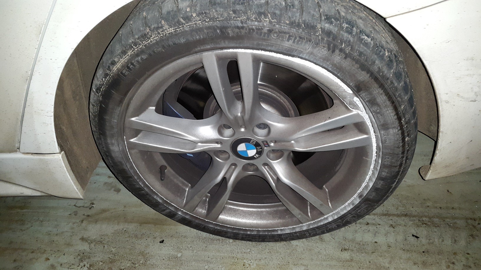

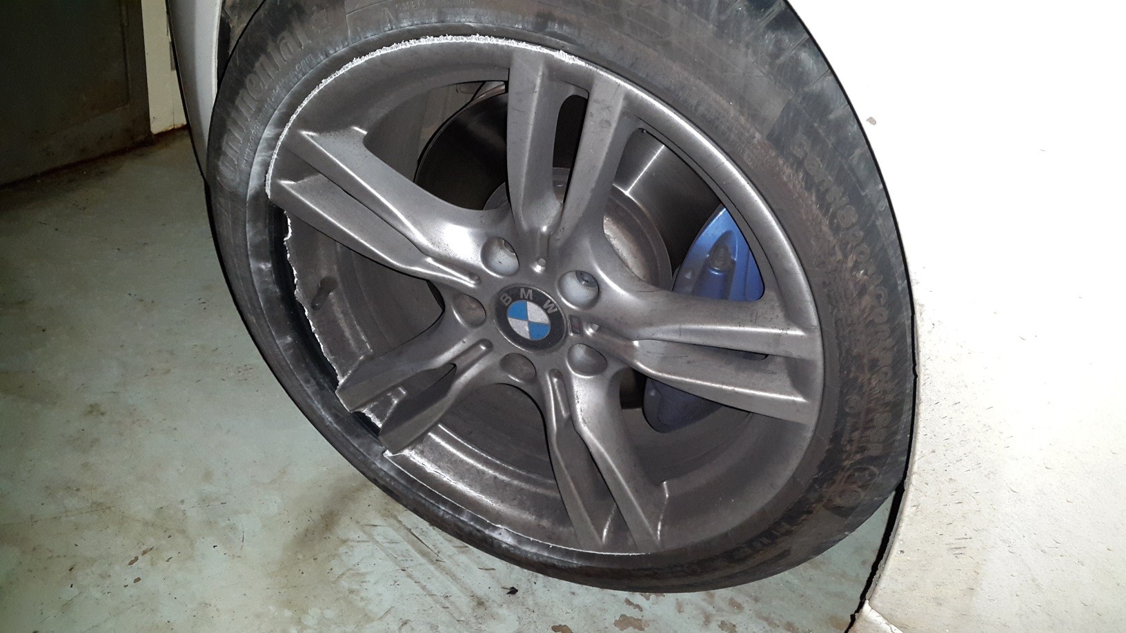

See in this pic, from where the marks on the road starts, seems like there was something lying in the road, that could also have damaged your tire. (almost rectangular mark on the road surface, right in the bend)
My 2 cents, If the tyre came off the rim prior to hitting the pavement, we would have clearly been able to see the two scraping lines of the rim sides on the road.
Would just like to point something out in regard to the picture of the road surface and the picture of the rim.
If the scrape marks on the road were the result of the rim scraping on the road "when the tyre came off the rim" then the outer circumference of the rim would be scored all the way around. It isn't.
PS: BELOW I REFER TO ARROWS - I cant upload the image I worked on as it keep saying "image file missing"
Secondly, the scrape marks on the road (red arrows) that appear to run perpendicular to the long sweeping mark (between the blue arrows) could easily be caused by small stones being "scrubbed" under a tyre which is slipping in understeer across the tar. The "scrubbing" is what is seen in the long arc between the blue arrows.
There are other arcing marks on the road surface which I don't think have anything to do with this accident.
OP has not advised when these photos were taken. Next morning? A day or 2 later? I suspect late the next morning / early afternoon based on the shadows (or lack thereof off the pavement and the also from the tree in the background. I can't get down to road surface on Google Maps to confirm this so it is pure speculation on my part.
Not if he was hitting the brakes, or the ABS and EBD unit was braking the wheel in order to try and restore control, then the rim would not be rotating and thus be bouncing along the roadway, causing the marks in question.
Like I stated before...the tyre might not have left the rim, but merely pulled so far to the side, that the rim contacted the roadway.
Afterwards, especially cause its runflat tyres, the firewall and the design of the tyre would cause the tyre to go back to the position it was in on the rim.
Look... ALLOT can be speculated as to what happened, but again I say, I was not on the scene, I am merely going by my 23 years experience.

from the marks in the road it actually looks like the rim caught the road, tyre was deflated before it hit the curb. But with that said, that is the norm with normal tyres not runflats. With the front end giving away, it could be either a flat tyre or loose debris on the road but would not have made those type of marks.
WIDEOPN-X5
Guys look at the rim. It is not possible to lock the rim in one position; ABS precludes this.
If the tyre was deflated to the extent that the rim was in contact with the road surface then there would be scoring around the circumference of the rim and there would be a clearly defined score mark on the road. The rim isn't scored and there's no score mark on the road leading to the curb.
I can't load the photo I have worked on to illustrate what I am saying. Very frustrating :RedNo:

My rim looked exactly like that. Once I hit the curb (those square high ones), the lower arm control snapped, and the wheel did not roll, but was sliding, I managed to get the car stopped, so it didn't travel far.
My tire never came off the rim. The tire at that point sort of covered around the edge of the rim, as the tire was completely deflated. Tire had a hole in.
Just stating what happened in my case, not implying anything.

Hi,
I did not swerve, none of the warning lights even came on, no stability control nothing! And the worst part was I hit the curb with the front wheels first.
My understanding is that if you accelerate to hard with a read wheel drive car that the backend comes out... id did not. I lost grip and hit the curb.
Only damage is to the rear and the mags. full quote for repairs adds up to about R50k.

Accidents happen all the time, but impact is what is the most telling. No way you could destroy rims like that at low speed. That shows a high impact, hence the damage.
I hope you come right with the ombudsman with regards to the claim, but this was definitely a high speed impact.
