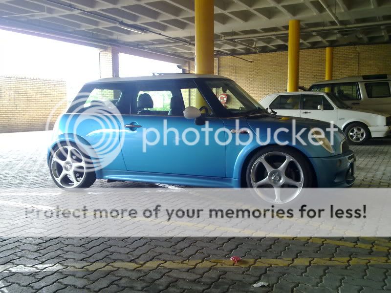

I had a 2002 S and loved it bits. I would like to build another one like below as a toy.
Mods I would suggest. (Had on mine)
Xflow 4-1 Branch and straight pipe to the stock rear boxes. (Changing the entire system makes the car very loud. This setup we found works the best as we tried about 7 variations of systems.
19% Alta Reduction Pulley
2% Alta Crank Pulley
JCW Injectors
BMC Carbon Intake
GRS Intercooler with Alta Couplers (Top Mount)
Detriot Tuned Bypass Valve
Van der Linder Cam
Xcede Tuned
Here is a pic of my ex-baby.
