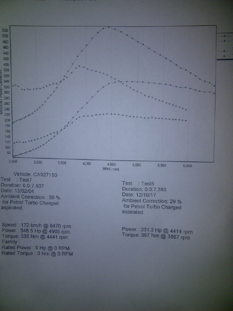

Made 346.5hp, which is 258.4KW on the wheels, in ridiculous 35deg ambients at KAR.
We did the K04 in 1 day, and took it straight to the dyno. Car has The following mods:
- K04
- Intake
- Downpipe
- Custom Xcede software (not production file, this file is out of production)
That's it. No cooler, no meth, no exhaust nothing. The fuel in the car was 95RON from Engen. No racefuel, no NF.
Very happy with 1st time results in the heat. It's up there with, if not the best, K04 Tsi dyno up here if I'm correct. We hoping to get this car to over 270kw or 365hp & I'm pretty sure that's might will be achieved.
