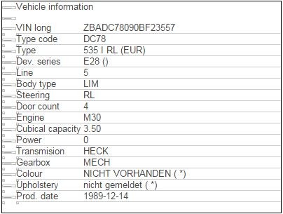

VivP
My old E34 535i (1989/12) was also vin'ed as an E28. The local agents (Continental Cars) were just as confused as everybody else, and eventually told me that it was an "internal error".
The E28 production ended 1987/12, except in SA where a "Limited Edition" model continued to end-1988. As mine was a 1989/12, the VIN was obviously incorrect.
