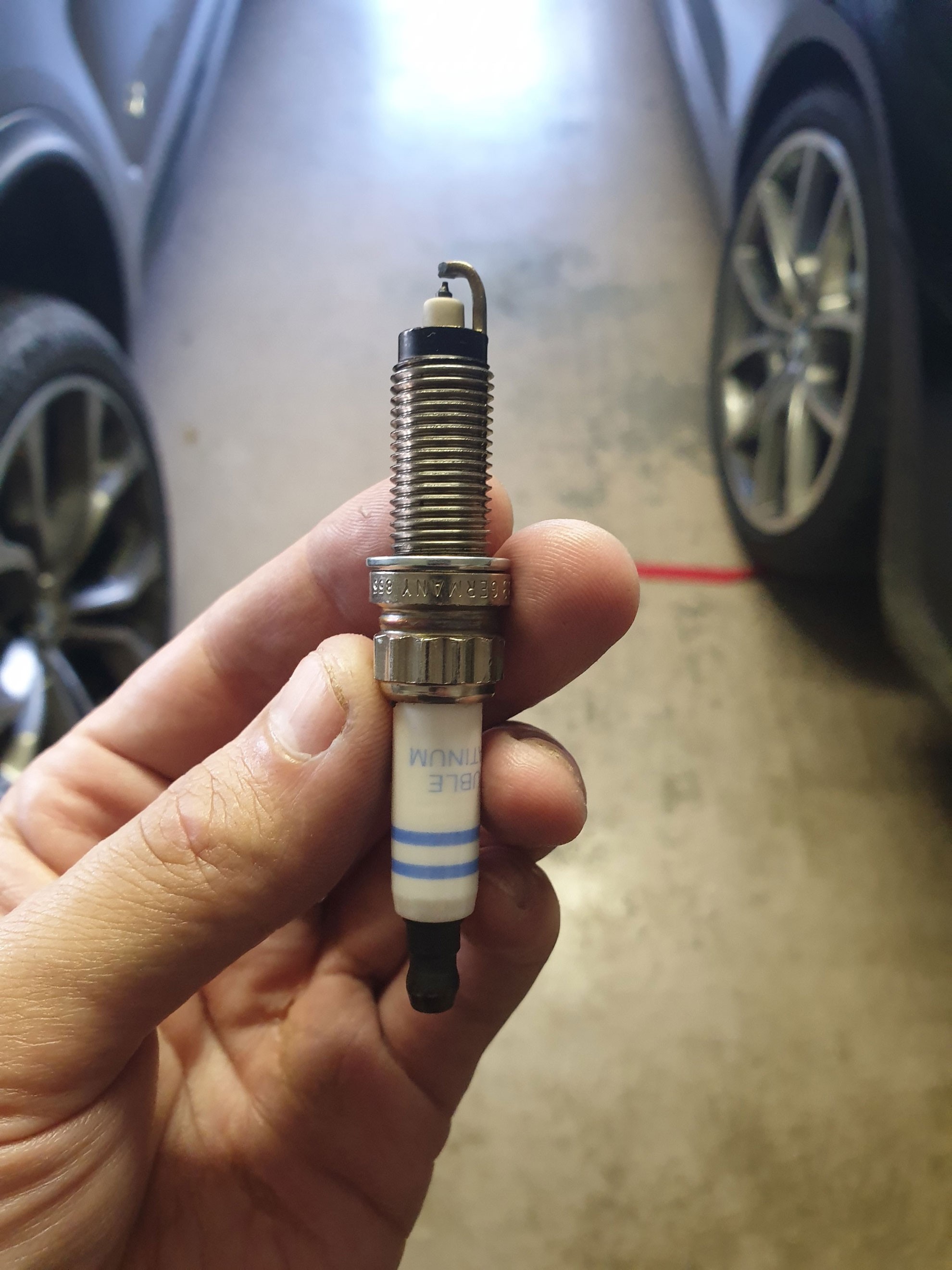

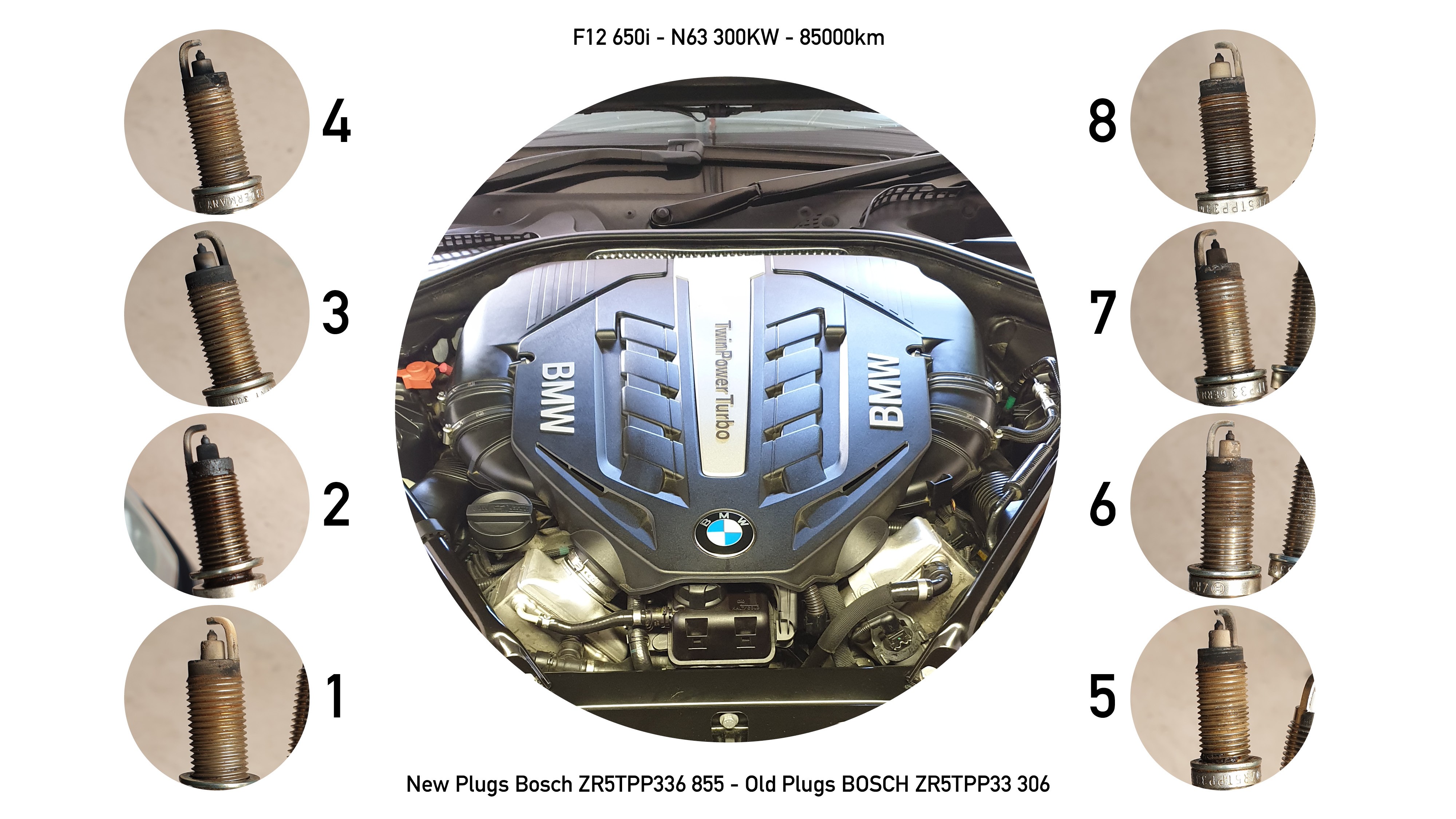

Finally received the socket required to change the plugs on the 6er. Did it this morning, and it was a fairly quick and painless job. Old plugs don't look great, and right after I put everything back together took the car for a drive and had a misfire on cylinder 8. Now, my car has been having some random misfire issues which is why I decided to swap out the plugs and coils. Only injectors left to check (will use an endoscope to check the index numbers). ISTA did also report that the fuel pressure on bank one did not pass the diagnostic test, but the cylinder specific tests did not show any issues with the injectors :confused2
Anyway, photo of the old plugs below. Viewer link for full resolution: https://ibb.co/QKF3NGy
Grateful for any feedback.
