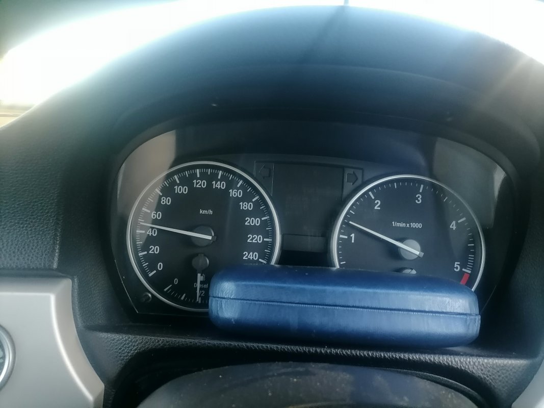

Hi. I have a problem with e90 320d. I drove car to work and it just cut out completely total shut down. Before car would when I want to open alarm will ho off but unable to open with remote also everything dead. Attached is image where guages stuck while everything shut down please help

I have a problem with e90 320d. I drove car to work and it just cut out completely. total shut down.
Before, when I want to open car, alarm will Go off but unable to open with remote as everything is dead.
Attached is image where gauges are stuck while everything shut down.
please help

I wonder if it not a FRM module problem. I would call Gert at OBDWorx in Benoni for advice. E90's are prone to have the FRM breaking down.
Abd21
Eish man I had the FRM done last year and ever since that time car has given these problems you know after the FRM was worked on. Didn't have indicator lights ect not working. So if this could be possible problem than I have to then replace the CAS unit
