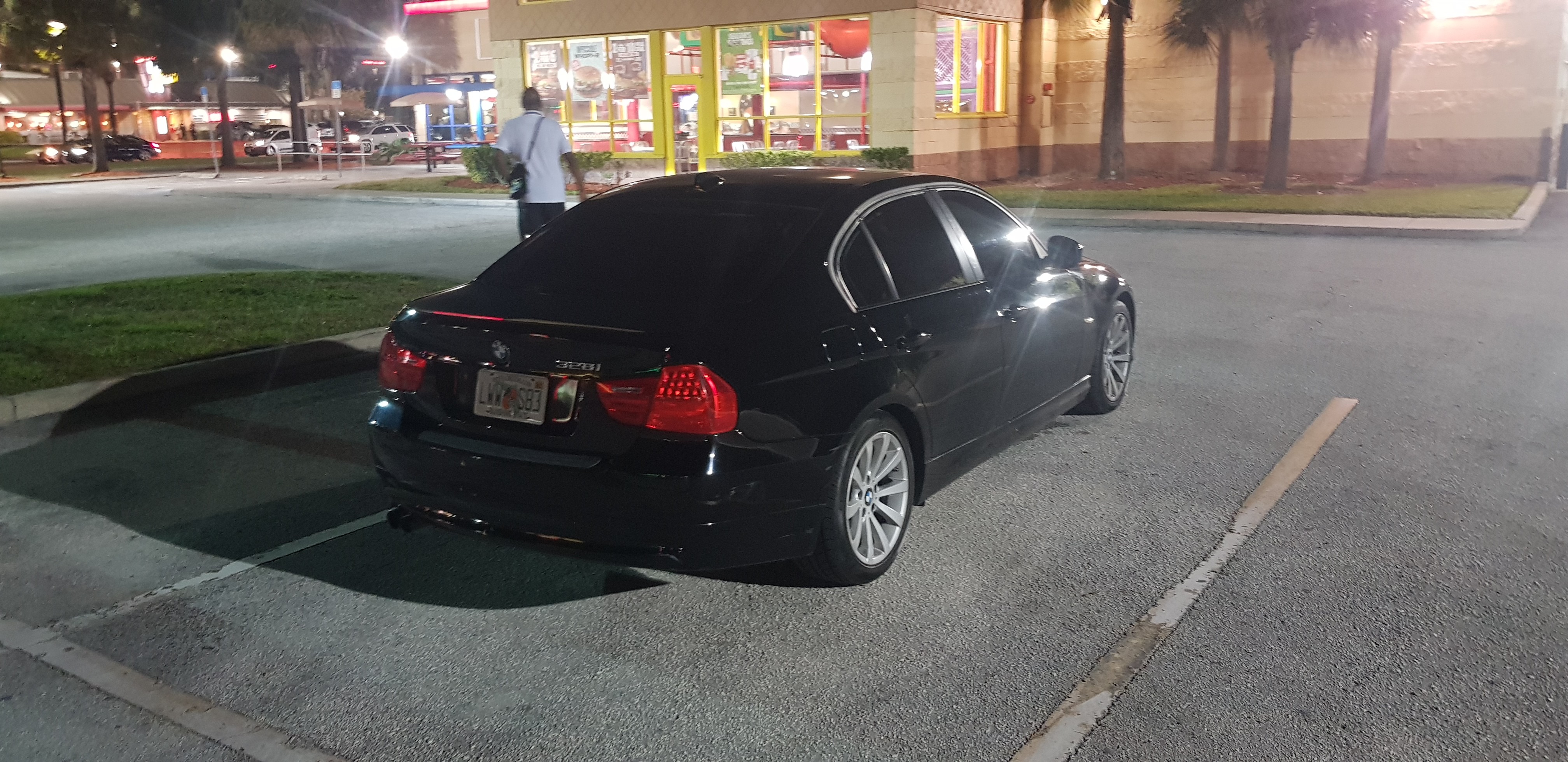

I was also surprised with an E90 328i when I went to the States in December.. Snapped a pic just because.

N52 motor in this should be the same one in our E92 325i and E82 125i, no? A detuned B30.
