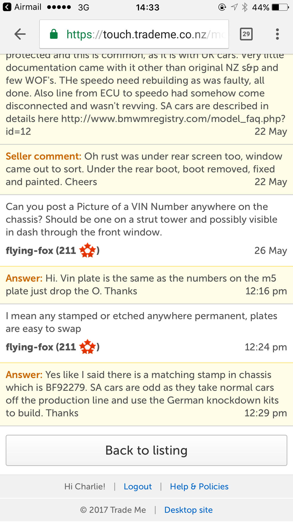

It's on our local ebay type site Trademe http://www.trademe.co.nz/Browse/Listing.aspx?id=1329462975&permanent=0

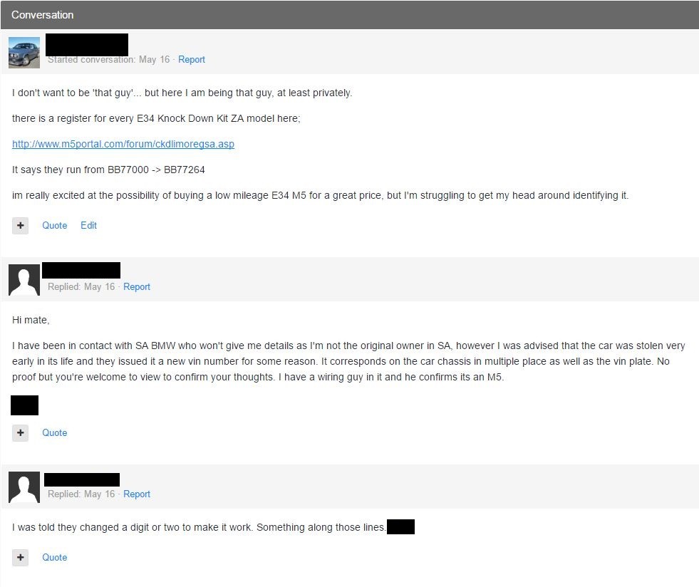

I approached the seller and had the following conversation;
It just doesn't sit right to me, the world is full of a million non M/Alpina etc BMW with M & Alpina badges, and I'm wary that this is a slightly more elaborate false M.

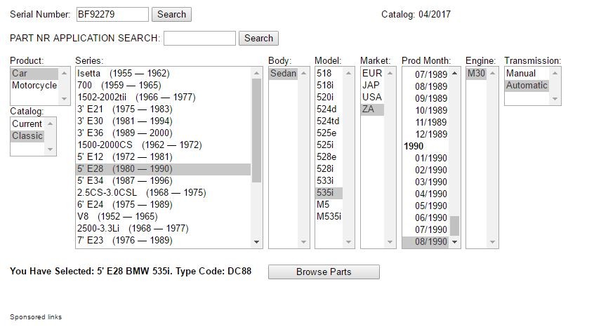

Go to www.realoem.com, then the classic section, put the last seven digits of the VIN in and see what it brings up.
This would be a good start to your search for clarity and peace of mind.
cpjfox

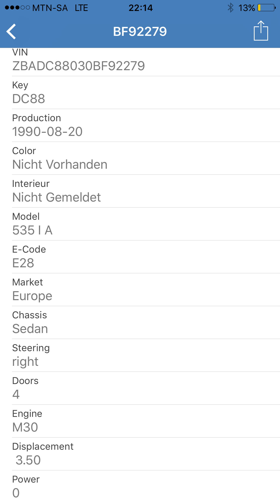

I should have mentioned, when the VIN is searched, other than the fact it is not on the E34 M5 register, and does not match the format, it comes up as an E28 5 series, or sometimes an E34 520. Which the vendor explains away as 'weird south african vin number stuff, happens all the time, especially to E30's'.
Please trust me, I've done my due diligence, everything points to this not being what the vendor says it is, but I'm giving him the benefit of the doubt that something different does happen in South Africa, and that a forum member here can shed some light on it.

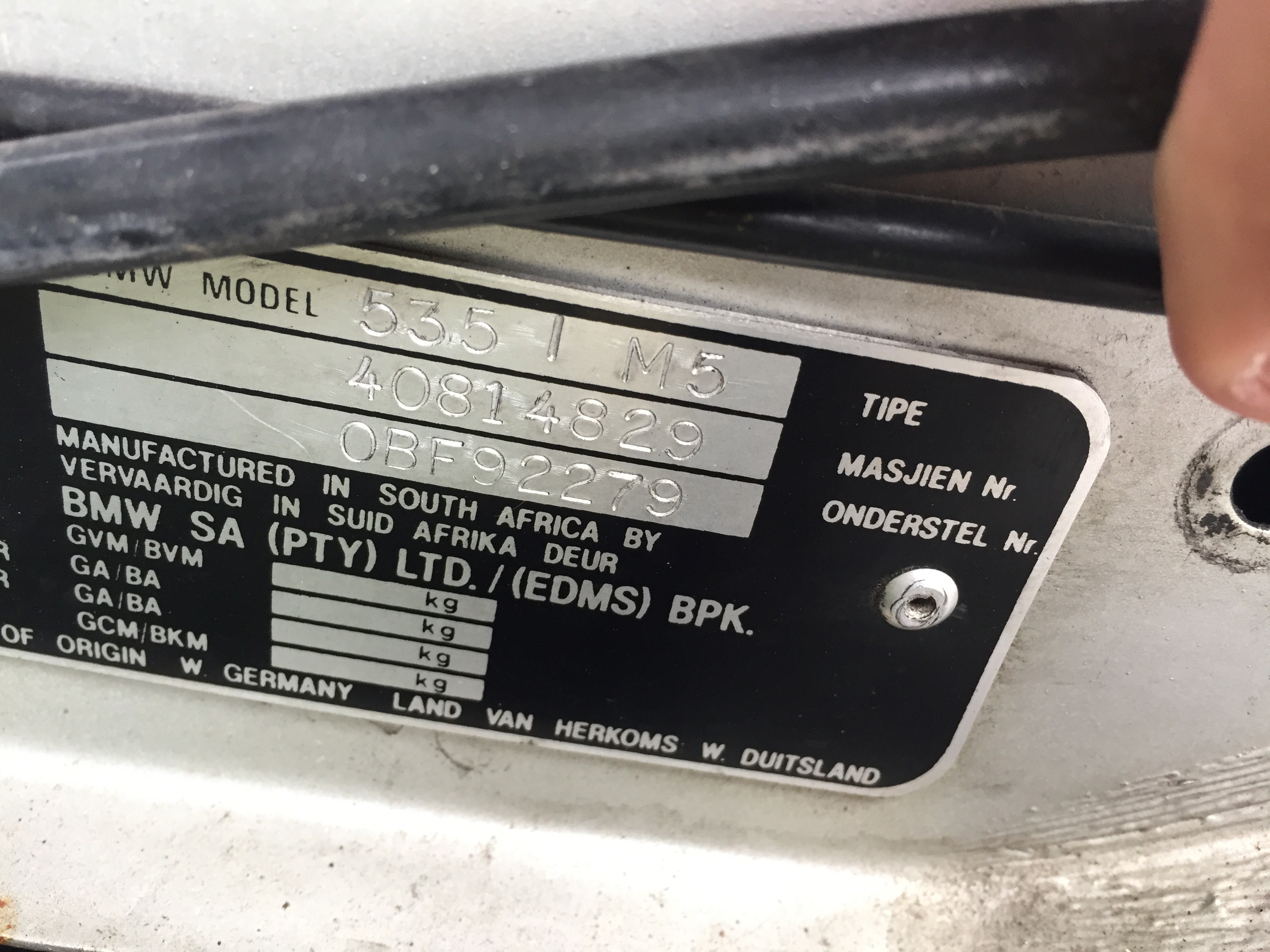

The vendor says that the VIN was re-issued on the plate (as in the message text above, due to a theft/writeoff situation ZA side), but he also says it matches the VIN in several places on the car, I've asked for photos of Chassis printed VIN's and he hasn't complied as of yet.
Peter@AEW
Some of the early E34 cars had E28 chassis numbers so Realoem is not going to verify authenticity.
The South African E28 M5 cars all reflect as 535 chassis so Realoem will bring them up as 535 cars and so will the BMW Agents in South Africa.
If a car is stolen and recovered it will not be given a new chassis number by BMW but will get a new chassis number stamped by the police.
That chassis tag looks peculiar.
I would have serious reservations as to the cars authenticity

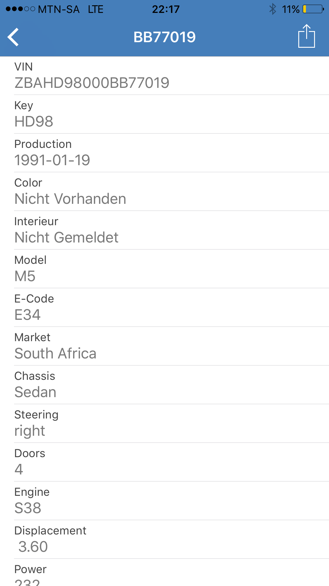

I owned BB77019 and my friend had BB77006 which you will agree makes them some of the very first cars. Both cars had vin plates that only states “M5”.... Not “535i M5”
Both were assembled and registered in 1991, and the one you are looking at is a mid 1990 built car.
In SA, they were built from CKD kits, and the body was basically a regular 535i that were manufactured in the Rosslyn body shop, albeit with a unique M5 vin sequence. Then put on a side line where the M5 bits were assembled into the regular 535 shell.

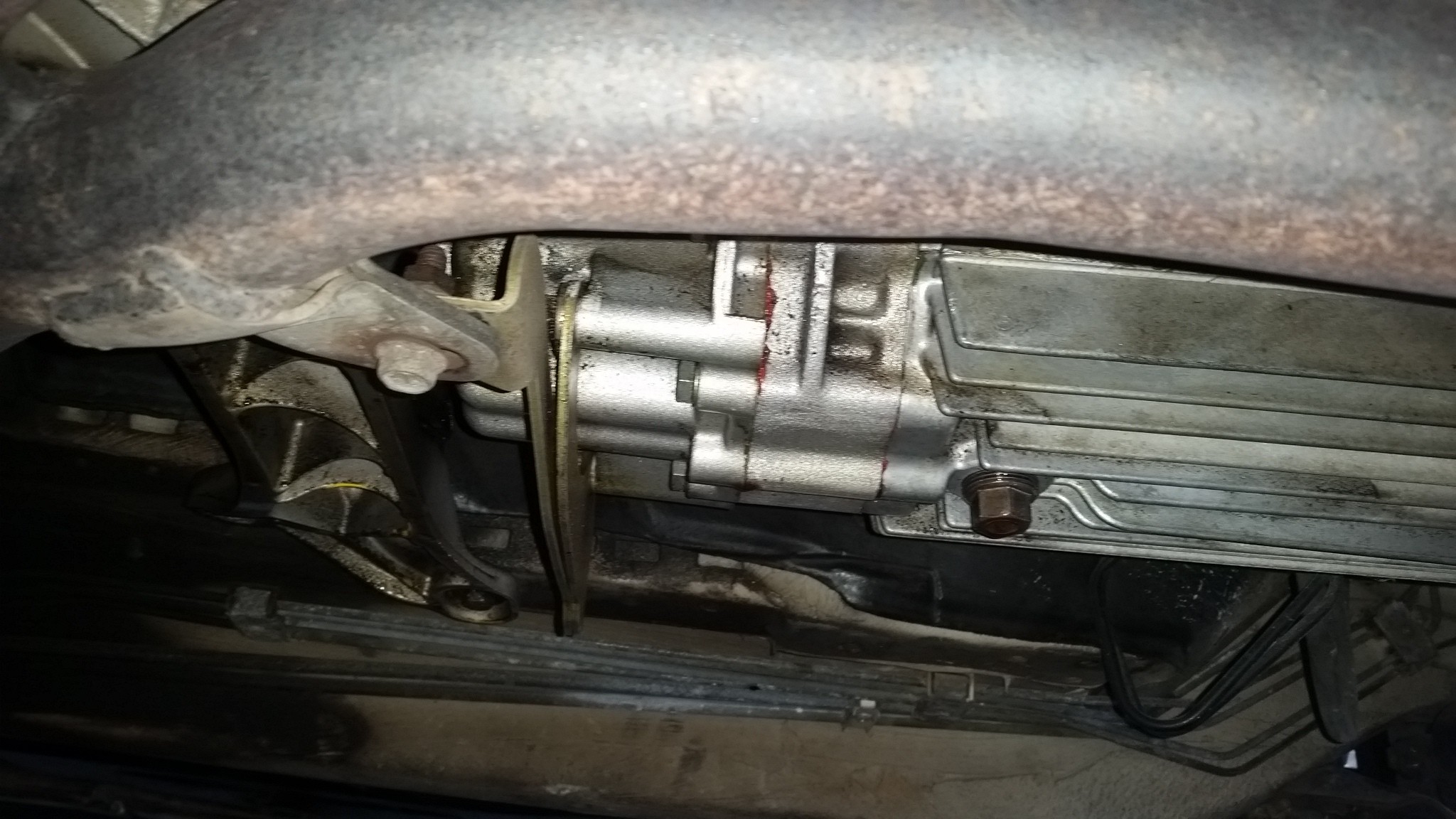

I would have gone and inspected the car from underneath to make sure it has the M5 specific adjustable trailing arms, Rear SLS, the G280 gearbox, M5 aluminum control arms, M5 brakes etc, and if all these things check out, take it.

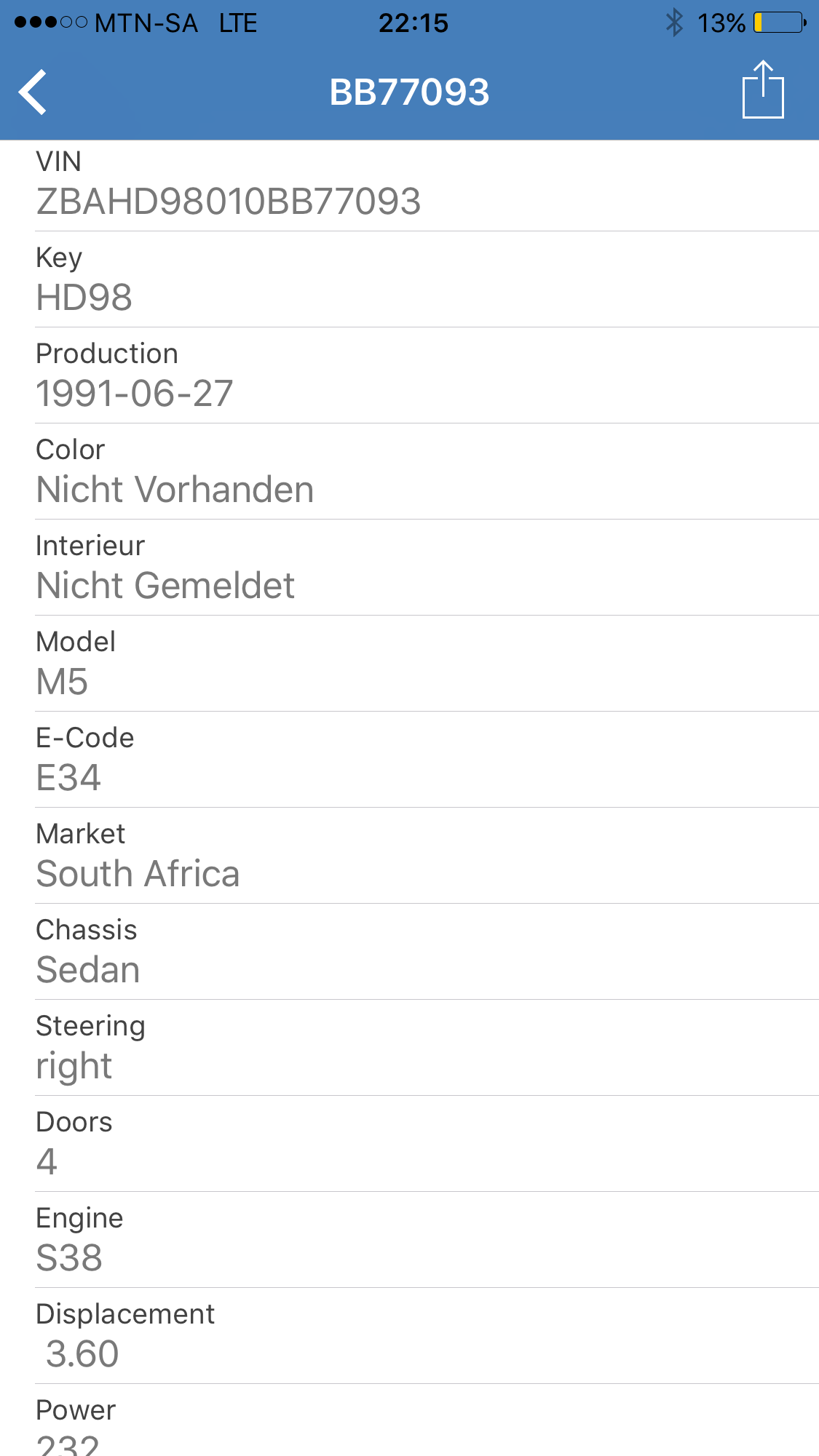

The E34 M5 from South Africa have sequential VINs from BB77001 to BB77265
In theory one of those VINs should be on the chassis somewhere, it really does look like a reshell.

Why does the Plate not have weights on it? Every Plate I have ever seen has the weights stamped or printed on it.. this one seems to be missing?
cpjfox

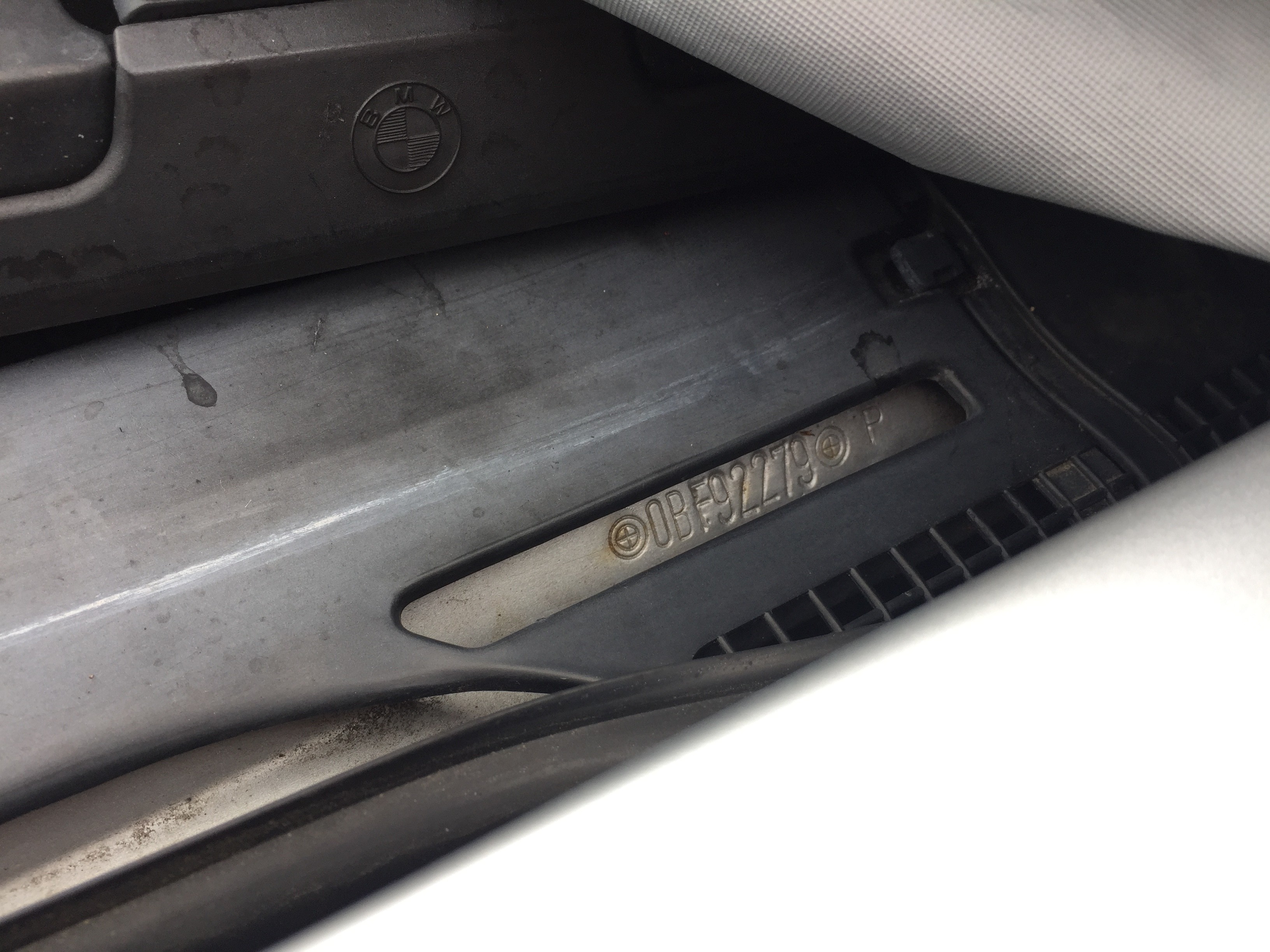

Aparently the chassis VIN matches the odd plate, but he won't post pics of it... I'd hate to someone pay M5 money for a very thorough replica.

- The 0BF92279 was checked at the NZ border in 94 and is stamped on the fire wall and on the vin plate. The reason I did not upload is I didn't want to waste my time forefilling peoples needs for a witch hunt.

- The vins on the windows have all been removed and polished out pointing to early deception, however this would have been pre 94 import.
- Car has self levelling, 280 box and all the M5 stuff. I have no identications that its been a repainted shell or anything and ha genuine M5 sticker info inside the door

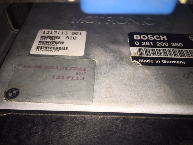

- The vin on the DME does not match the chassis but is a E34 M5 computer

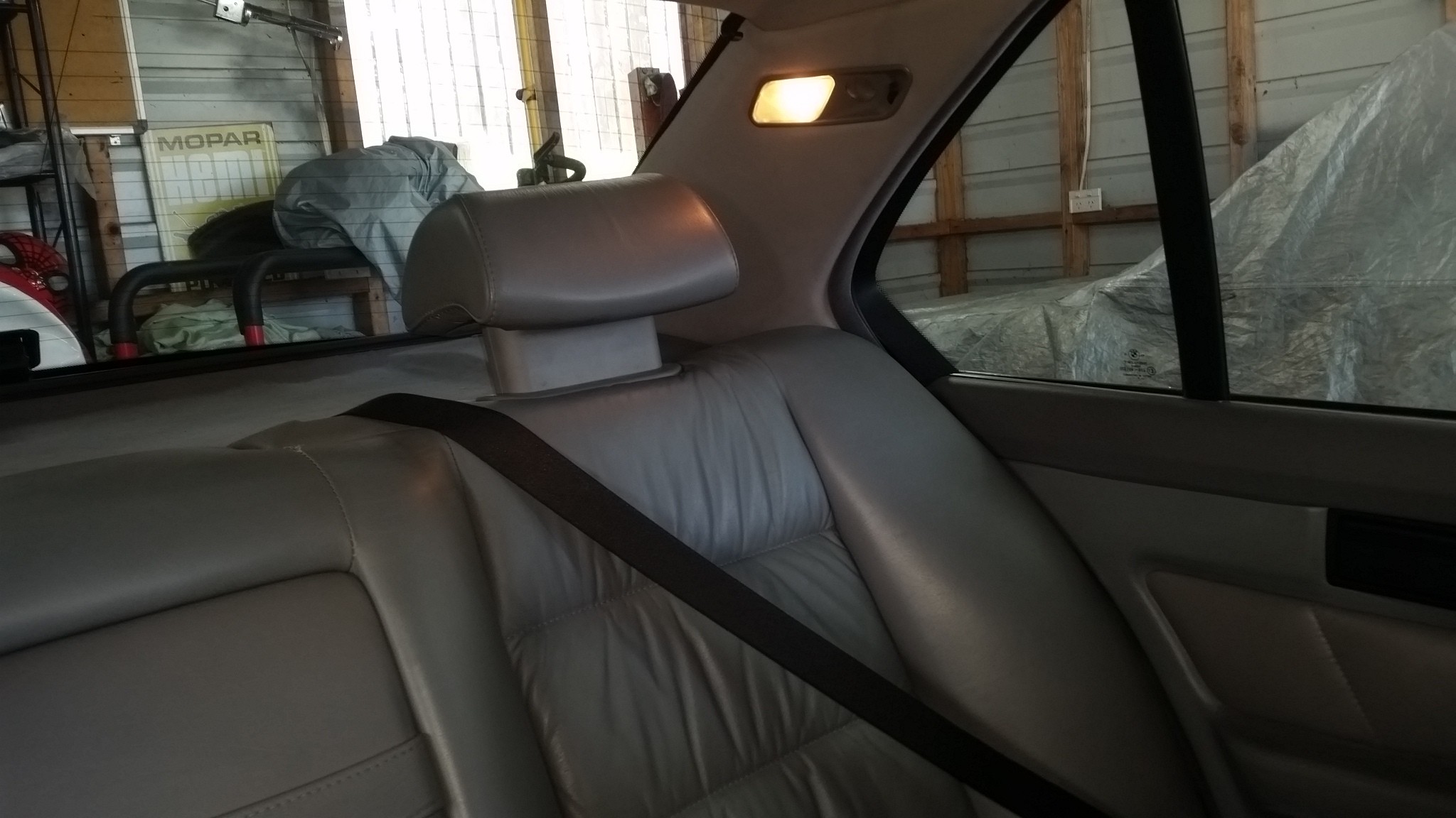

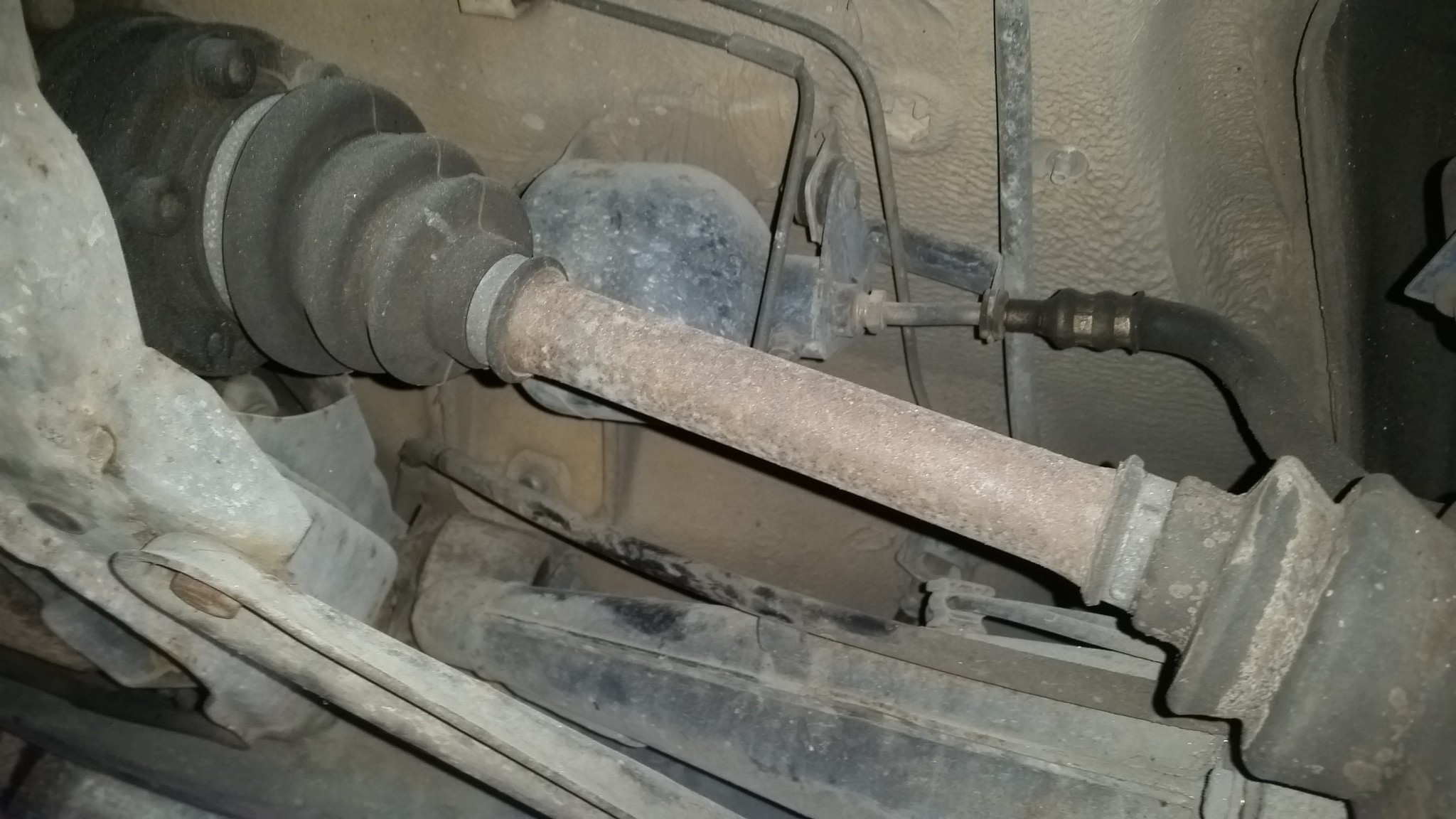

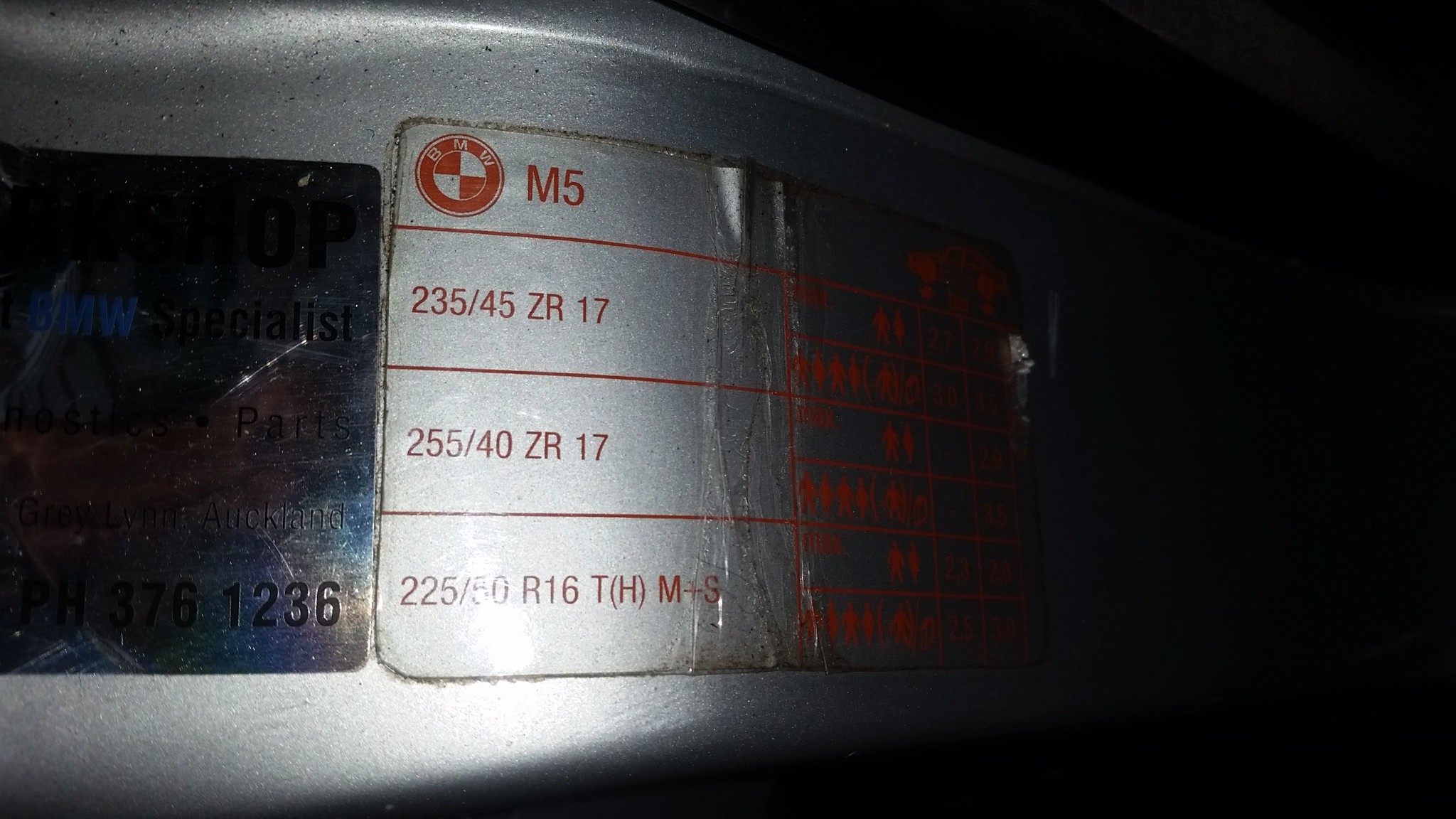

Few more photos of M5 specific stuff. I also have the wiring being repair for the rear heat head rest adjustment
Also you may not that the vin report below is not full completed as it would normally be, pointing to it being used for some other purpose maybe??
Vehicle information
VIN ZBADC88030BF92279
Type code DC88
Type 535 I A (EUR)
E series E28 ()
Series 5
Type LIM
Steering RL
Doors 4
Engine M30
Displacement 3.50
Power 0
Drive HECK
Transmission AUT
Colour ( *)
Upholstery ( *)
Prod.date 1990-08-20

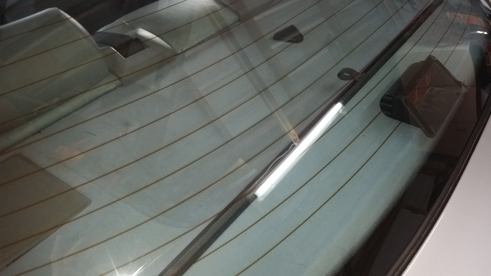

I may be wrong but I don't think any of the S.A M5's have a rear window stop light. Only the wide grille e34's have the stop light, and e36 mirrors.
gtstarped
Yep it has one although Nz law to have some so possibly added here. Currently in communication with BMW SA after my 4th email. May have firm answers soon. Cheers
