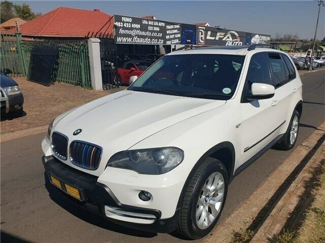

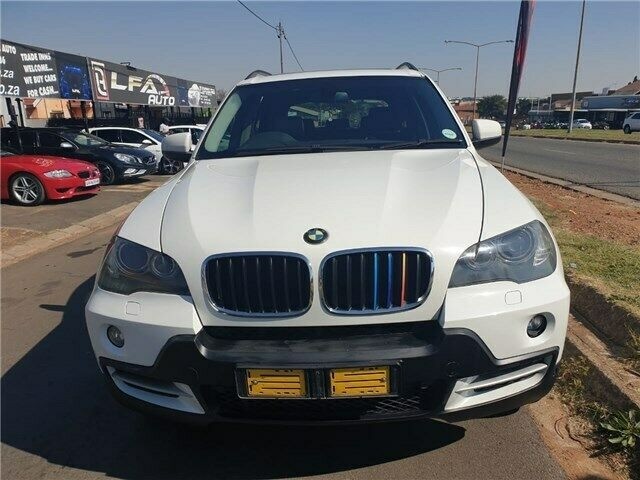

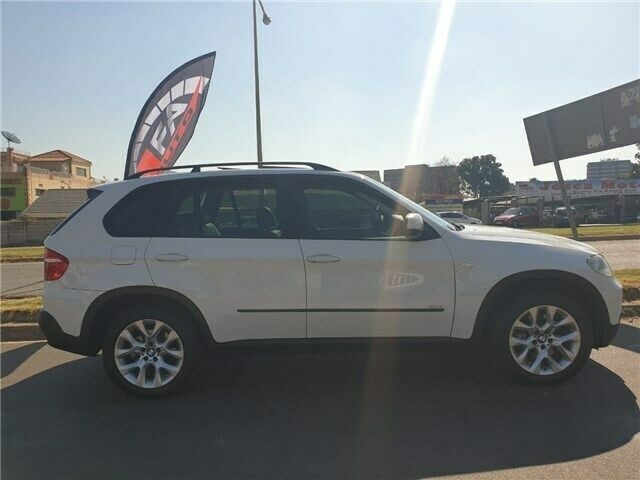

So this is the vehicle in question:dunnoanymore:
I saw this and was hoping it wasn't the same one... Honestly, I would just give this car a skip.
That dealership seems like a 'scammy' one.. I've seen some ads from them that make me question the legitimacy.
If your heart is set on it, check and triple check EVERYTHING.

Bud in my opinion wait for an Lci or another X5, I looked at an X5 at this LFA place when my brother was looking and the one we looked supposedly accident free, had overspray all over, panels didn’t line up, etc. I was kind of expecting it anyway due to it being a roadside dealership as gents have said, so yeah didn’t get good vibes from that place.
Also that one has lci rims on, I’m already thinking about the reasoning behind this.
