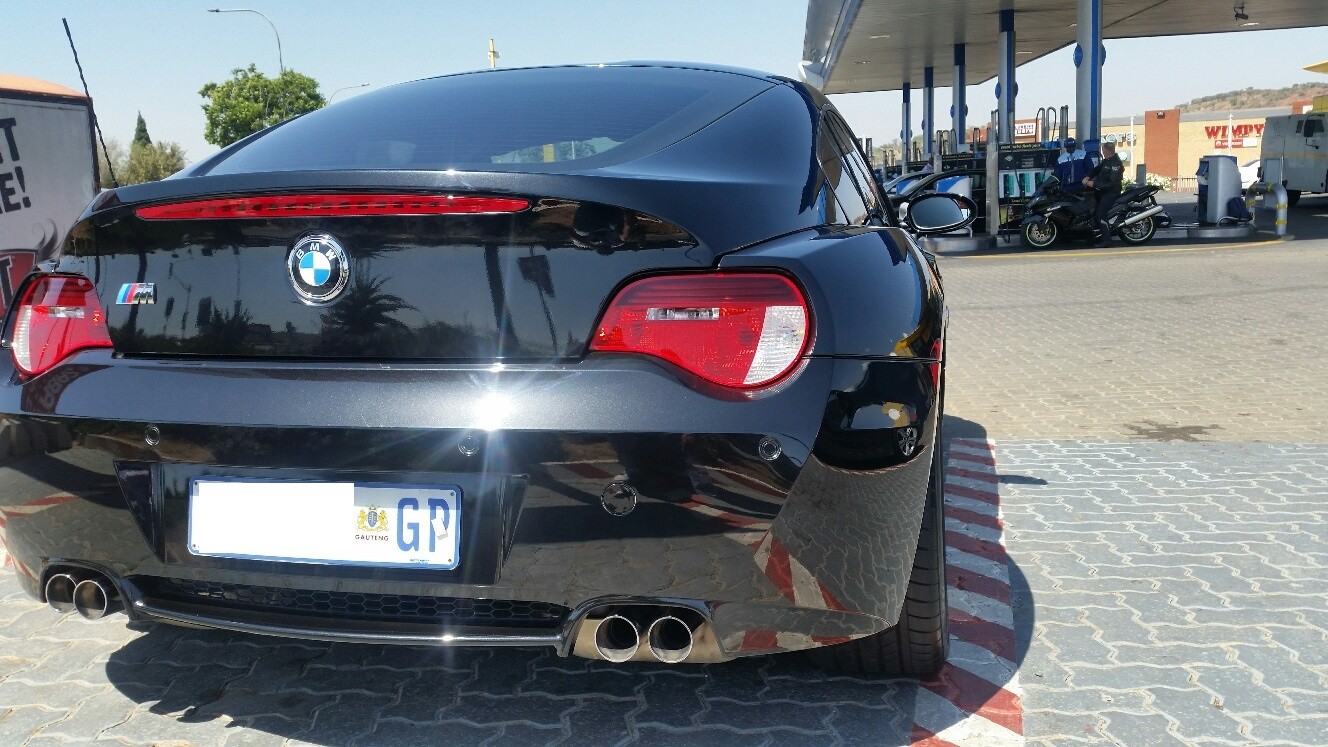

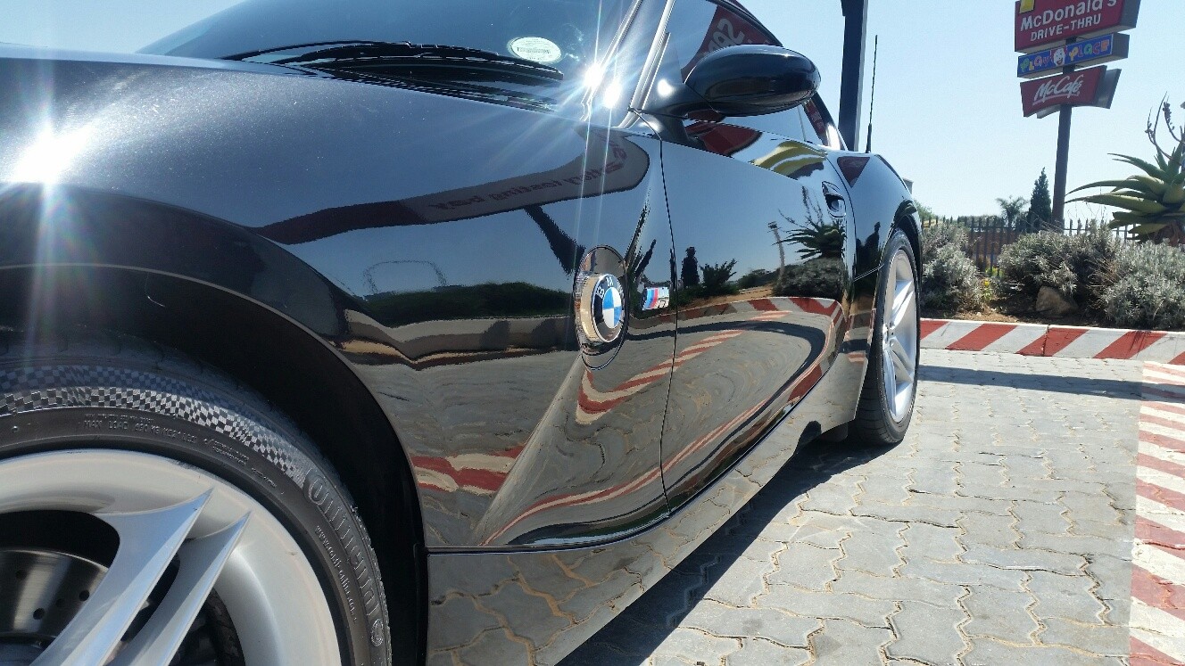

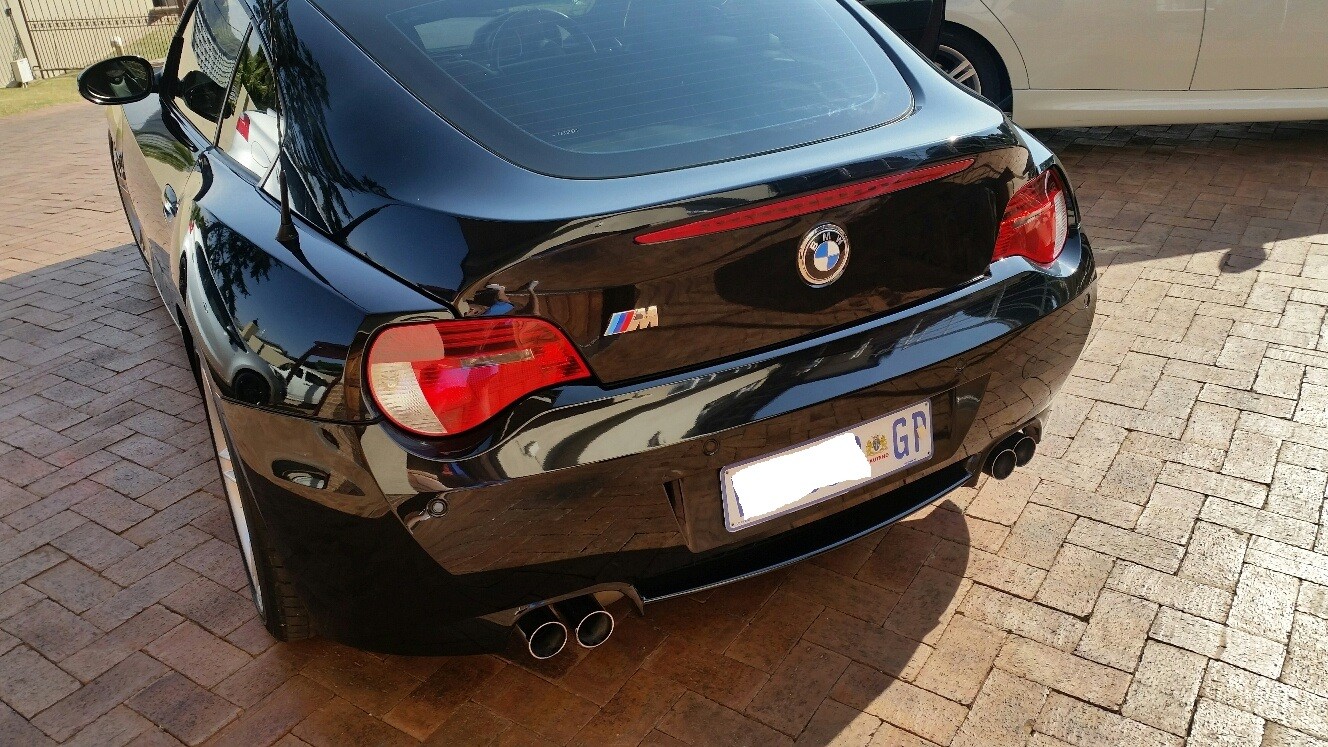

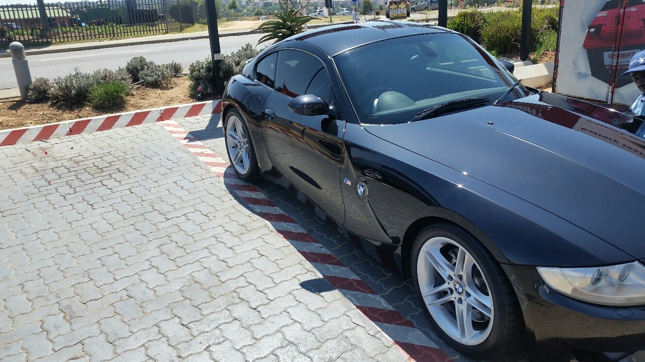

Went past crazydetailer and got some products for the car - came out decently for a first time pass at detailing. Will post some pics later.

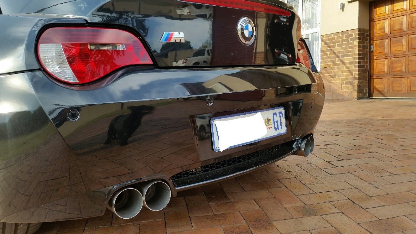

Fitted some straight pipes though - my word is it loud! Going to remove them tomorrow. Sounds insane when driving the car hard but any short shifting etc doesn't agree with this exhaust. Will be selling the straight pipes or just removing the tips and putting the bigger tailpieces on.

some pics of the car after some elbow grease :=):
This one is a dirty car but with the straight pipes:
