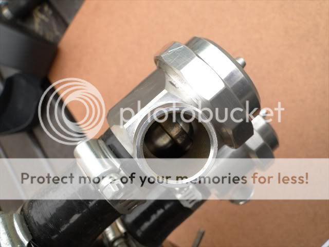

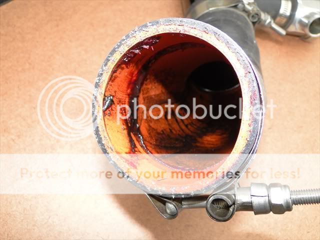

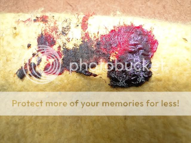

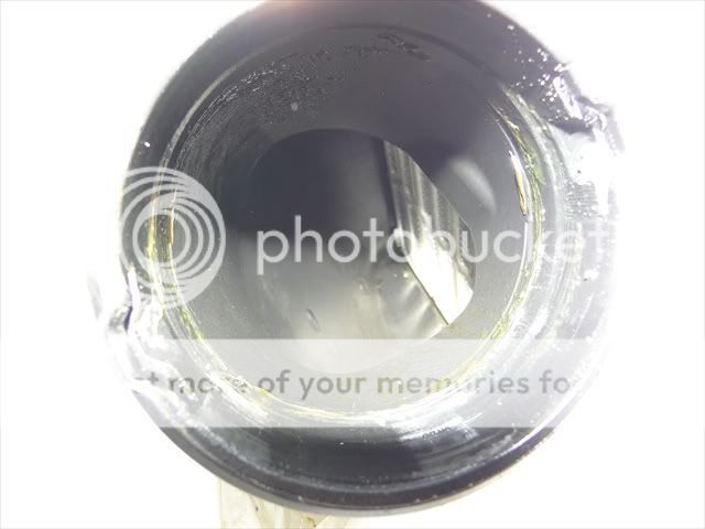

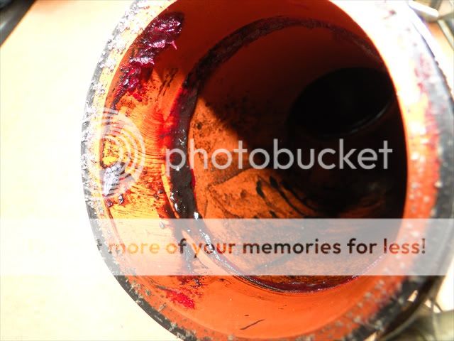

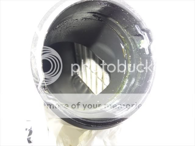

So are the above definitions correct and true that you will find an accumulation of oil sludge mixture; blow-by gases & even water and fuel from the crankcase; inside the intake tract, intercooler and boost tubes? :thinking:
I have done this exercise on my previous 335 and the current one and on both cars found this and both had low kilometre readings:
Not so easy to see in the stock intercooler since I took it off almost a year ago but dry oil film can still be seen on the inside when touched with the fingers:
So this blow by I am made to believe is normal operation procedure but surely sooner or later it will hinder the ability of the car to make more power and as it becomes more prevalent in the intercooler core it will lower the efficiency of the intercooler to create a cool intake air charge. This same blow-by will build up in the turbos and diminishes their life and efficiency. Imagine these blow by products seep into couplers and boost tubes causing them to pop off during high boost as well as causing disruptions in airflow. :cursin:

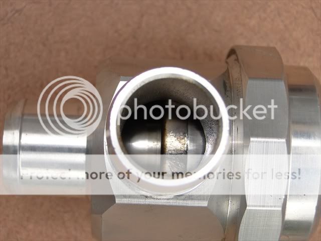

Oh my, I even found blow-by in my diverter valves::uhoh:

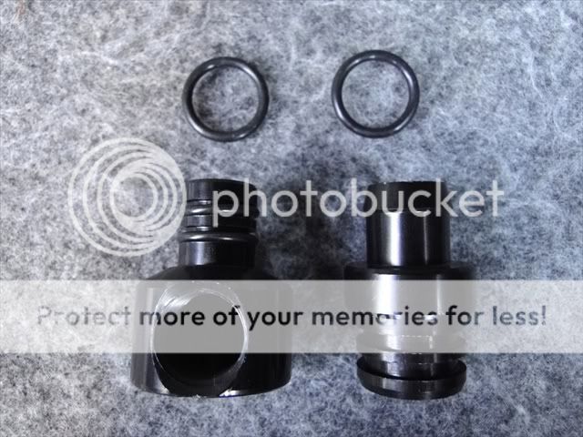

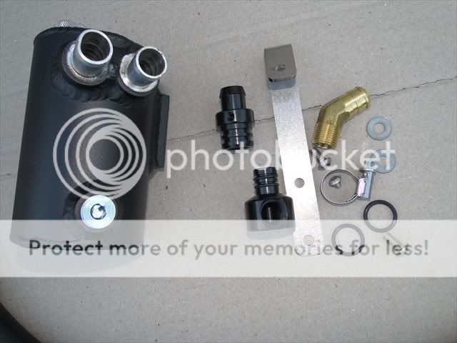

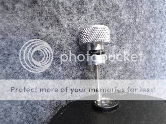

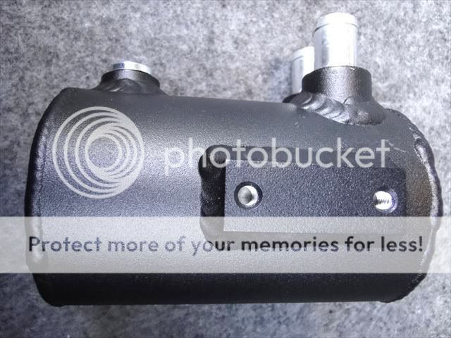

As always the products from our suppliers were neatly packaged and of very high quality. Some pictures of the entire kit:
The picture below was borrowed from the NET.
I repeat: Essentially the BSH Competition Oil Catch Can will hold and trap oil blow by while removing it from the intake air channel. :thumbsup:
Main Specs & Features:
* N54 specific 3" recirculation Catch Can
* Billet dip stick
* Tig-Welded Lightweight Aluminium
* Hi-Temp Powder Coated Finish
* Free Flow Design
* Air Separation Baffle
* Laser cut mounting bracket
* Outlet PCV adapter
* Inlet PCV adapter
* 10 push lock line
* All hardware necessary for installation

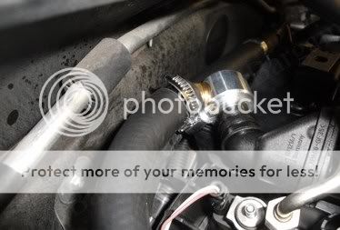

Here are some pictures of the BSH kit installed....and what you see is the installation...there is nothing more to it. Installation and mounting the BSH Catch Can is easy due to the laser cut mounting bracket specific for the N54.:excited:

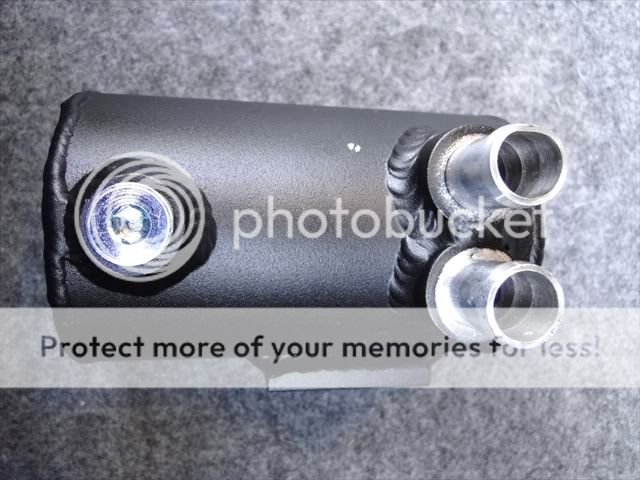

Removal of the Catch Can for draining is also made easy by utilizing a drain plug mounted at the bottom of the can, and two 4mm allen screws, allowing the can to come off and go back on in under minutes. To check fluid level inside the catch can BSH also included a billet dip stick without taking away from the form or function of the can.
See drain plug at the bottom of can:

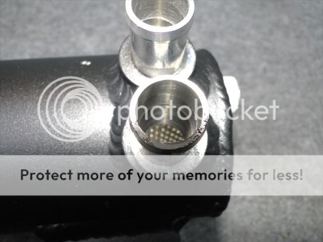

Internally the catch can has an integrated baffling system that forces oil to separate from the air as it passes through. This oil then falls into the gut of the can and can be drained at the next oil change. A picture of the inside:

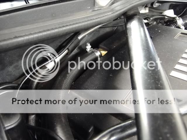

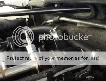

Catch Can Installed:
What you see is the installation...there is nothing more to it. Installation and mounting the BSH Catch Can is easy due to the laser cut mounting bracket specific for the N54.:excited
The BSH can is a direct addition to the factory PCV system and does not require any permanent or unsightly modifications to your engine bay.
The two pictures below were also borrowed and give a clear view of the installation behind the back of the engine cover.
