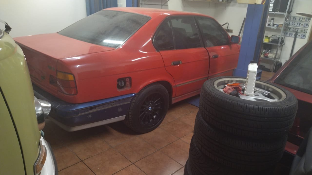

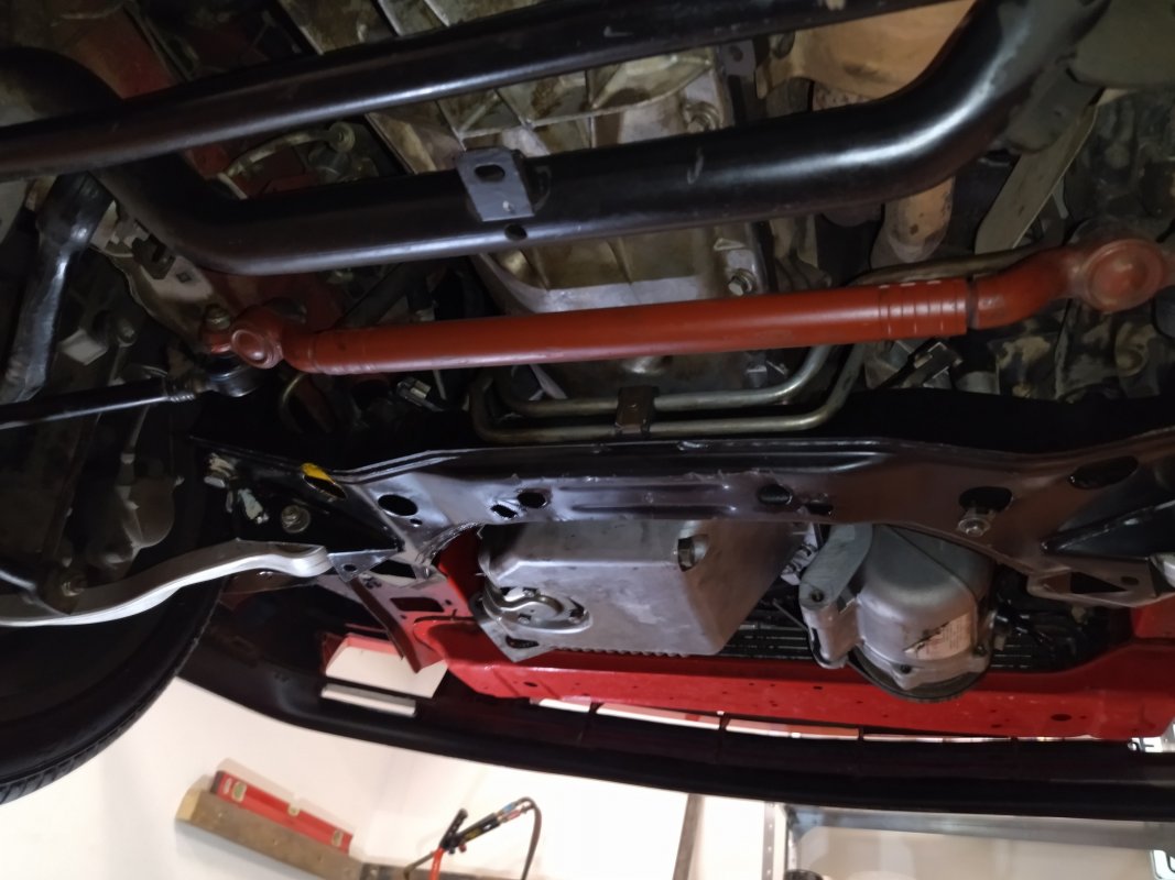

First things first - get the car running. New radiator, cross member and front suspension as the impact had knocked a front wheel backwards.
Car ran a bit rough, but it ran and sounded good! So we drove her around like this for a while

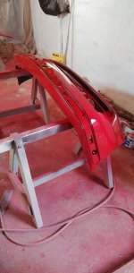

This review isnt really in chronological order, but onto the cosmetic items we go :)
We acquired a new to us bonnet, front bumper and grille and drove around with a multicolored car for a while. I'll never forget when I was cruising on the highway and came past a very clean M5 with turbines on it. The look of shock and horror on the drivers face when he saw the front of the car with the Sjangalala still on the windscreen  :smilebounce:

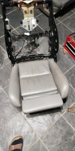

We found a good set of matching sport seats and swapped the passenger seat leather onto our drivers seat. This is technically not a hard job, but you require the patience of a saint, hardened fingers and a steady supply of cold ones to get the job done. Interior was cleaned, steering wheel restored, and the seat twist fixed.
We painted the bonnet, bumper and fenders and gave the whole car a quick polish. The plan is to repaint the whole car as every panel on the car has a little dent or scratch on it.

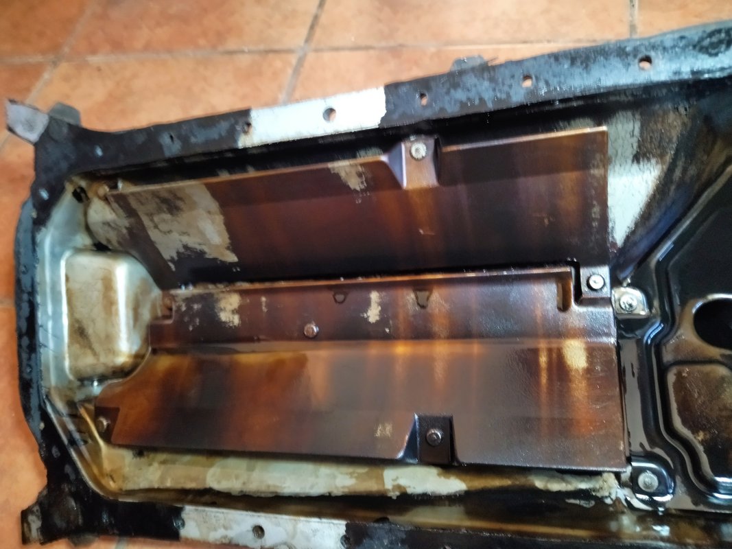

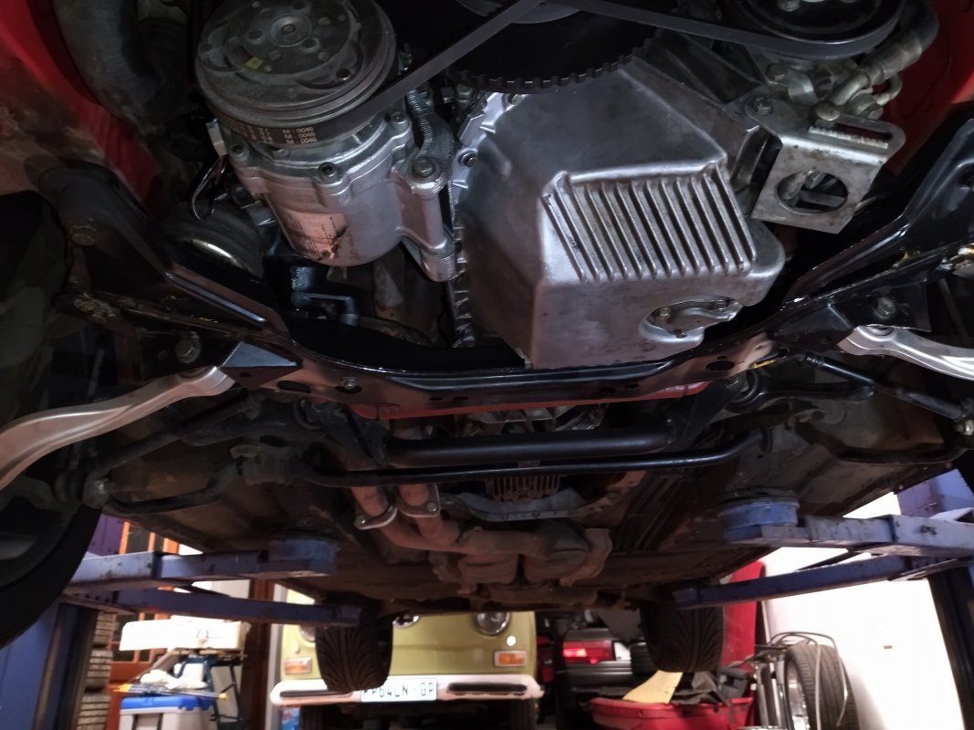

Your eyes do not deceive you. That is a 30 year old BMW that does not leak oil. My garage mop is besides itself with grief since it has now become unemployed like so many other South Africans. Busy with UIF applications for the redundant member.
Onto the car. All gearbox seals replaced, sump gasket replaced, timing chain tensioner replaced. This was actually the main proponent of the auto-oil-change feature on this engine.
A few other time consuming items were completed: Replaced cabin air filter (what an absolute c*nt of a job), found the battery drain, recommissioned electric rear headrests, recommissioned sound system etc...Car is off to Auto Lounge for the paintwork, super excited to start putting things back on the car for a change
