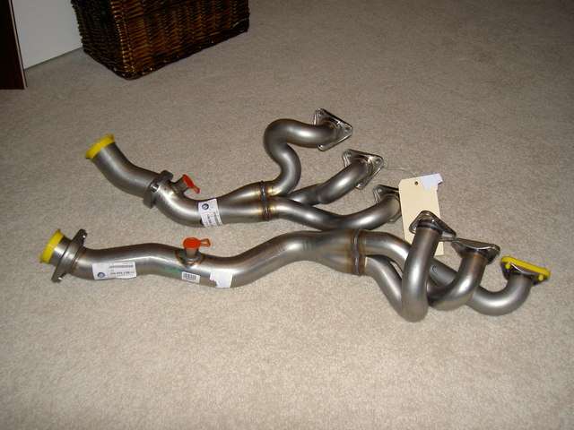

The exhaust manifold’s length, tubing diameter and the manner in which each cylinder is linked to the other is critical when attempting to maximize an engine’s power output. The manifold configuration can be manipulated in order to generate maximum power at low, middle or high rpm, changing the shape of the power curve accordingly. Naturally some compromise must be accepted when tuning an exhaust manifold for a street-car as the goal is typically to ensure balanced power output at low, middle and high rpm. This is in contrast to a race-engine where the exhaust manifold can be tuned specifically for maximum performance at high rpm.
So the factory manifold is near perfect when it comes to all-round power. But I suppose their are gains to be had if you are going balls-to-the-walls with full-on mods like cams, heads, high rev-kit, etc. There you will focus on high rpm power & the manifold design will be modified for maximum flow up top. But you must bear in mind that you will be compromised low down & in the mid. But if you want an NA monster, that's the sacrifice we have to make.
