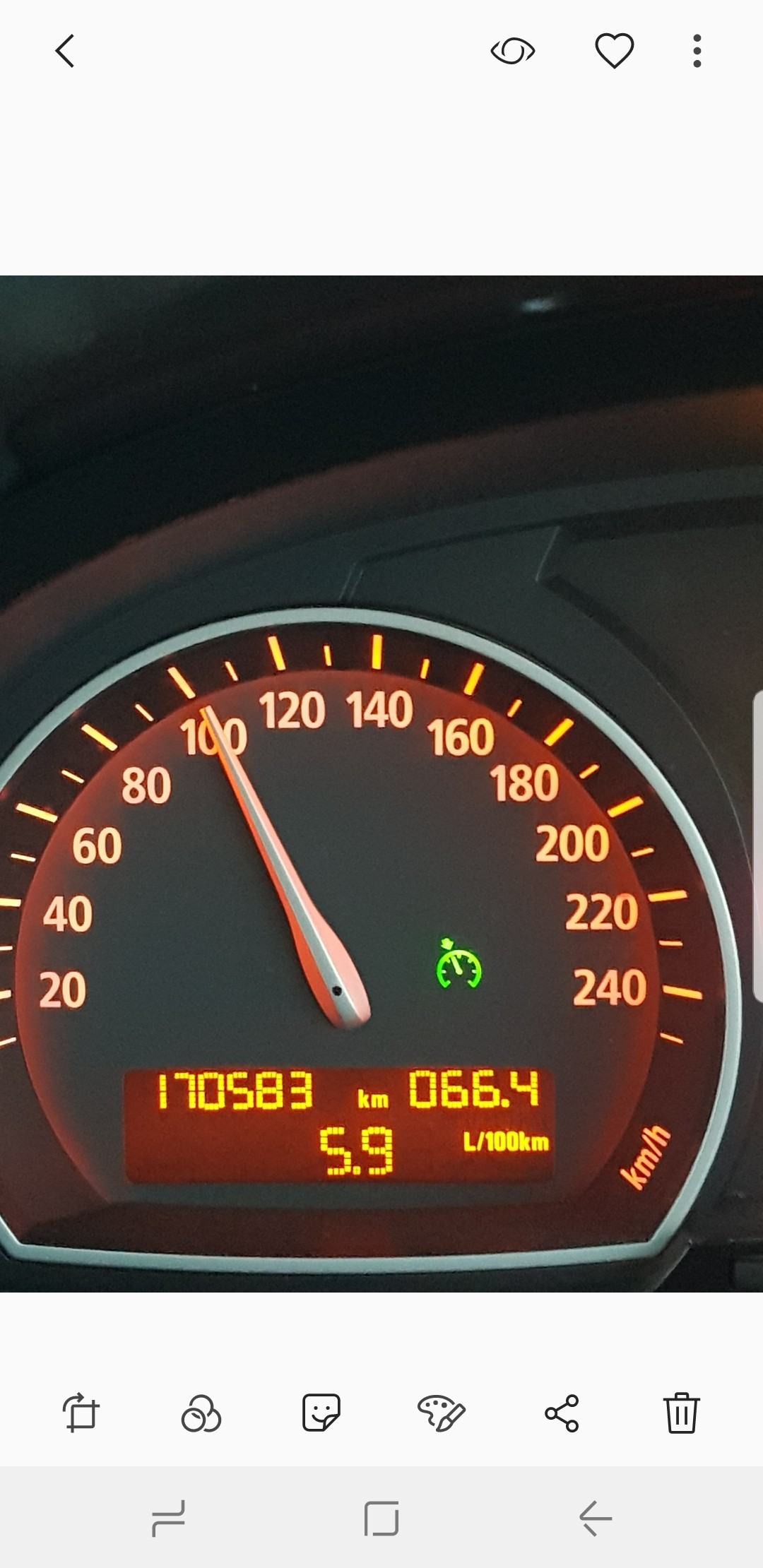

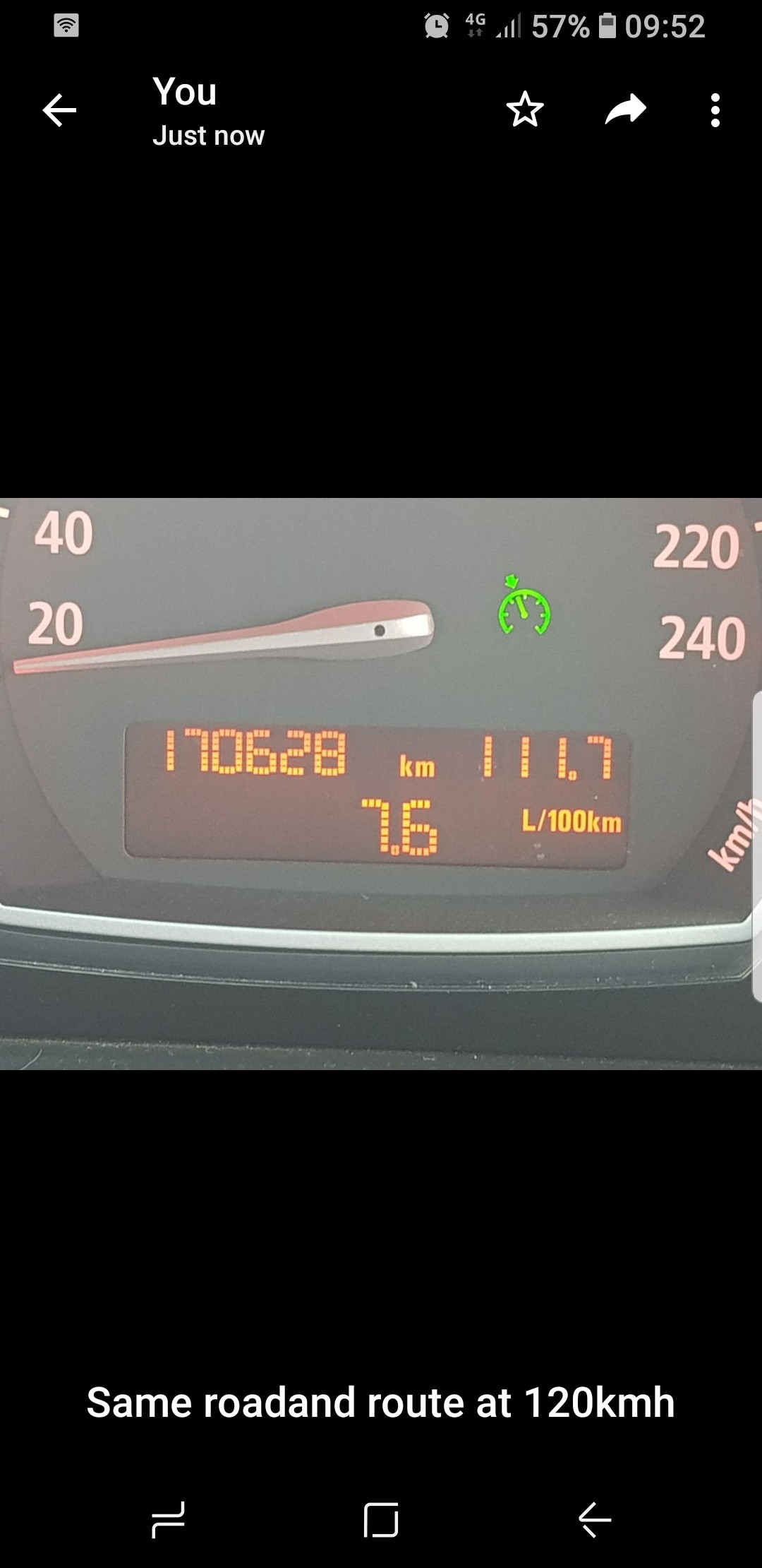

So.......got vehicle back. And here is my findings thus far. Will be doing open road tomorrow and post again. Egr delete and swirl flaps removed and throttle nody cleaned. It was badly clogged up. So big question is how does she drive. Firstly no major difference in power, lag or response. Was hoping response be better. It seems to rev bit more freely. 2nd the motor is bit louder sounds like a diesel now. Ever so slightly inside cabin still the same. Lastly the nice improvement is the fuel consumption. It has dropped between 0.8 -1.5ltr per 100km around town. Hoping ti see open road improvement tomorrow. I avg 7.3ltr per 100km around town and some peak traffic. Peace of mind with swirl flaps is biggest comfort afyer seeing what they looked like. Now for some trouble free km and routune maintanance and my 5000km oil changes. Thanks to those that responded

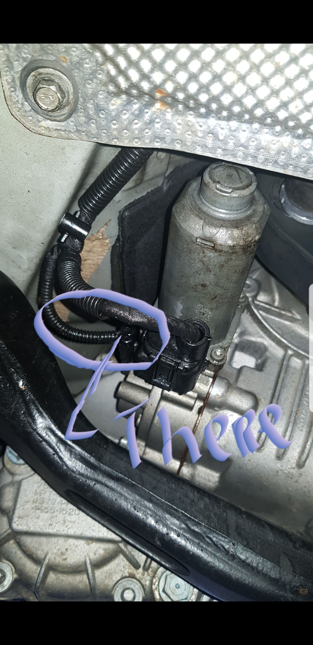

Was at Ultra service station.dealer i bought car from send me for electronic issue. Sensor on transfer case. Order part from bmw. He charged me R2000 fir egr qnd flaps and intaje clean. The soot build up was really bad. Ports was shut halfway and the throttle body. Tookbit longer than promised butgood work and owner involved and hands on. Will try Garage 808 fir service hear good things from them too.
Being replaced from dealer. Sorry Im still learning my first BMW. I like to know and research and keep things running smooth

What was the reason they replaced the sensor on the transfer case? Do you have the same size wheels/tires on all four wheels with about the same amount of tread on all four? If not, you may experience transfer case failure now or in future. The X3's are very sensitive to wheels/tires that are not all the same circumference, because if they are not (even with tires left unattended and becoming low on pressure), if damages the transfer case causing it to make funny noises when turning, etc.

Thanks for reply. Will see what future brings. The sensor faulty brought up 4x4 light and brake light orange. Wheels all the same. I have tge msport staggered 18inch. I have read that tire size have big impact. No noises or sounds driving turning etc. Hennie did deep scan with obd and no faults and transfer and gearbox is happy he say maybe tgey steam ckeaned and damaged connection.
