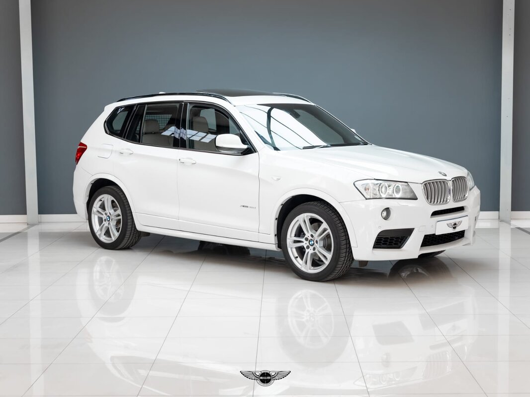

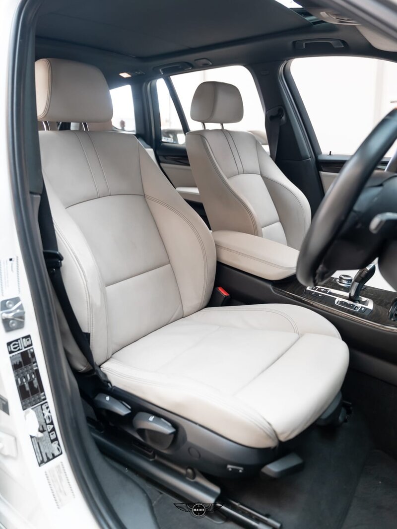

In my continued quest to get everyone around me into a BMW, I recently got a brother of a mate into a F25 30d pre LCI M Sport, white with white leather, 160,000km, very nice spec FSH, well looked after, matching good tyres etc. After an extensive test drive, which specifically tested that 4wd is working, we struck a deal and took the car home. I was very impressed with the effortless power delivery of the 30d and general refinement and quality of the car with only a few minor cosmetic issues.
