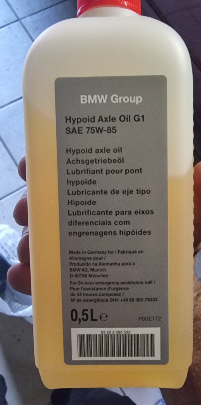

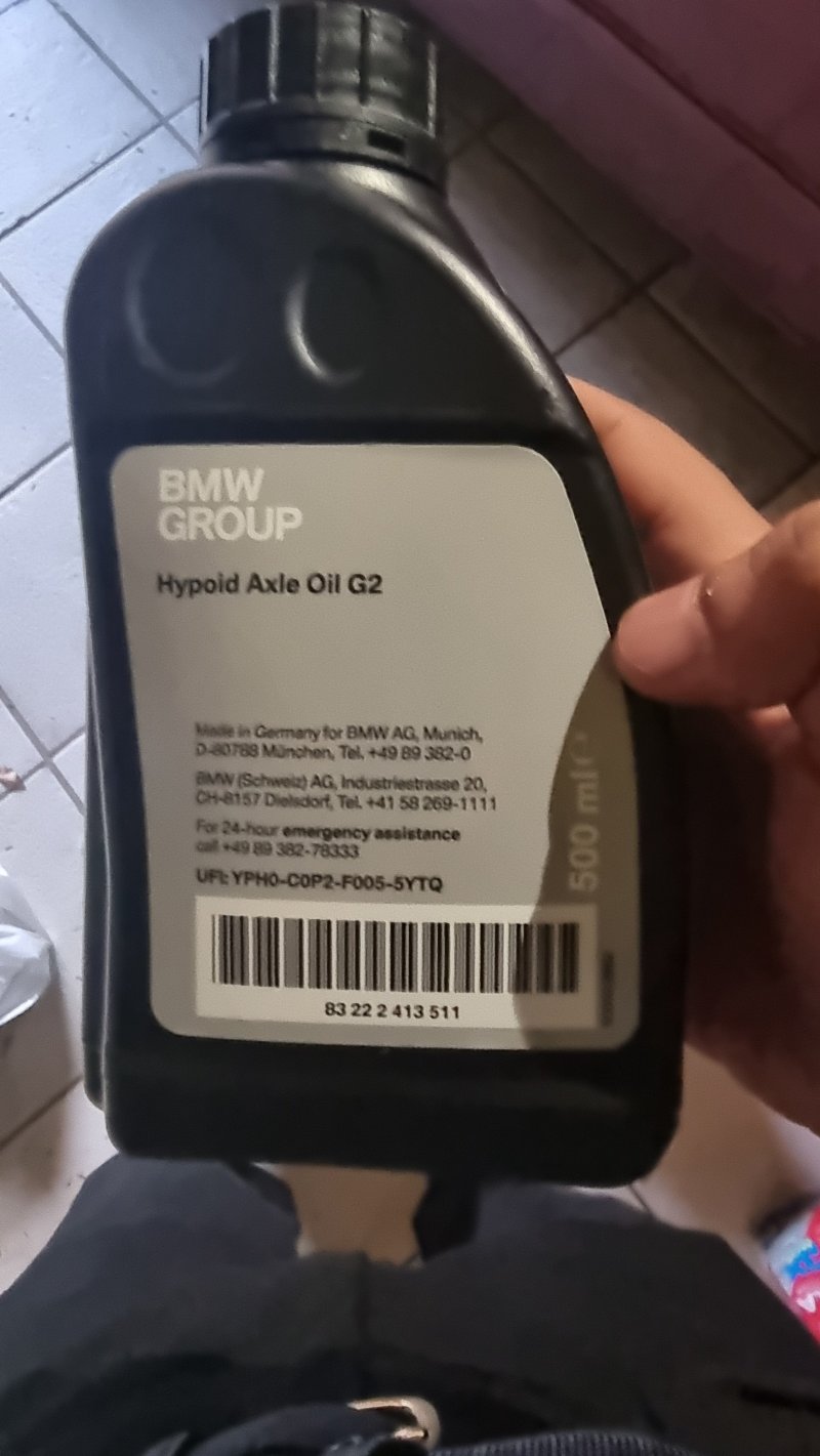

Differential oil for X3 G01 20d xDrive - picked up from BMW Midrand. Cost around R700 (ex VAT) per 500ml.
ZF advised that I need 1.5 litres for front and another 1.5 litres for rear differential.
BMW parts said I just need 1 litre per diff.
I called ZF again and they said 1.5, so went with their advice.
ZF said they will provide Transfer Case and Gearbox oils.
ZF service scheduled for next week
(G2 is front, while G3 is for the rear)

Okay so had my X3 done today...the diff oil quantity is as per BMWs.
The F25 (as per bmw ) is 900ml rear and little less at the front.
So now, I have 1.5 bottles of G2 and about the same for the rear oil.
Luckily the x3 and 330d use the same rear oil, so all isn't wasted.
* did the gearbox, transfer case and both diffs.
