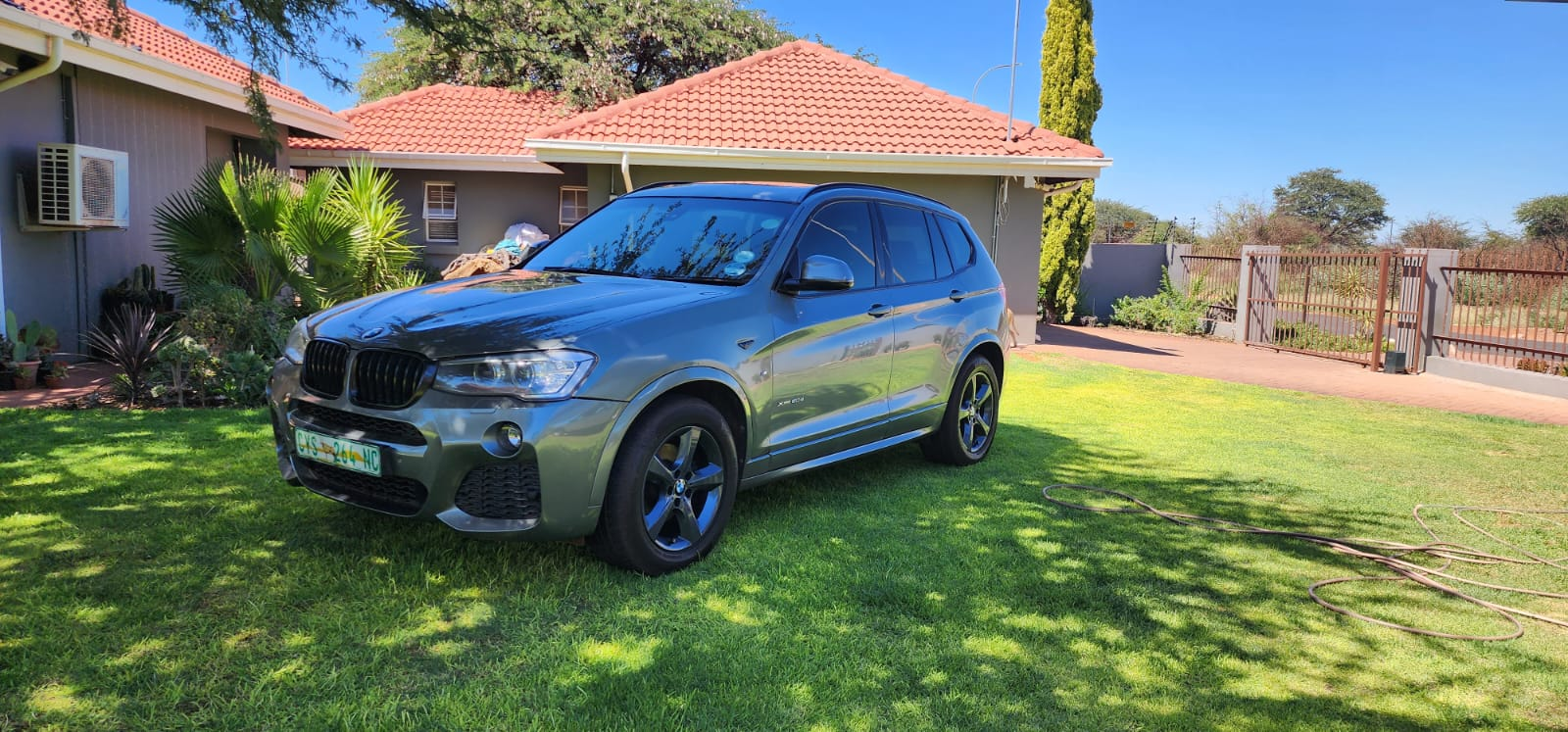

Thought I would share what I did
As I am a cheapskate and driving some rather bad roads with the F25 this is what I did....
I got cheap X5 rims, repainted them (should have made them black in hindsight)
dumped the runflats
old Msport rims were 19, these are 18s,
I fitted 255/55R18 all round and running at 1.7bar the car now feels awesome even on gravel roads.
All four fonkong tyres were R8k. Bargain.

Hi Molten
I have an x3 30d with 245/50/18 which is the stock tyre size the car was released with, have you had any transfer case issues changing to a larger diameter tyre? Id like to go for some 245/50/19 front & 275/50/19 rear but have read conflicting info on the net about x-drives and dont want to damage the transfer case. would be interested to hear if you have had any issues with the 10mm increase in diameter? the wheel arch is pretty big as is so im not to worried about any rubbing.

Hi Mathias.
I have had no issues
BUT, I used the same size front and back. And if you check your OEM sizes front and back, even if the profiles are different the width of the tyre will compensate and your previous staggered setup will be the same diameter as well.
the size you quoted, wont be the same diameter. You mustnt do that, the car will go into limp mode (hopefully) or break.
I am going to copy and PM you this as well, hopefully you didnt go ahead in the meantime....
