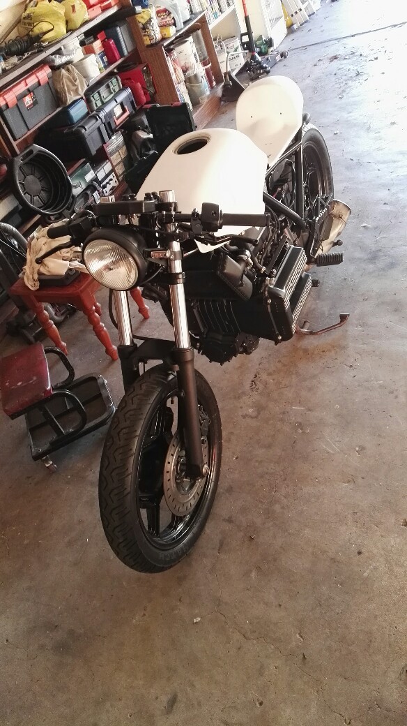

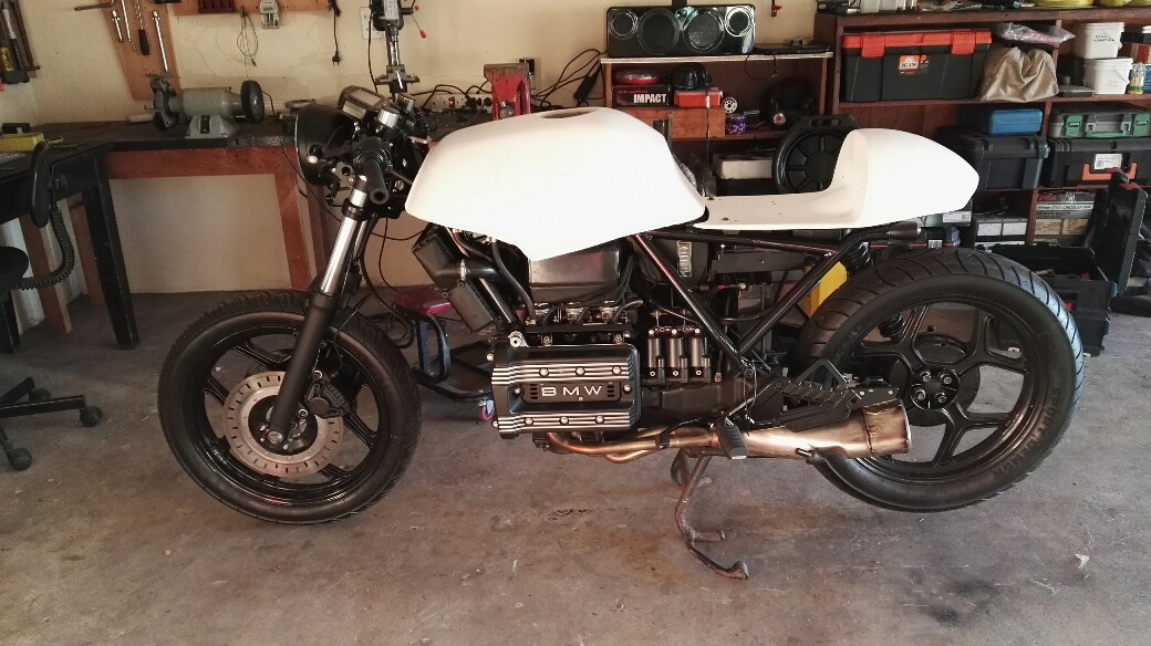

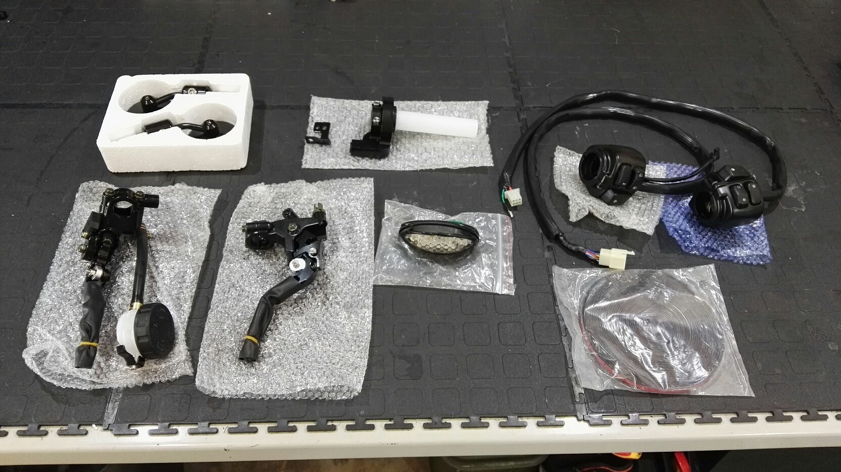

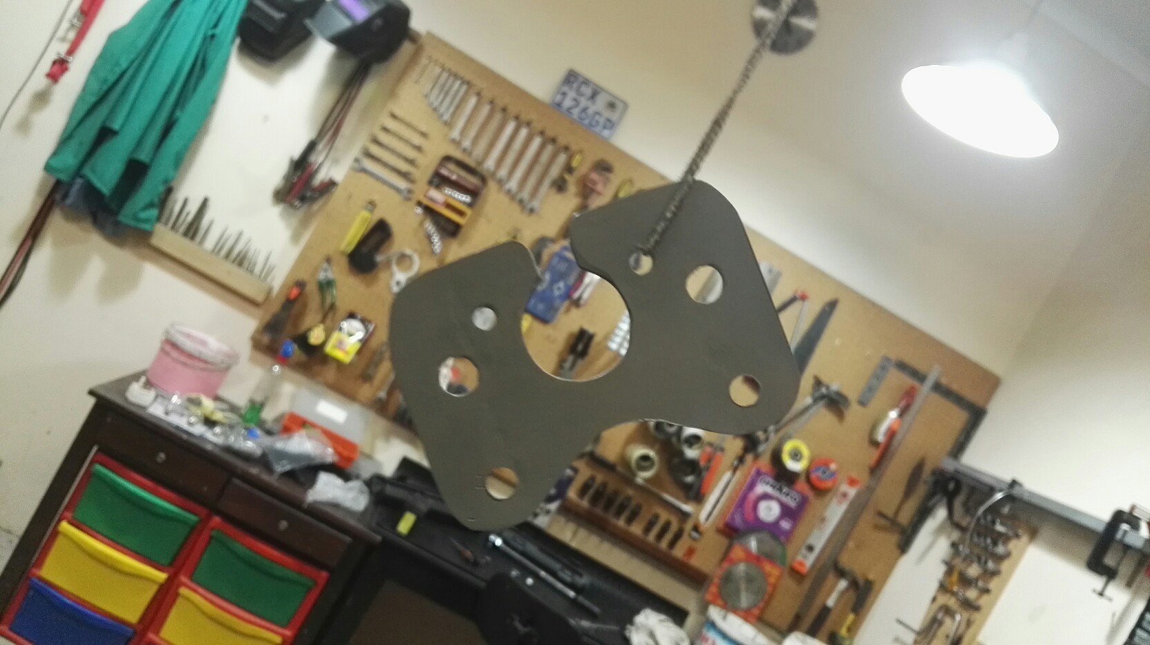

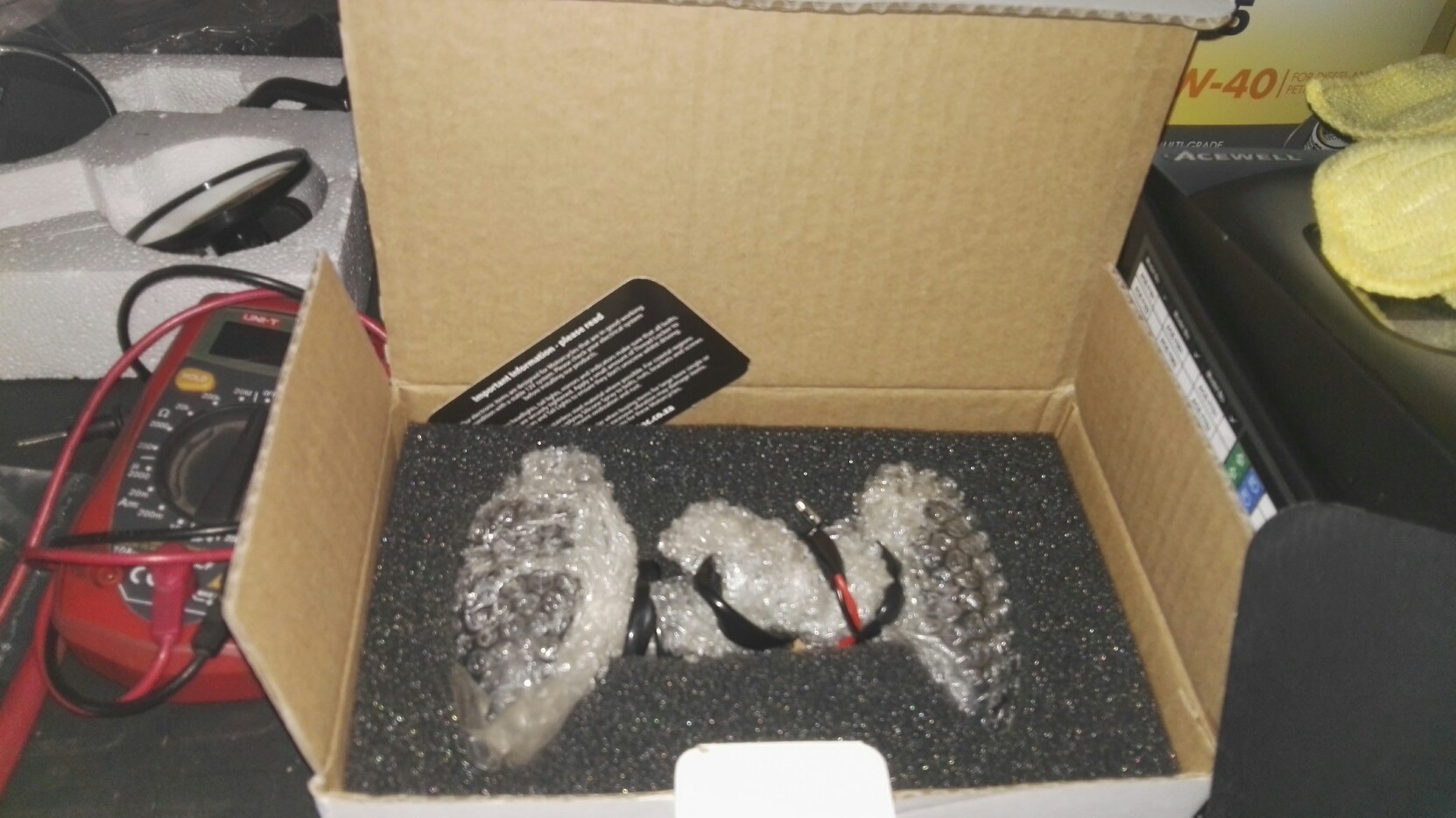

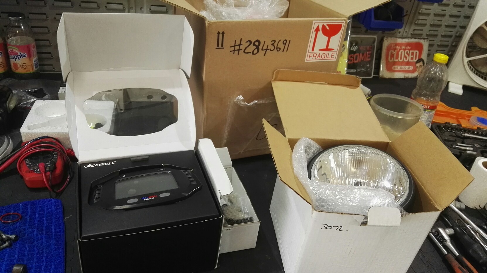

Some new parts

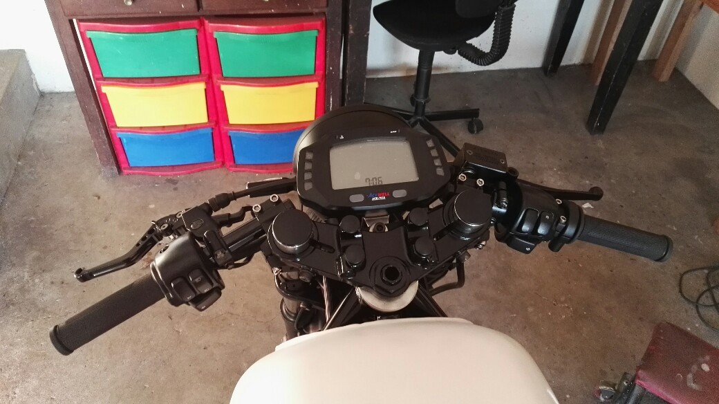

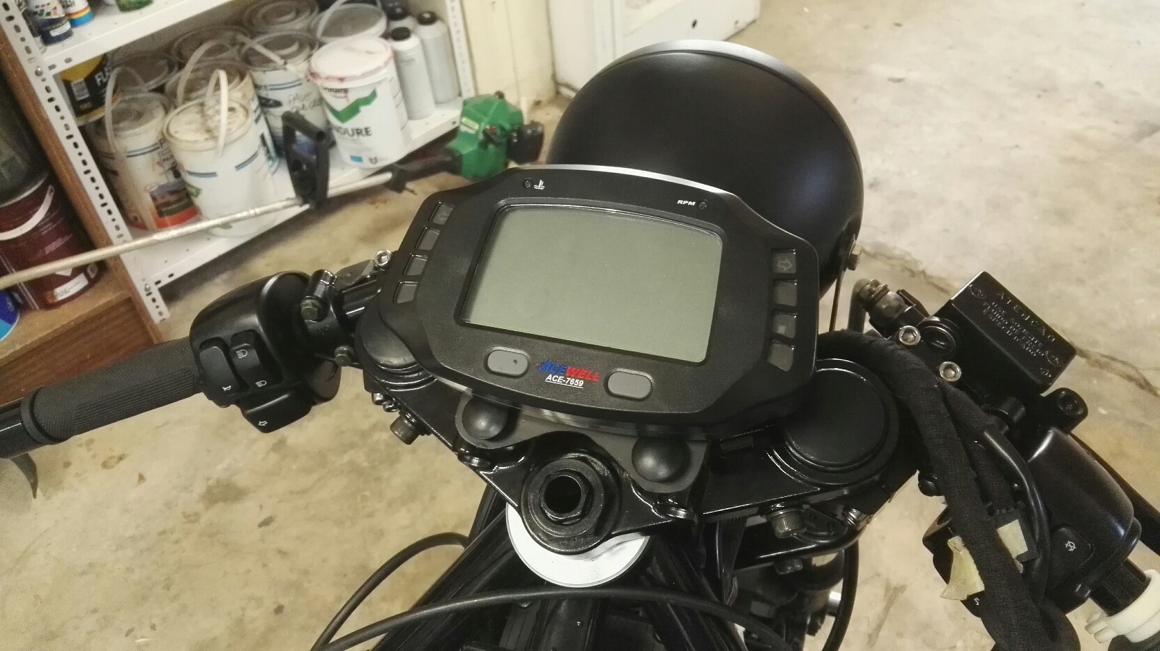

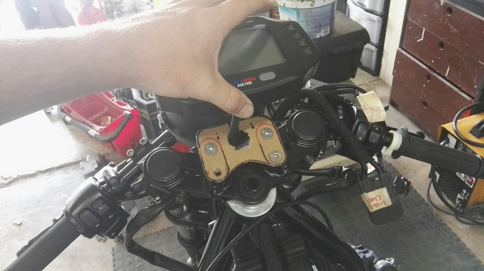

Bullet indicators

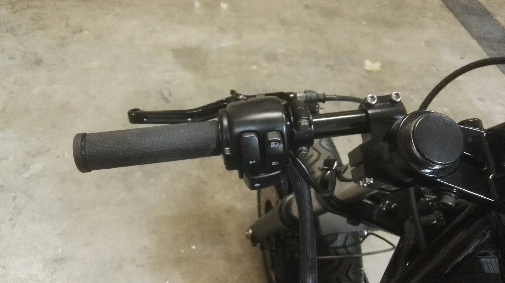

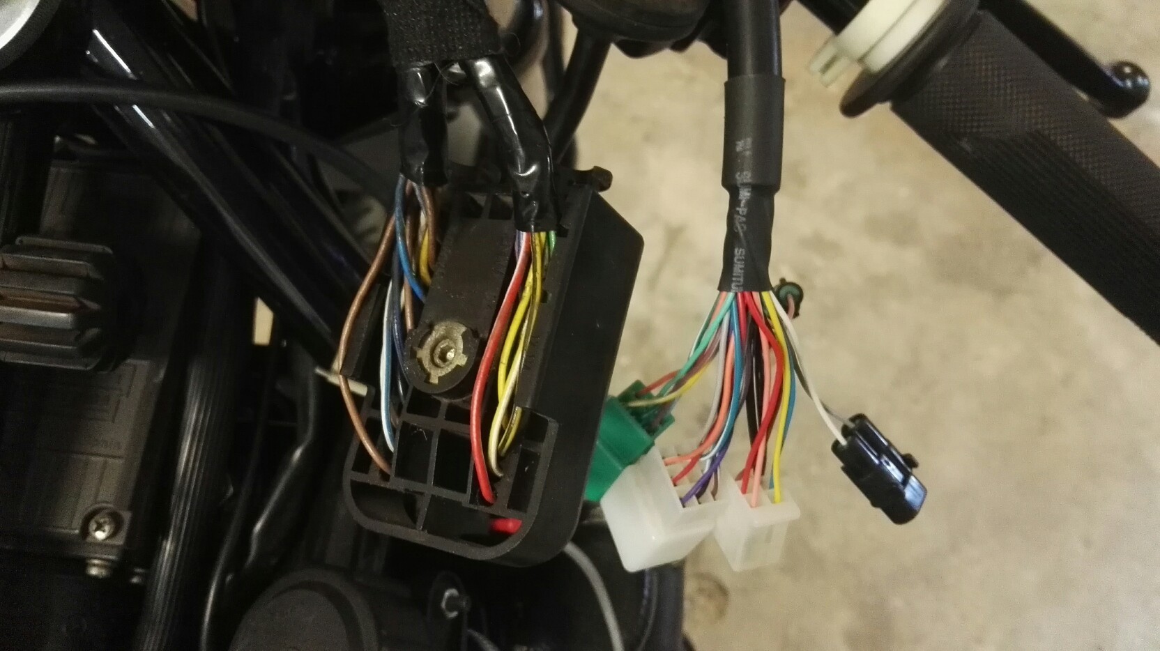

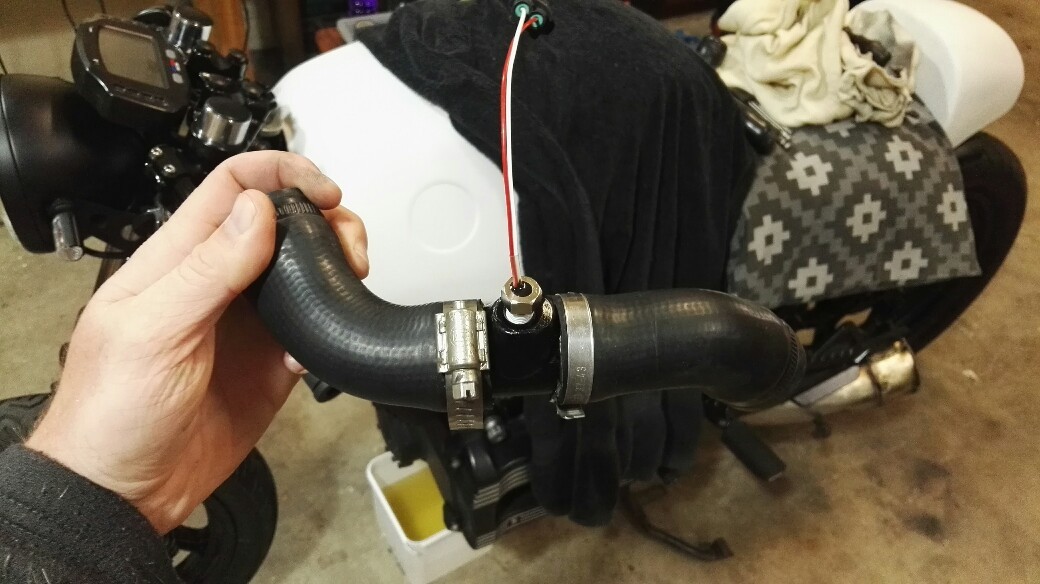

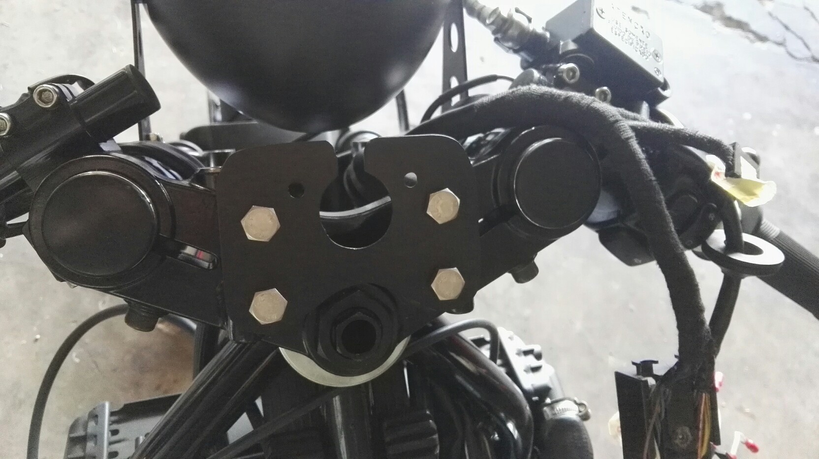

Left and right handlebar controls pretty much sorted. After much modification!

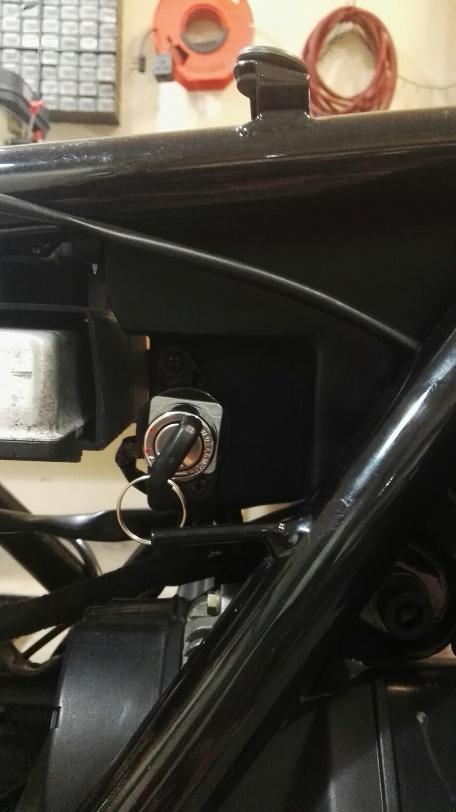

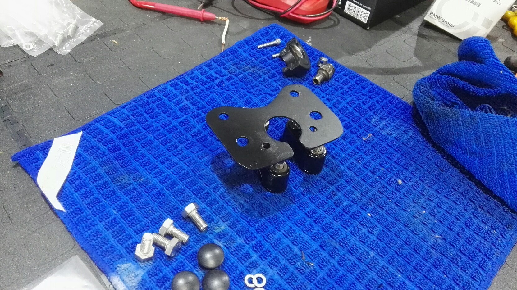

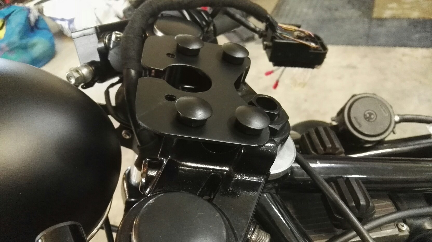

Stealth ignition/key installation

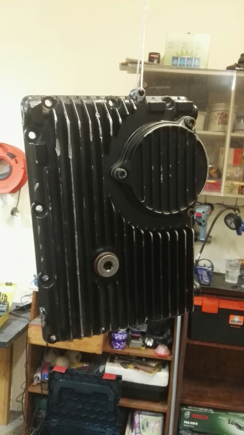

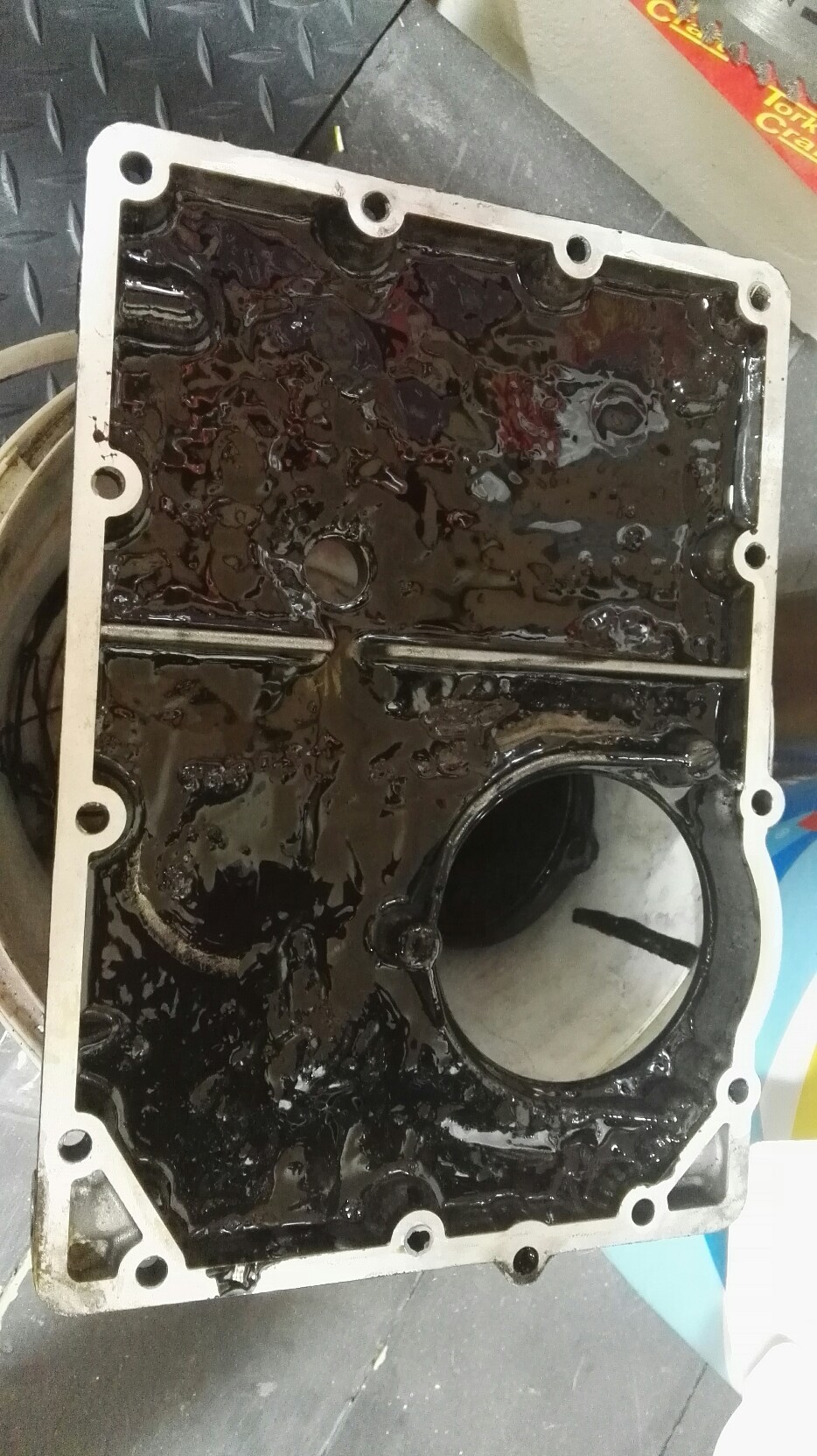

Oil sump removed, sludge removed and then a quick coat of paint.
Sorry forgot to take pictures after paint. A new oil filter installed and new oil.

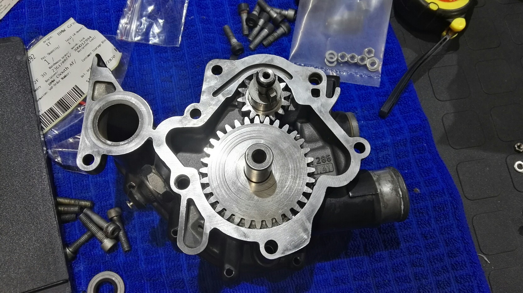

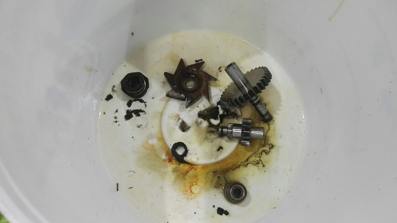

Water/oil pump was leaking from the weep hole which indicated that the oil and or water seal had perished. Bought new seals, spacers and o rings from bmw and rebuilt the pump. No more leaks, or at least nothing yet.

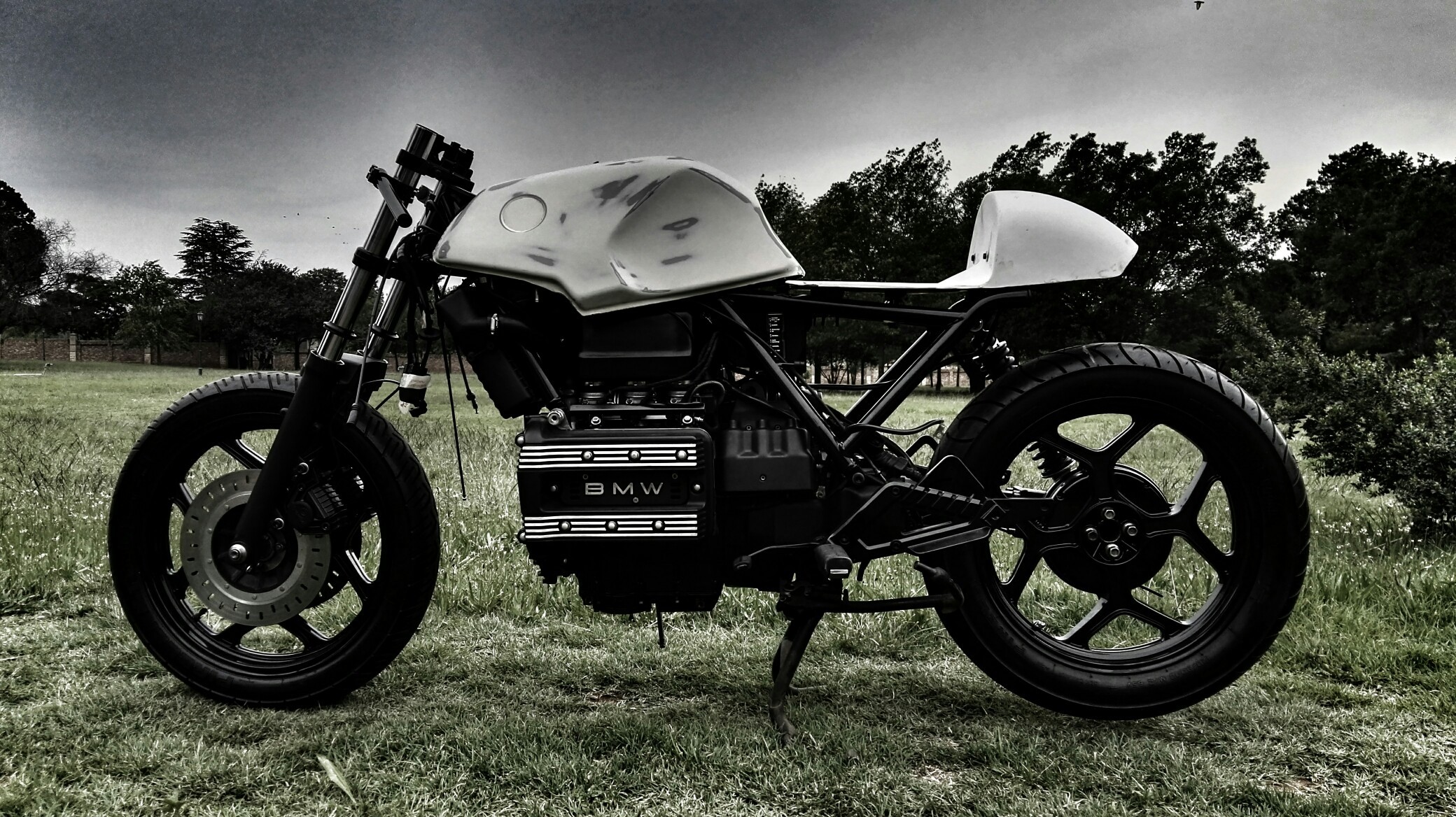

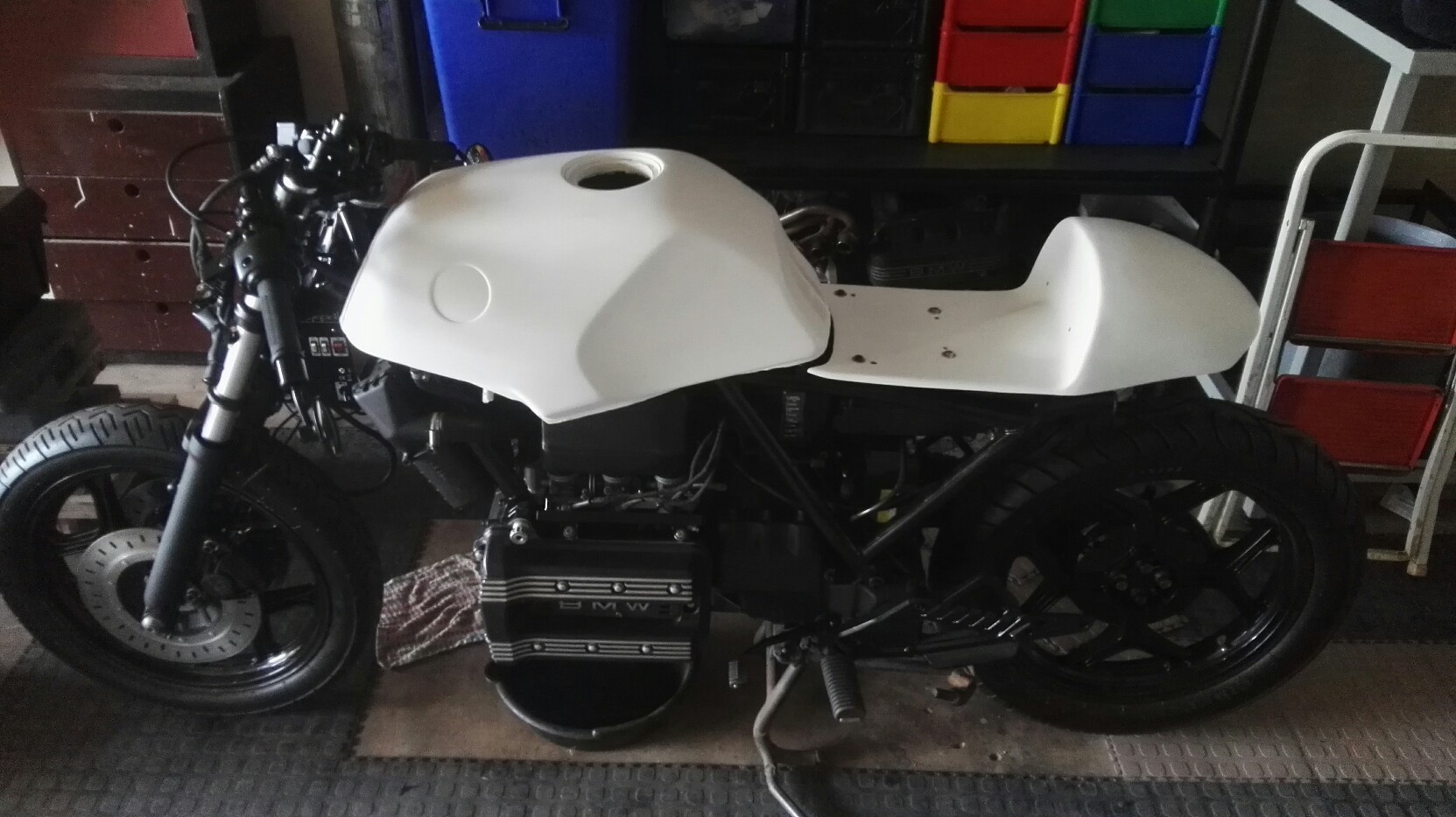

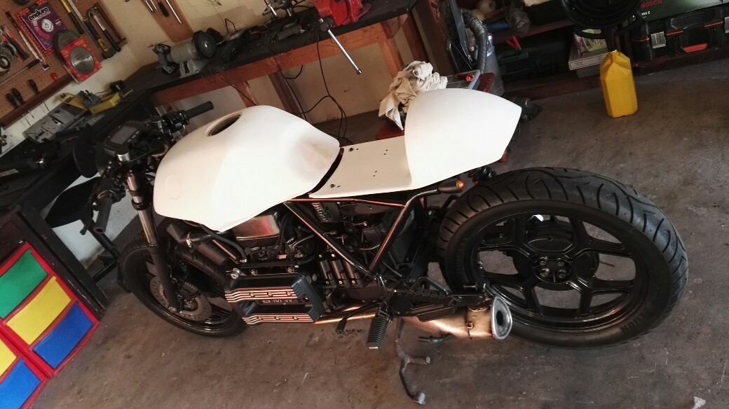

Gave the tank a layer of primer and the same go's for the tail piece
