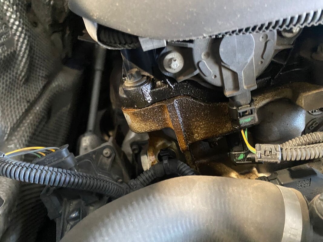

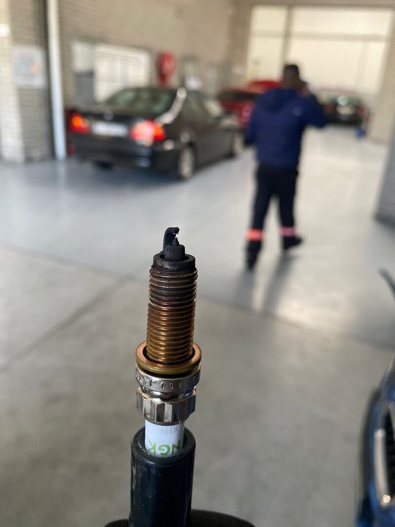

Thank you for the reply. I’m not too clued up but I will try. The car suddenly had this vibration and uneven/rough revving and a loss of performance. I have attached some pics they forwarded to me. Can you name those questionable entries and inflations so that I can renegotiate the quote? Any cent saved will help.

That plug they showed you is just carbon-fouled, which usually means a misfire or running rich. Could be a coil, injector, or even a small vacuum leak, all stuff that can be fixed without opening the motor. The oil leak in that photo is just the valve cover gasket, which is a common thing and not a big job.
