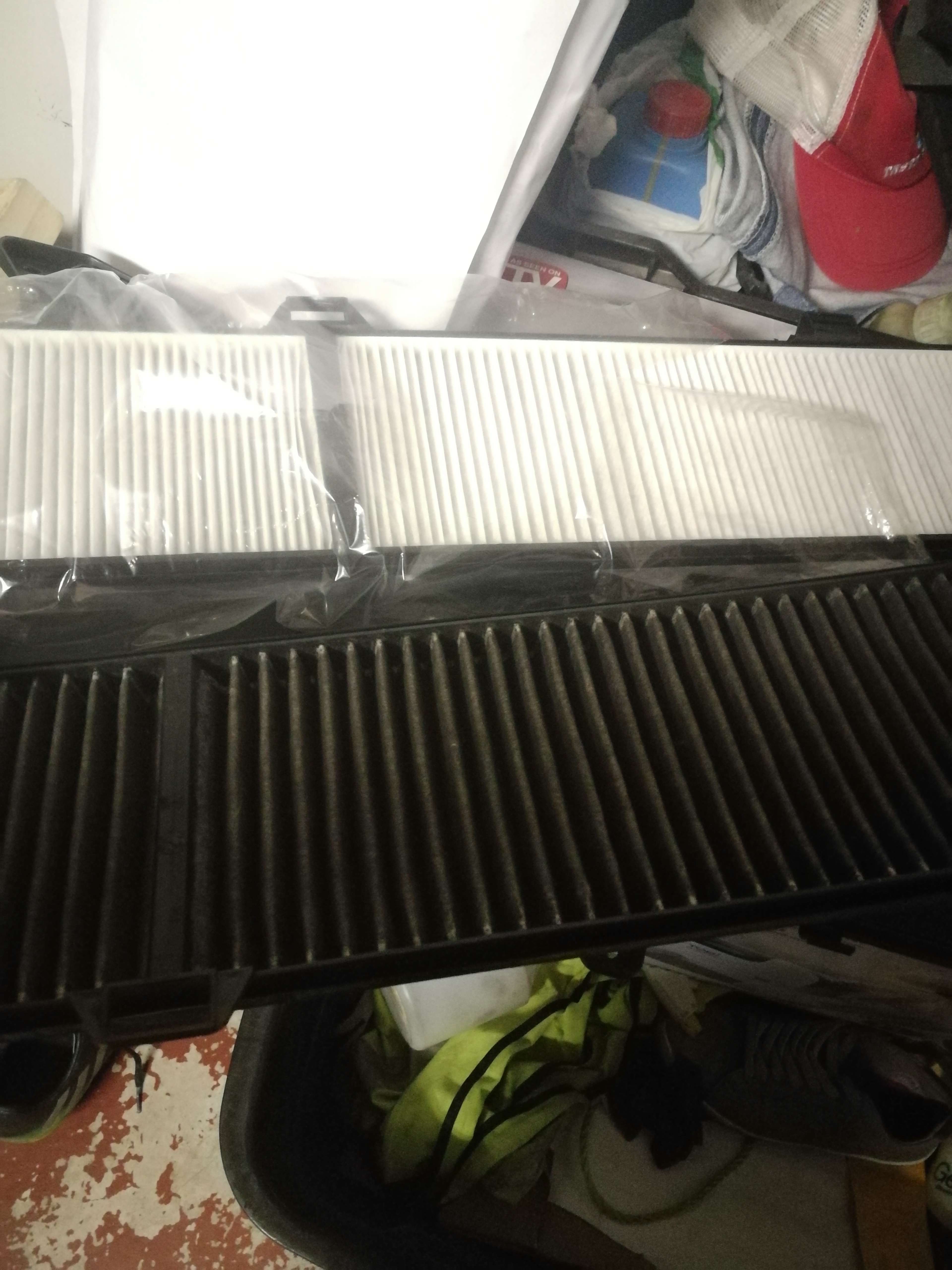

Moving on to April 2018...after suddenly coming to a realisation that I had not changed the air filter at my last service:faill:...I immediately fitted an oem filter and whilst I was busy...changed out the pollen filter.

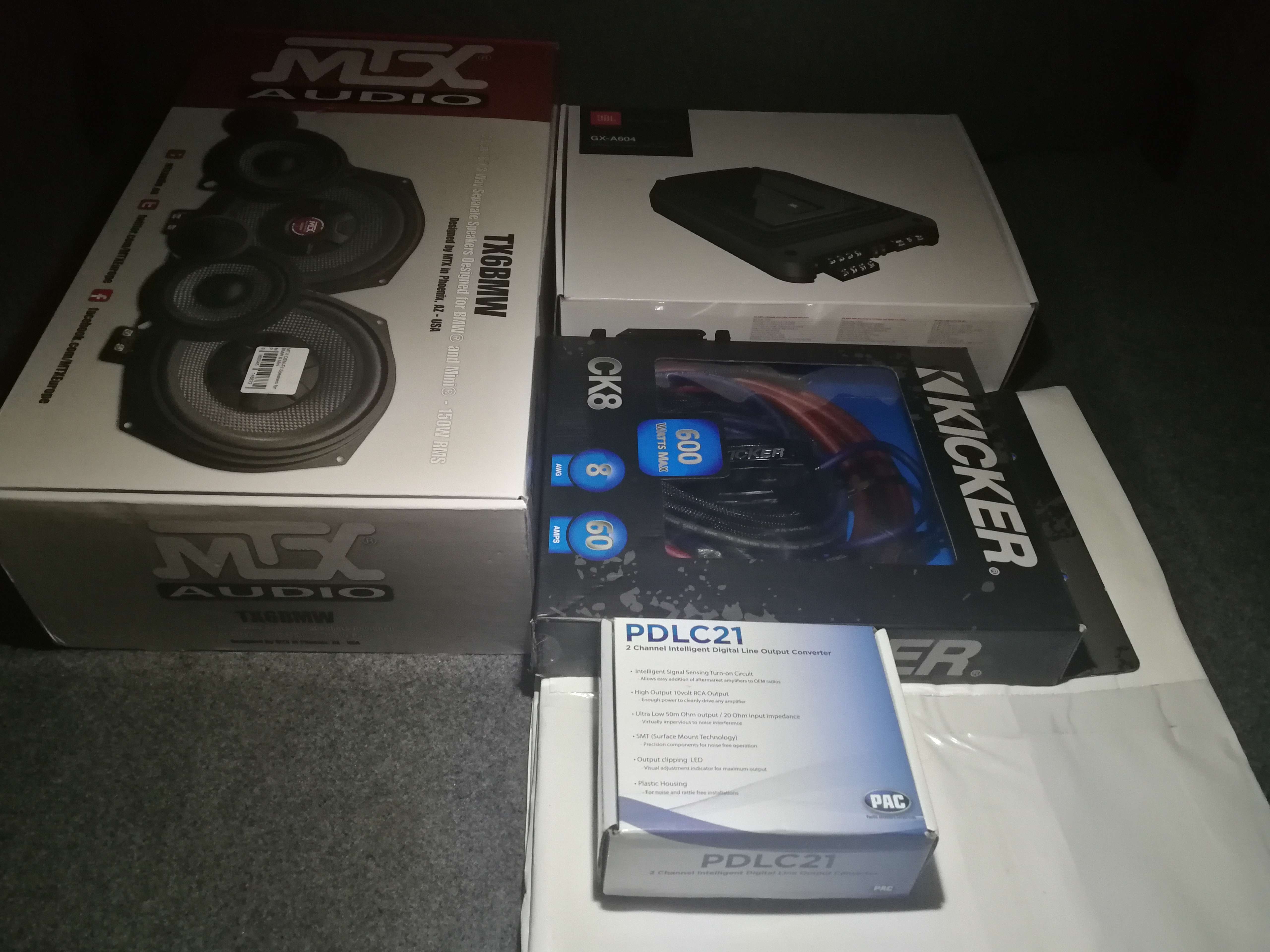

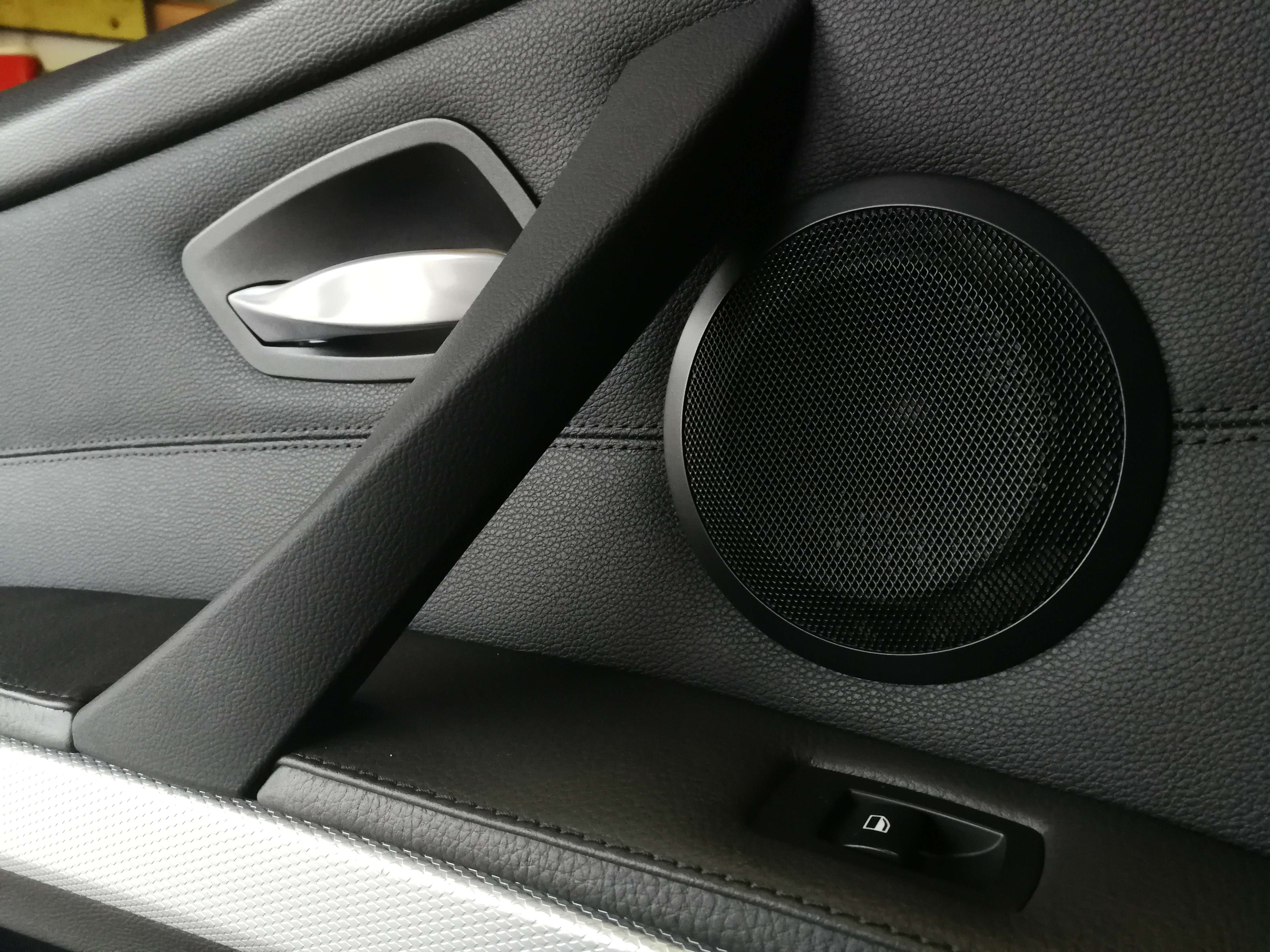

Skipping forward to the fun stuff (May 2018)...Finally pulled the trigger on the MTX TX.6 BMW kit:smilebounce: Since I had a sub previously installed..I already had the required accessories (oem tweeter sails, wiring, line out converters,etc), however, the Alpine pmx-f640 amp decided to burn out...I had no option but to source another amp, but this time around, I wanted to keep the install oem, So I searched for an amp that fits the stock location in the e90 which meant I also had to source the slim trim piece to cover said area. The JBL GX-A604 met the fitment and budget requirements:thumbs:

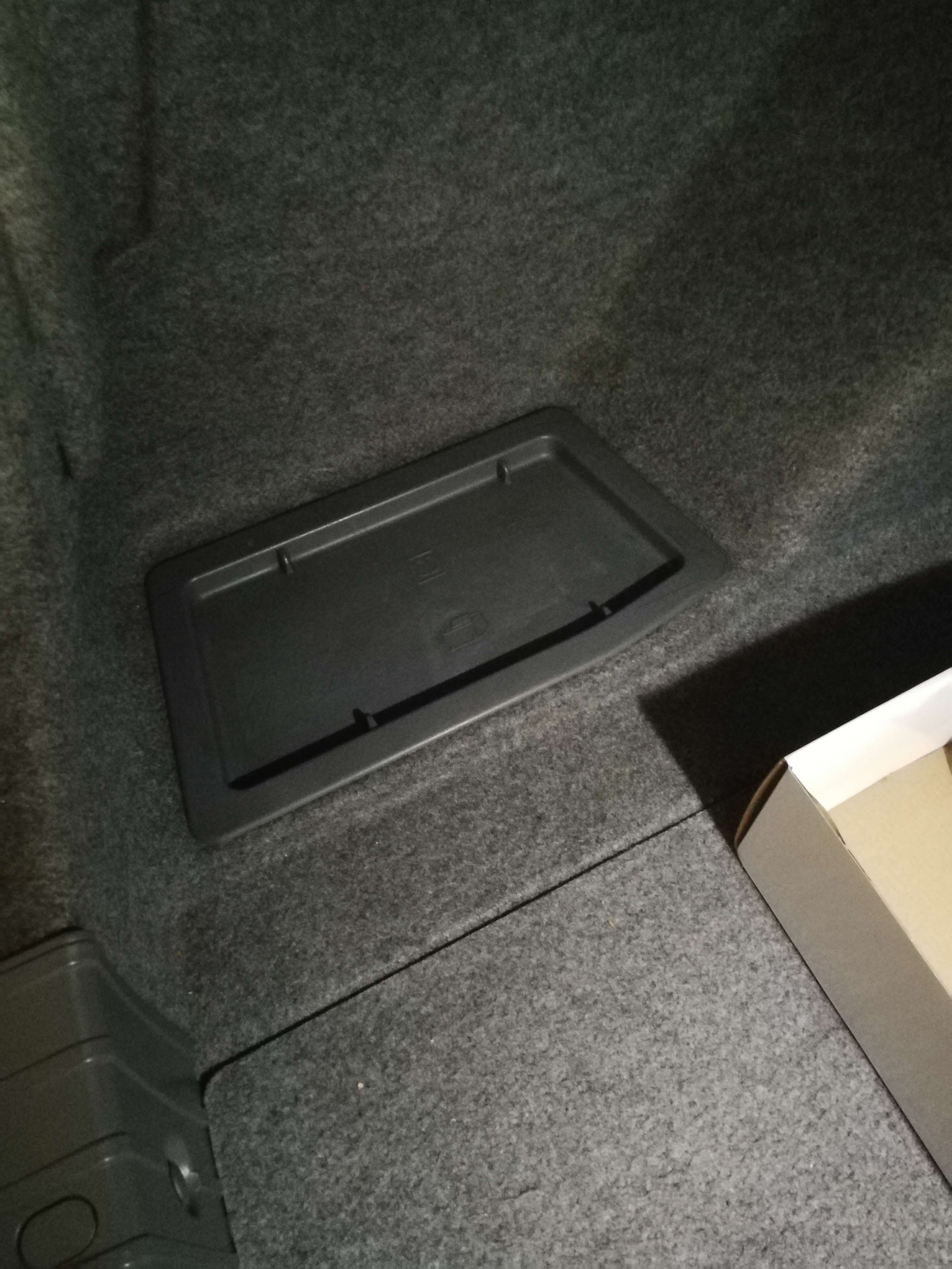

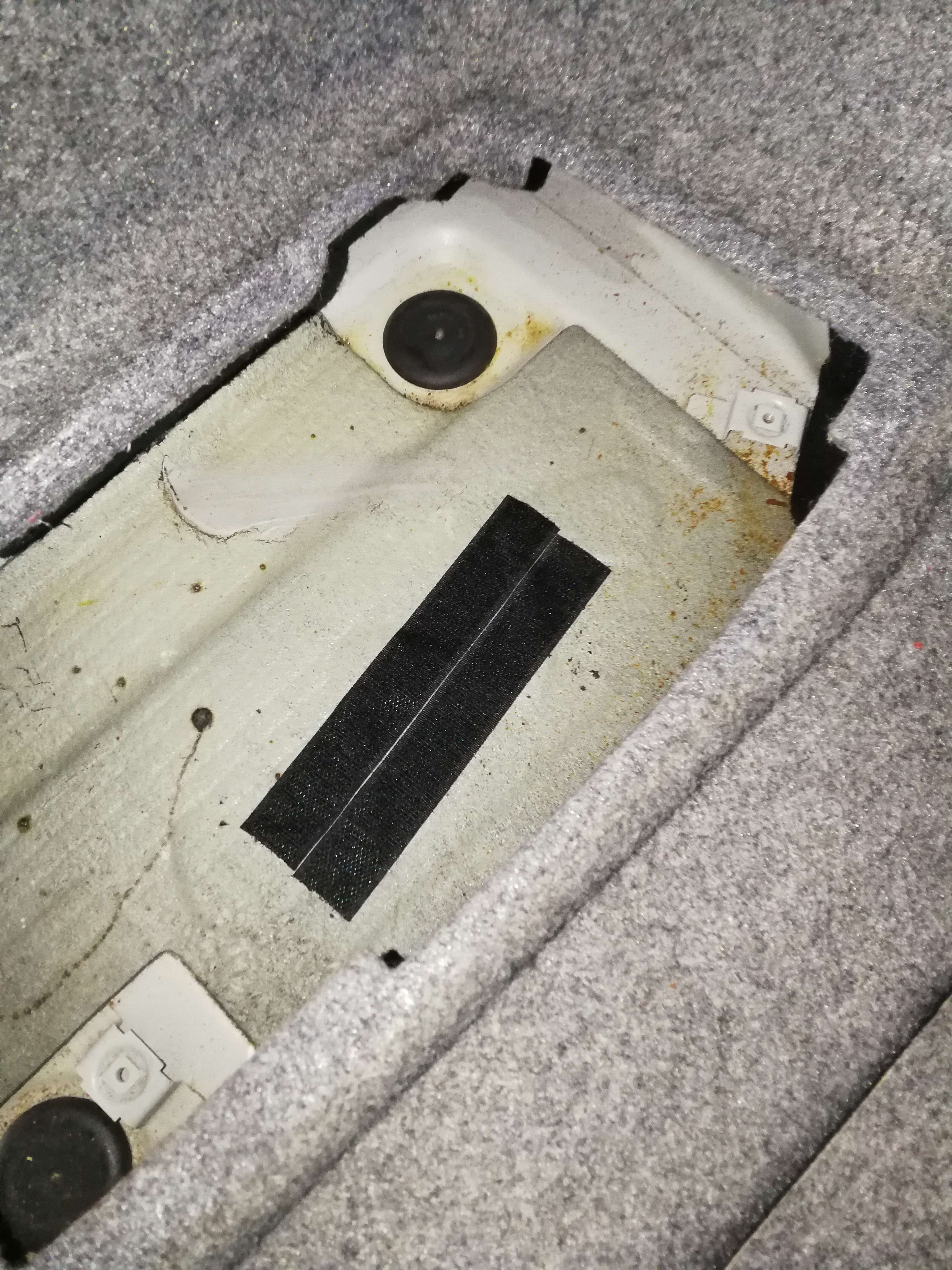

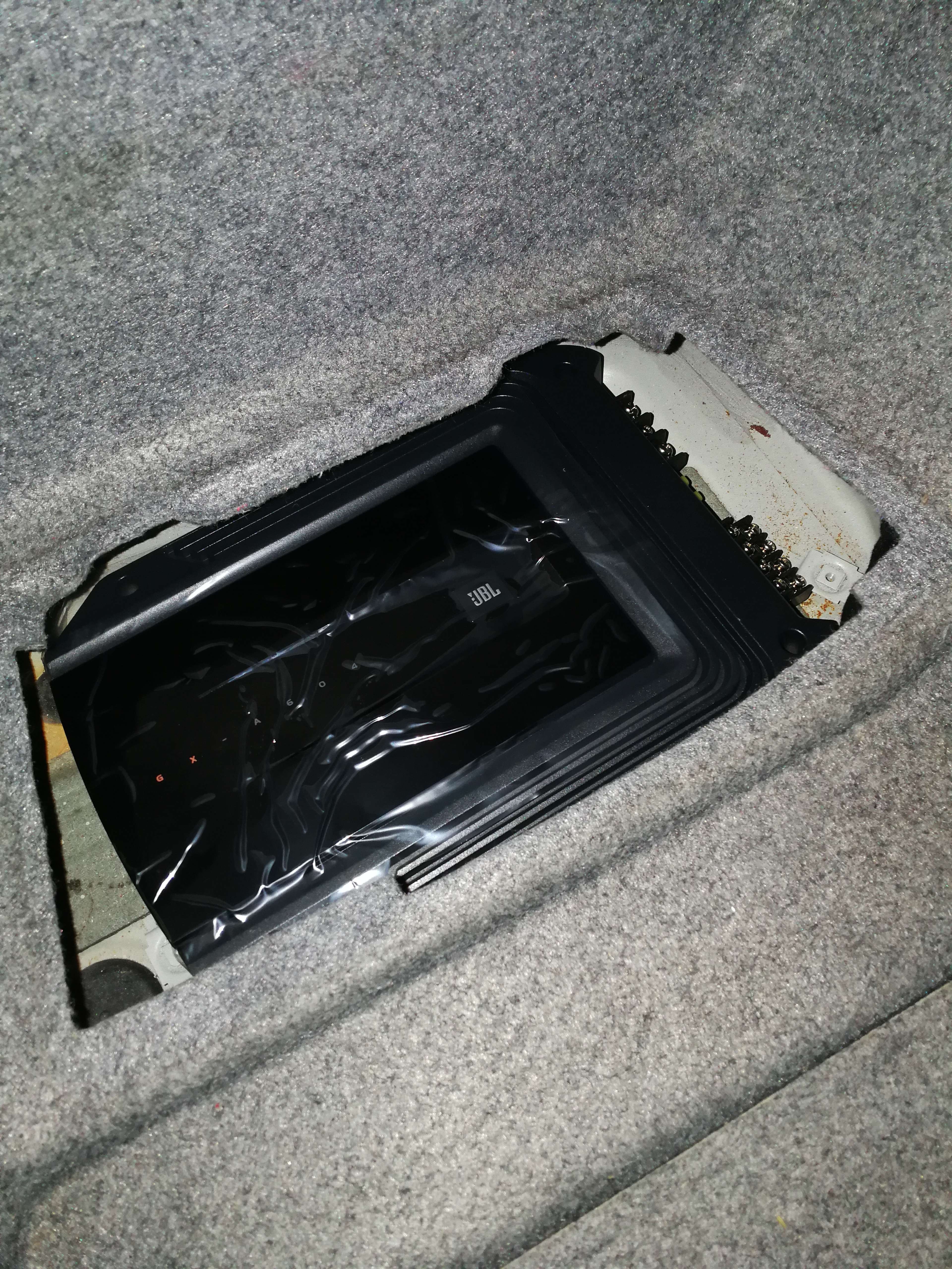

Did a test fit, stuck some velcro tape just to keep the amp in place...with everything wired up...its pretty snug, I also stuck some sound deadening to reduce any vibrations from driving...
Quick Review of the MTX kit
Items:
1). MTX TX.6 BMW
2). JBL GX-A604
3). PAC PDLC21 Powered Line out converter
4). Kicker CK8 wiring kit
5). STP sound deadening
The speakers are of a good build quality and are extremely lightweight thanks to Neodimium magnets (I suppose). From what I gathered, they are not "plug and play", yes the speakers fit the stock locations with no hassles, but the underseat sub connectors have to be cut...well, unless you run a whole new set of cabling.
The JBL amp offers good sound quality as one would expect, thus far, I have had zero issues with the amp, heat management is good (in fact, its way better than the Alpine amp mentioned above..even though it is in a rather tight space). After running in the underseat subs, they can definitely handle more power than the JBL amp can dish out, also, the GX-A604 does not have an adjustable crossover for the front channels...so I am stuck with the basic crossover points.
The PAC lineout works great, it has signal sensing so turns on when the radio powers up and has a gain adjustment so the volume of the radio matches that of the amplifier which is great cause my rear speakers are powered off the radio.
Not much to say about the Kicker wiring kit...other than its quality, you can feel the weight of the cables compared to the cheaper autostyle kits.
The sound deadening...well I did not want to regret not adding this, used 3 sheets in total...front doors, underseat sub enclosures, and abit around the amplifier...I must say, it does make a difference, the cabin is quieter ...You notice the difference a lot when the tunes are bumping (for lack of a better word) and you close a window and its almost total noise isolation. Also, even though the sound inside the car is way louder than the stock system..its quiet soft if you stand outside and the doors are shut.
Overall Review
The kit sounds great...you can not compare it to the base sound, highs are not too harsh and the bass is good, in my opinion...its a balanced sound experience, In terms of bass performance, I would say its slightly better than the logic 7 underseat subs:fencelook: . The system does lack the bass provided by a proper sub, personally, I think its more than sufficient:=):
For the money, I do think you can get better quality speakers, which will require some custom fabrications and a much better amp...therefore resulting in a higher budget, if you are just tired of the dismal base sound ...then I can highly recommend this kit.

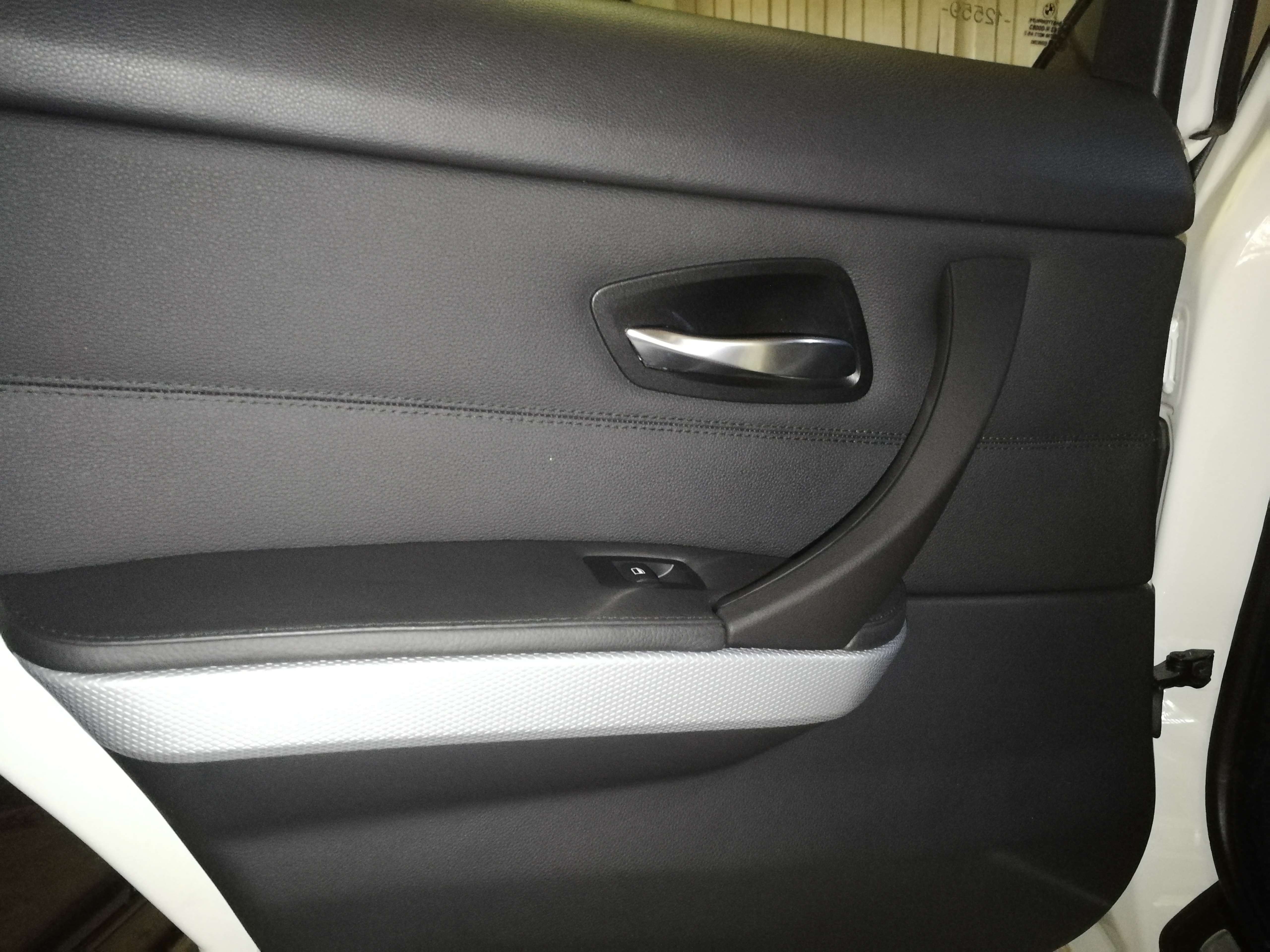

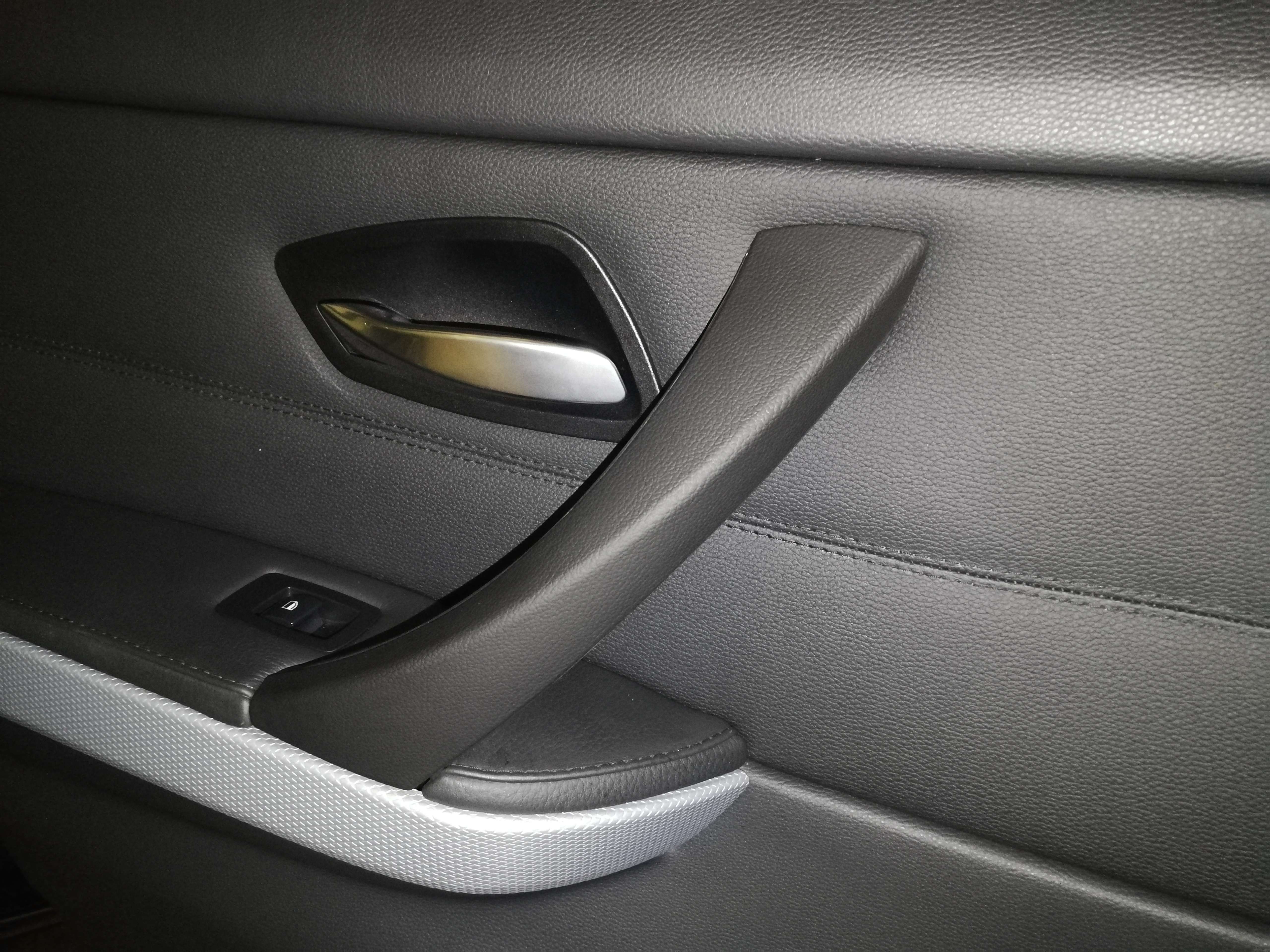

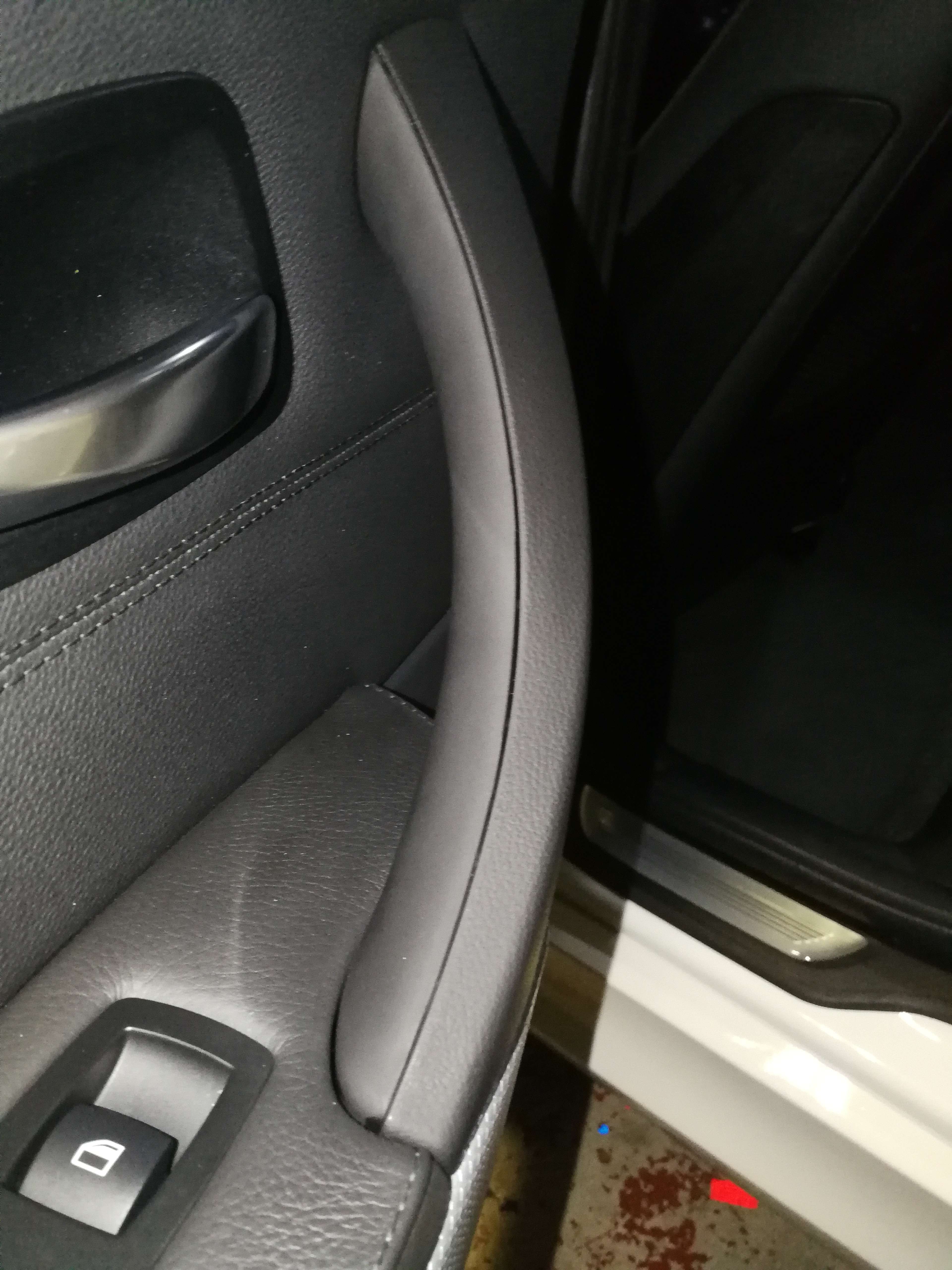

Something that has always annoyed me are the infamous e90 melted handles, which started melting like 3 years back...Generally I dont carry passengers and my SO is aware of the handle situation...I never got down to replacing them cause there isnt a handle on the drivers door (and after checking the cost at the stealers:skit:), but on the rare occasion I had to take a passenger...It has always been rather embarrassing, and because its human nature to reach for the handle, telling them not to touch never worked:dunnoanymore:
So after the revised (does not require the handles to be plastic welded) replacement kit became available online...I took a chance and ordered a full set...it took a rather long to arrive from China...and I finally made some time today to fit them:smilebounce:
Looks oem, and feels good...no more stickiness :bravo: I will put together a separate thread with links to the items and installation process:thumbs:
