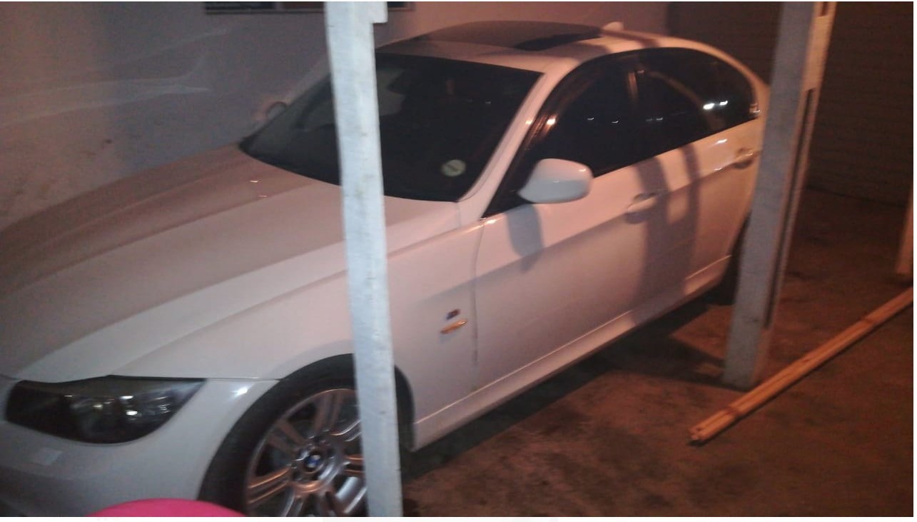

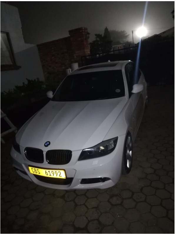

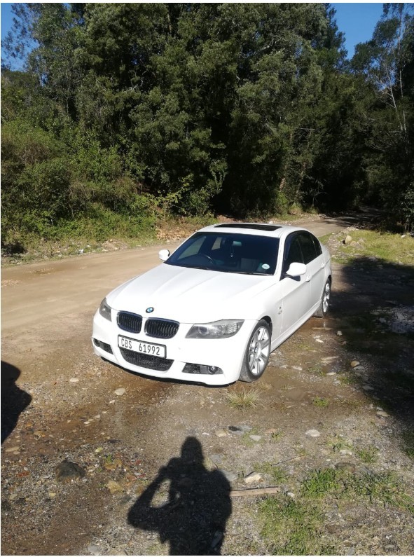

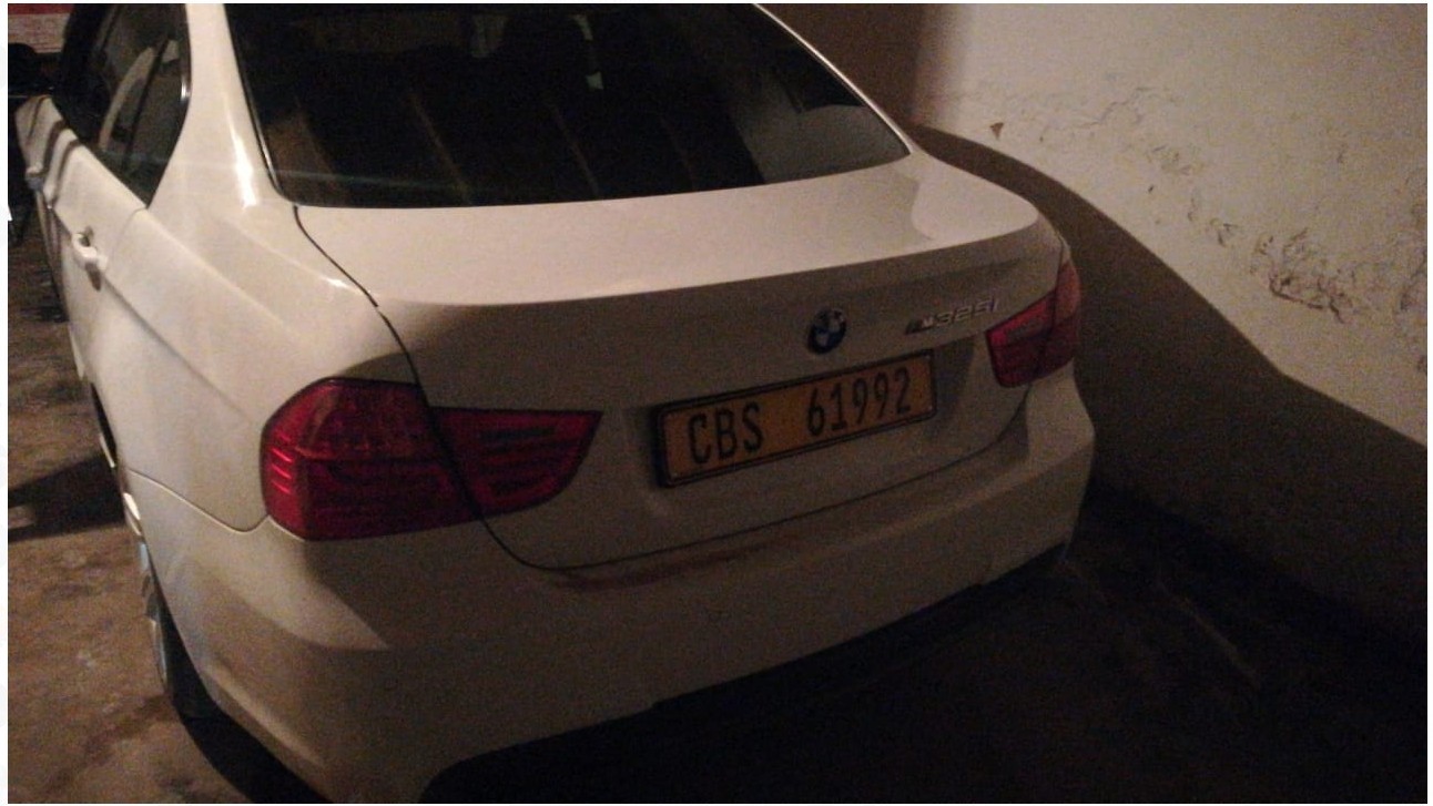

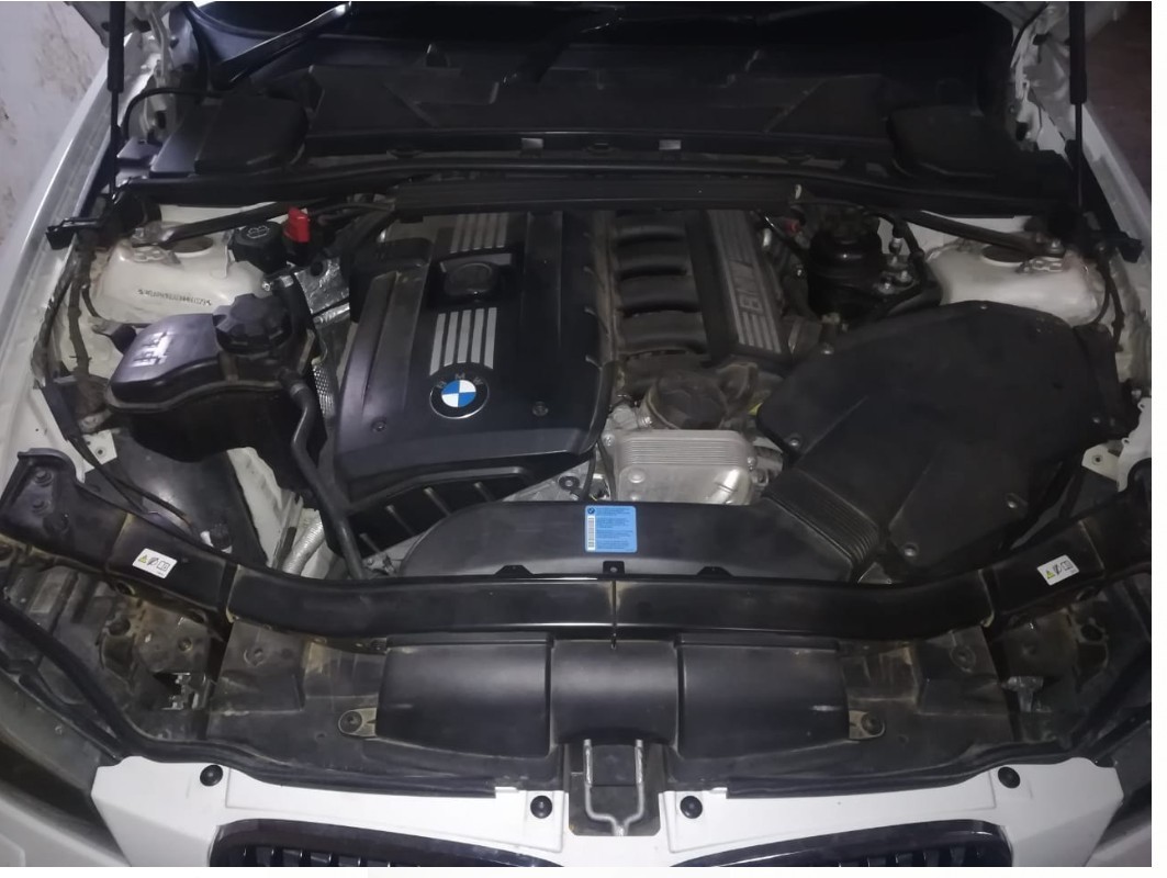

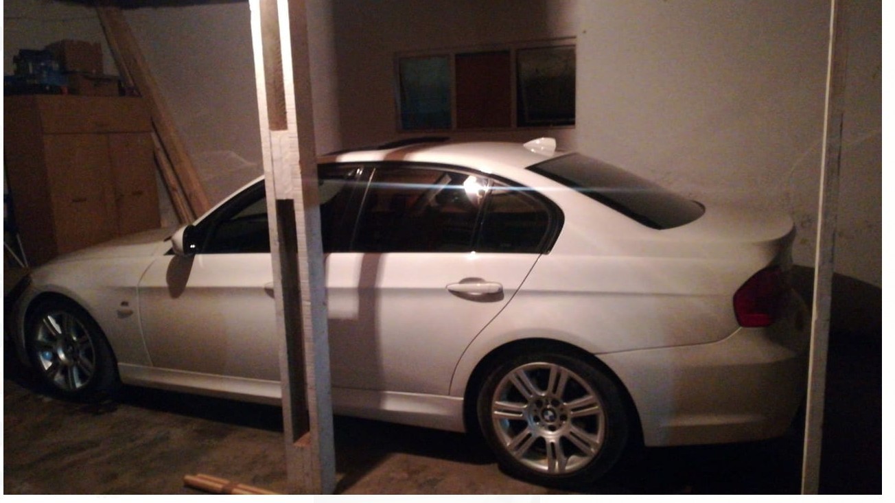

good day, gentlemen. I need your advice my brother is interested in purchasing a 2008 E90 325i auto sportpackwith 170k on clock. ive attached some pics and would like to know what are some of the pitfalls he needs to be aware of when going to view the car. I already hav a concern that the sportpack wheels are not period correct for the facelift but also think that it could've been a choice to rather go for the pre facelift rims... your opinions and advice wud be highly appreciated

The rims are not and issue. They could've been speced that way. Check for service history. Ask Coisman on the forum to run a check for you on the history on the car. As for the E90 325, just search around the forum and you should be covered. :thumbs:

I've seen those wheels on LCI models so it's probably fine. I stand to be corrected.

Also the wheels are correct, that's the 17 inch msport wheel.
Dr Evil
Wheels are not an issue as mentioned, I have a 2011 330i sports pack and it came with those same wheels.
