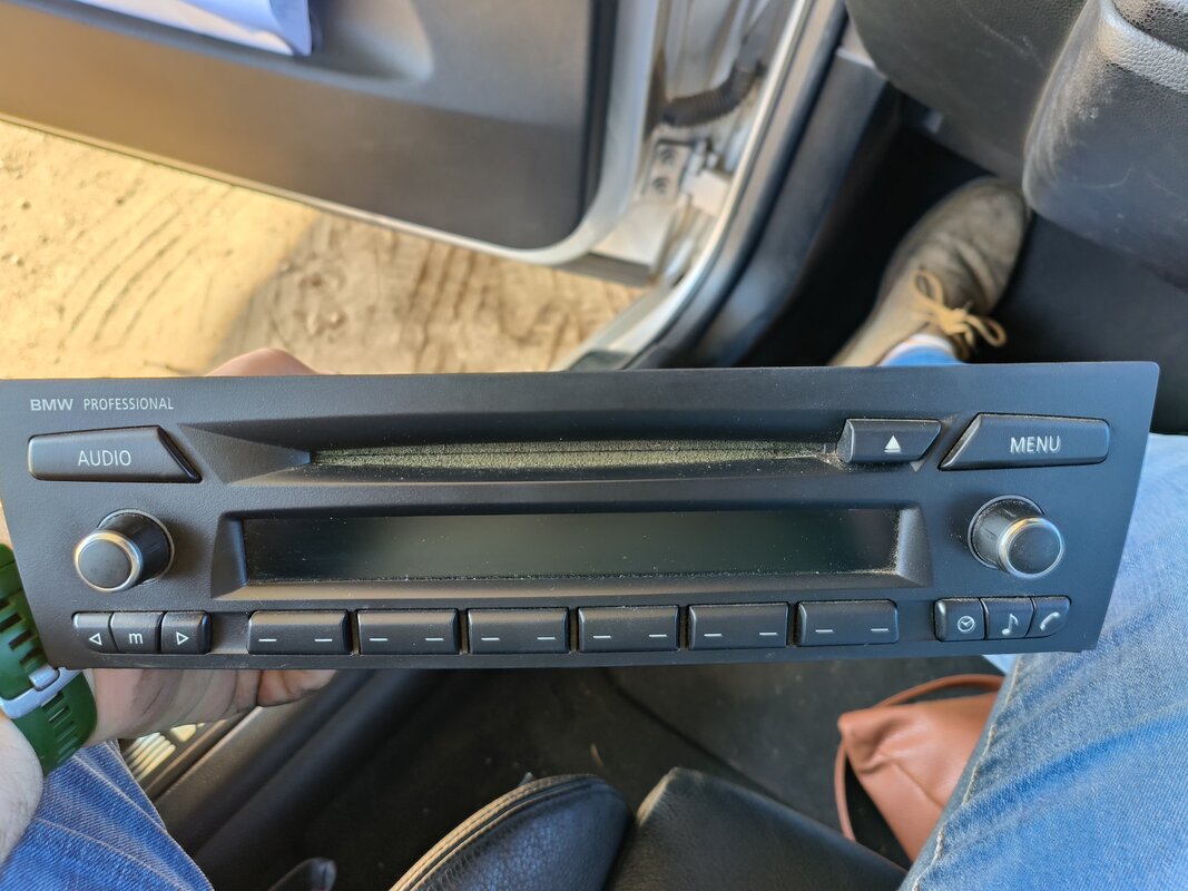

Long story short. The Head unit oneday gave a Hi temp warning and we couldnt do anything just silence.
When we got home I dsconnected the battery in hopes it would restart the radio instead it did the opposite and the radio doesnt work. Doesnt turn on Nothing.
Its about a year and half later and still the radio doesnt work. Recently with a bit of bucks we went to Beeline to try a second hand unit and we tried about 3-4 units with the same where it just doesnt turn on.
I facebook market place one and the owner upgraded his radio and swore his was working I put it in and still nothing.
Please someone give me advise or what technical stuff to check. I was hoping to use ISTA D or INPA to see if it is a module or to test someway or somehow maybe someone here has expereince or can point me in the right direction.
It is at a point now where I am going to buy a android unit and have a company fit it but then we lose the AMP and factory sound etc. As the AMP works with the optics.

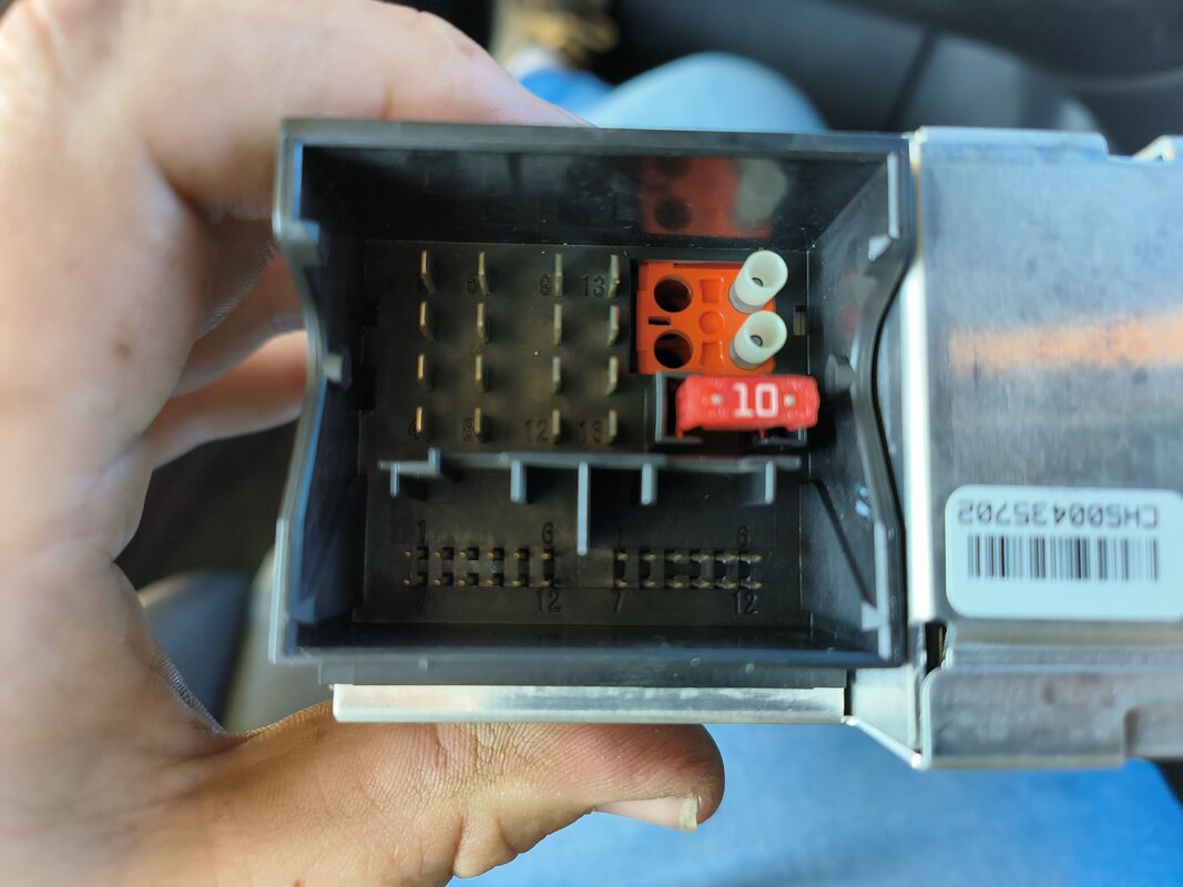

ID like to have a final crack at it and was thinkking to test the 12v at the Headunit or put an alternative source of 12v I know on the pins there is continious 12 volts and then also ignition 12v pin 15/16 something like that.
Maybe it is the amp located in the boot? Which I will also strip the boot liner out and have a look. If it is getting power optic etc. But maybe someone can assist or point me to someone who can assist So annoying..
Things that dont work along with the radio are:
1.PDC dont beep no more.
2. No warning Chime for example when seatbelts are off.
3.No Alarm sounds or beeping or siren.
The strange things is when I turn on the headlights the radio backlight comes on?
Please help me. My poor partner drives 50km/day in silence.
OH AND YES I CHECKED ALL FUSES AND EVEN REPLACED THEM INCLUDING THE ONE BEHIND HU.
