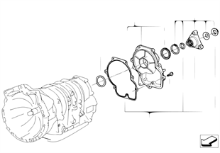

The car originally came with the GM A5S360R transmission,
As far as I can understand accourding to the comments the GM A5S360R was not rated for the power of the 330D, explaining the failure of there transmissions?
There is another option, I can get a local GM A5S390R transmission from a low milage 2005 X3 3.0 that was side sweeped. (I know the car and know it was treated well). Accouding to research on "google" the A5S390R transmission is rated for 30% more power than the A5S360R.
I see the A5S390R transfer case can be removed and replaced with the output shaft from the A5S360R making it a straight swop in theory.
But have anyone ever done this UPGRADE?
DieselFan
A5S360R - 360nm
A5S390R - 390nm
I think even some 330ds came with the 390 or it was the 530ds.
As far as I know they have stronger 4th and 5th gear shafts or something.
You may still have this problem, its not even 10% stronger.
You can give it a shot but its still coming off a second hand car.
