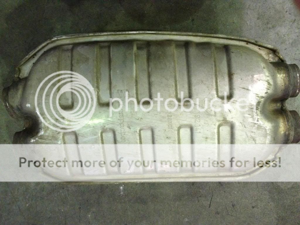

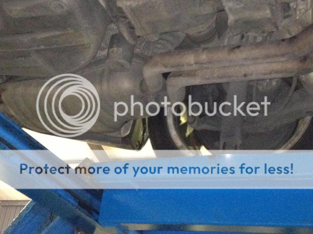

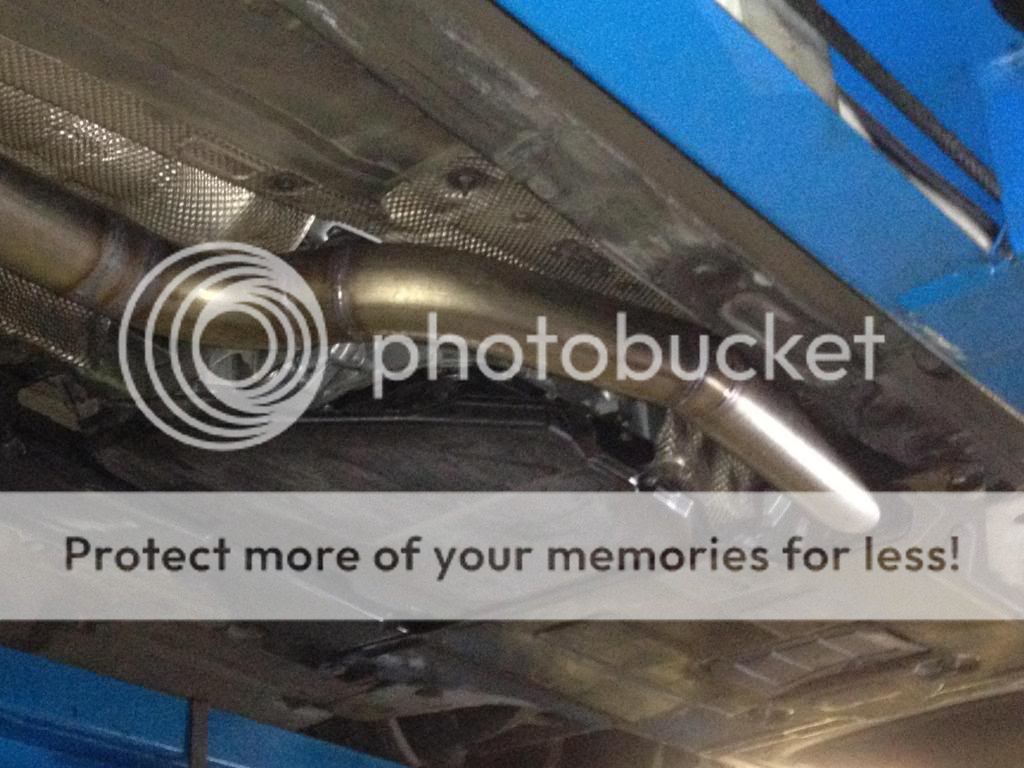

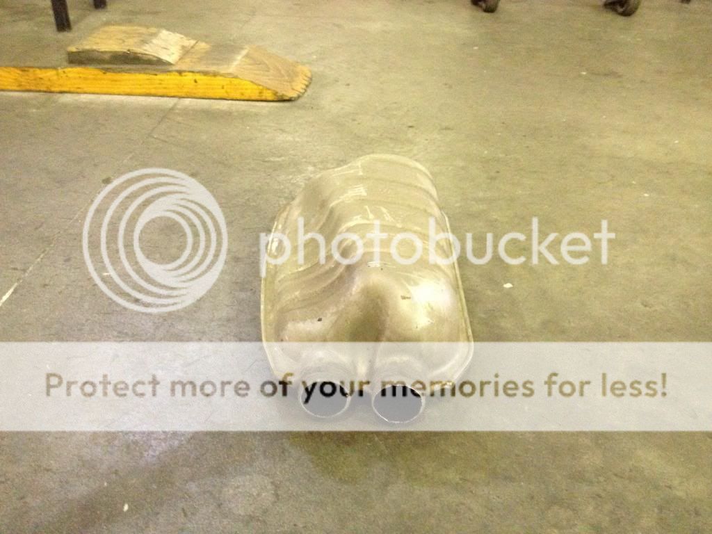

pics plus words
76mm downpipe
2nd last from rear silencer removed
Replaced with 2 straight pipes going in to last big ass silencer
This one is fooking heavy
