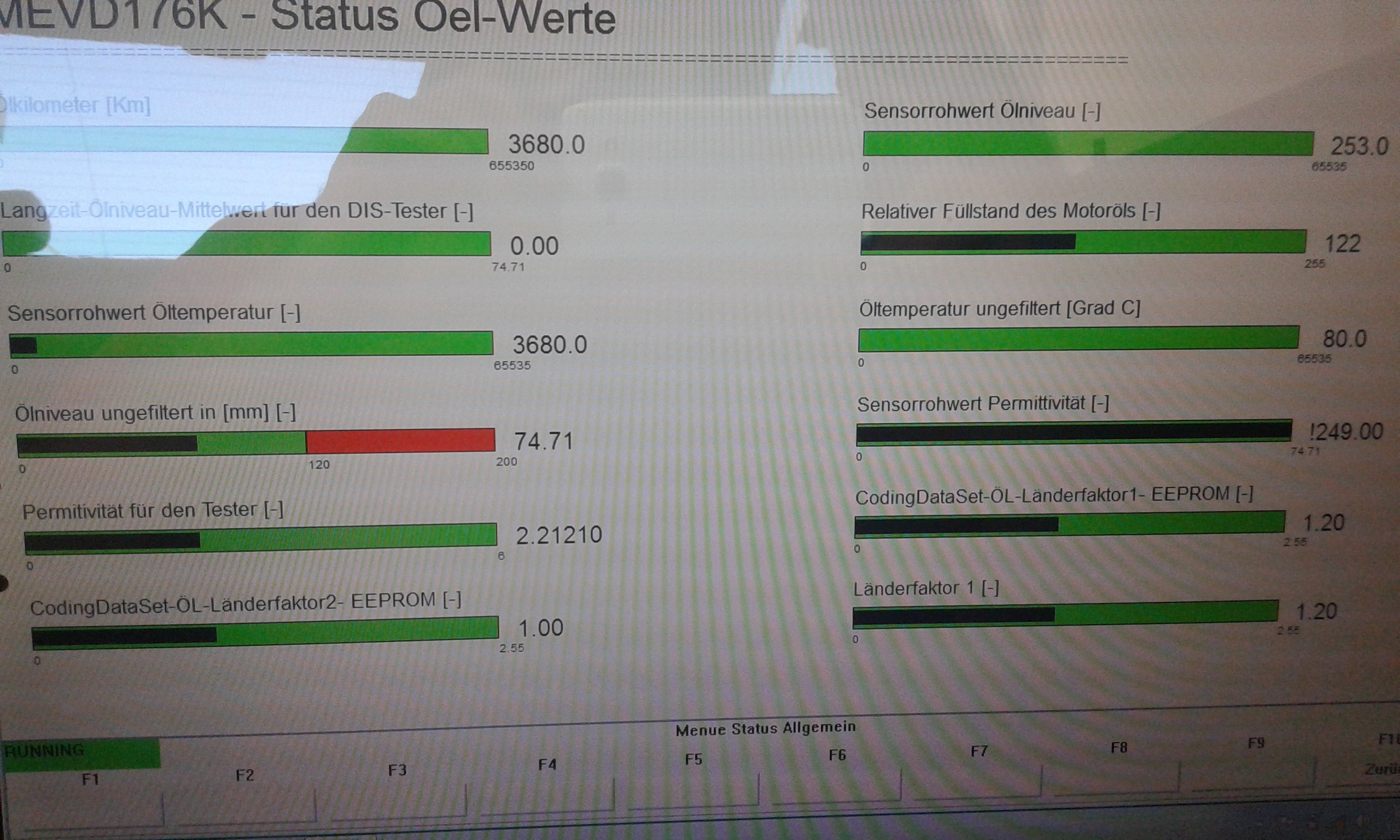

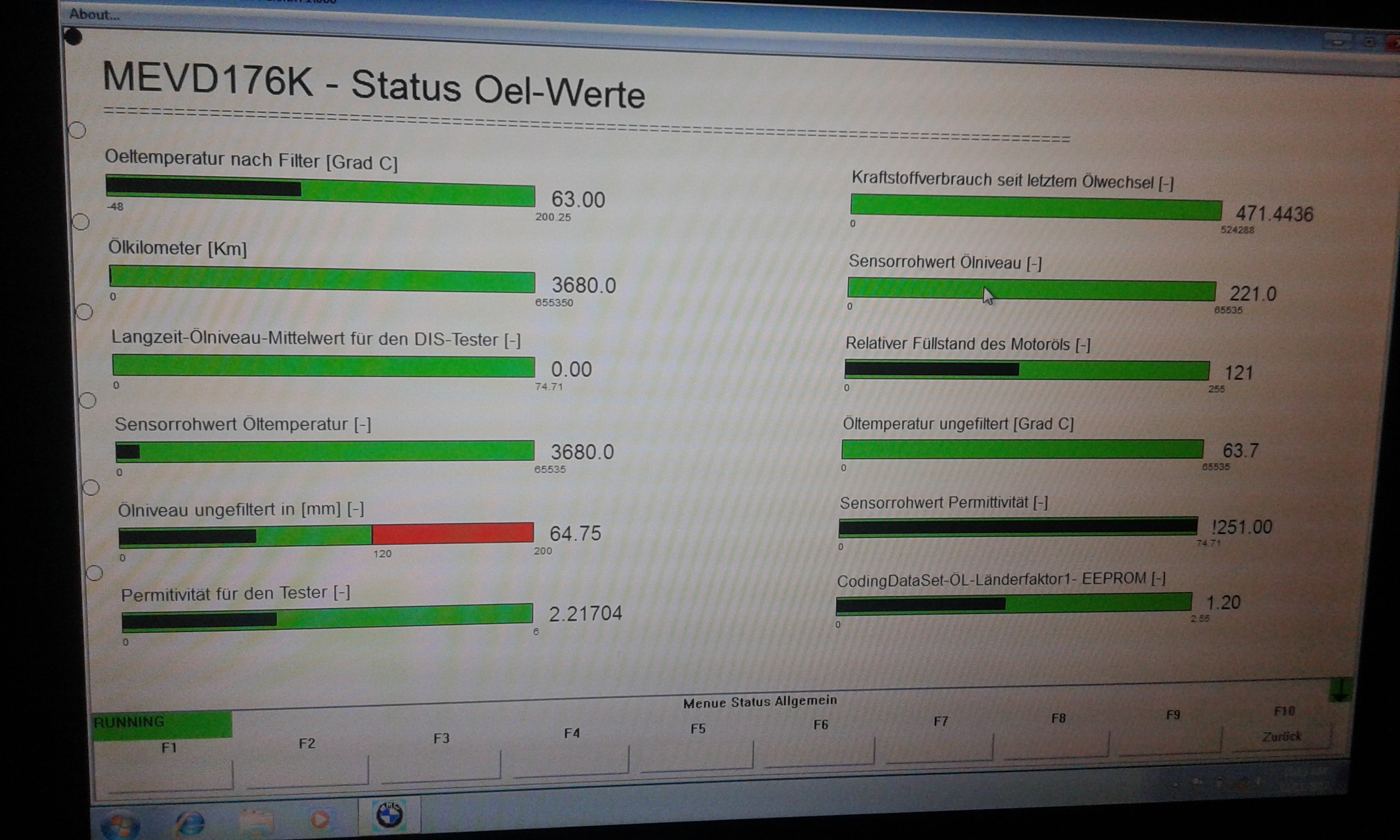

Hi, need the help of the inpa/toolset/ncs expert help. For a while now my 135 have been showing full oil level always, if I do a oil change and add 5.5 liters and drive around it will still show max level. I change the level sensor with new one and still no change. This weekend I got inpa to work and I saw a oil level in mm and it was showing the level that I measured by draining and measuring the oil. In inpa I see a 2 codingset data factors, one is 1 and the other is 1.2 so I guess it uses these factors to modify the actual reading and showing this in cluster. Is there a way to change these factors in toolset or ncs?
the top pic is when engine idle and bottom when engine off
