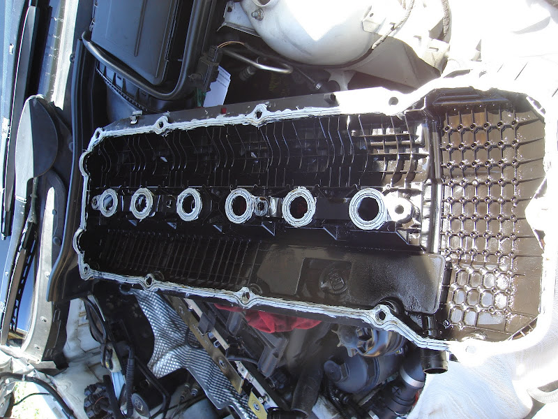

After her brake I started stripping my car. The fan clutch came off easier than I thought it would. All was going well and got the valve cover off too find this:
Now that was a new valve cover put on a a month ago. Clearly the place where I had the car will never see me again. That amount of sealant would have made me wonder if they did but a new one on but I did get the old one as well.

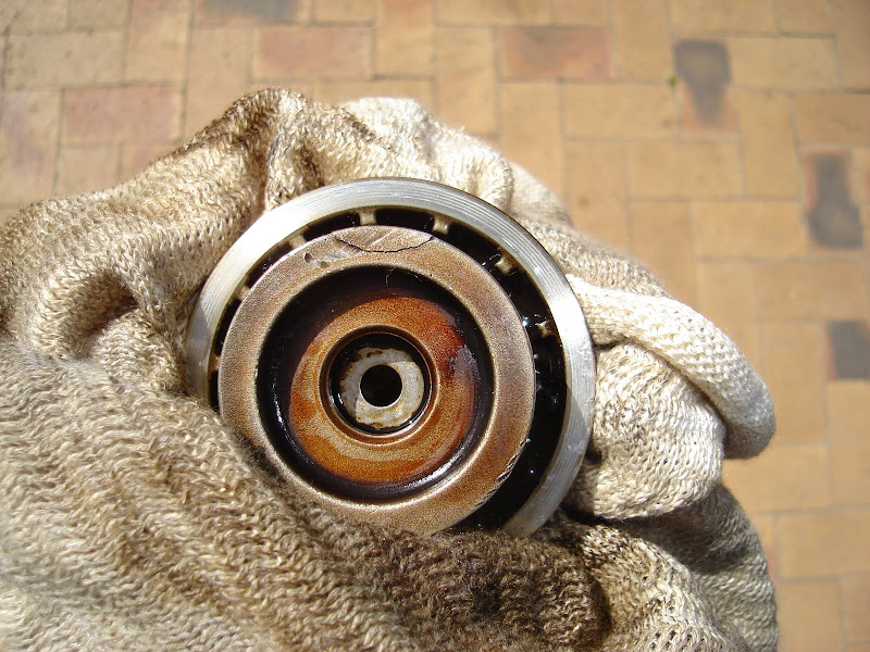

Got the vanos off and found this:
Now help if I'm wrong but this is not too critical?

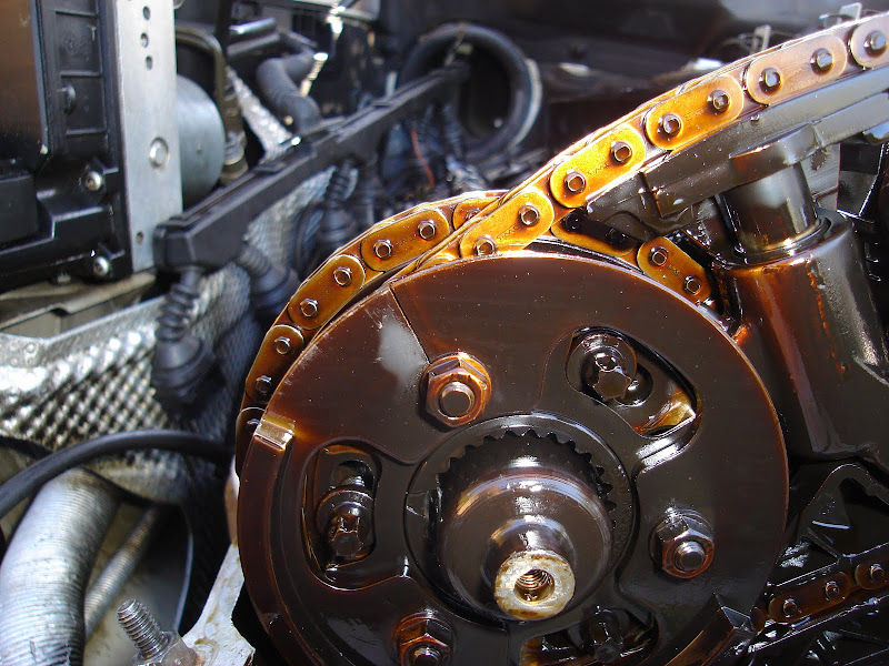

And found this:
THe exhaust vanos piston had a chip in. That cracked bit has a bit of a dent inwards so I can only assume that it was hit with something. Little bit was sitting really tight in there but I did not feel comfortable with the fact it might out and go in somewhere it should not. Agents was closed already. What now... so I phone freerider again to ask him for advice. Luck for me he had a secondhand unit with him he said I can buy but still needs to get new seals. No problem.
