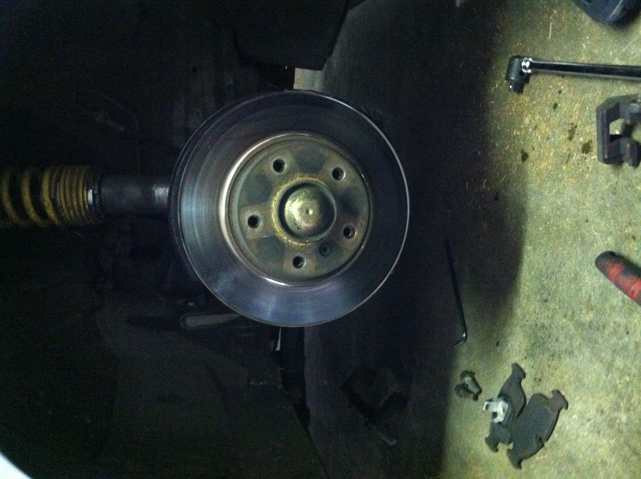

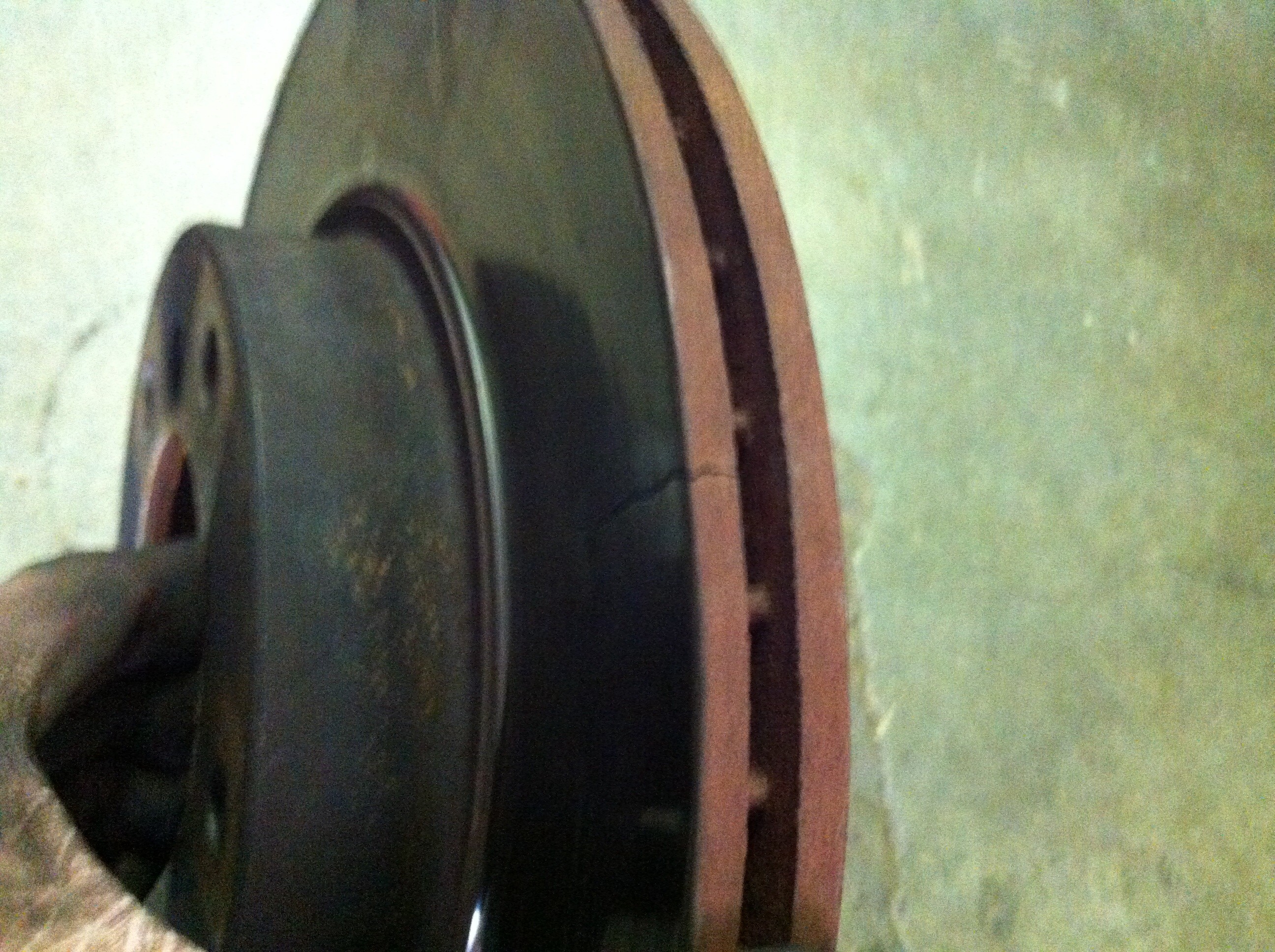

330i brake upgrade :rollsmile:
Below is the stock 286mm disk, notice the dust cover is visible !

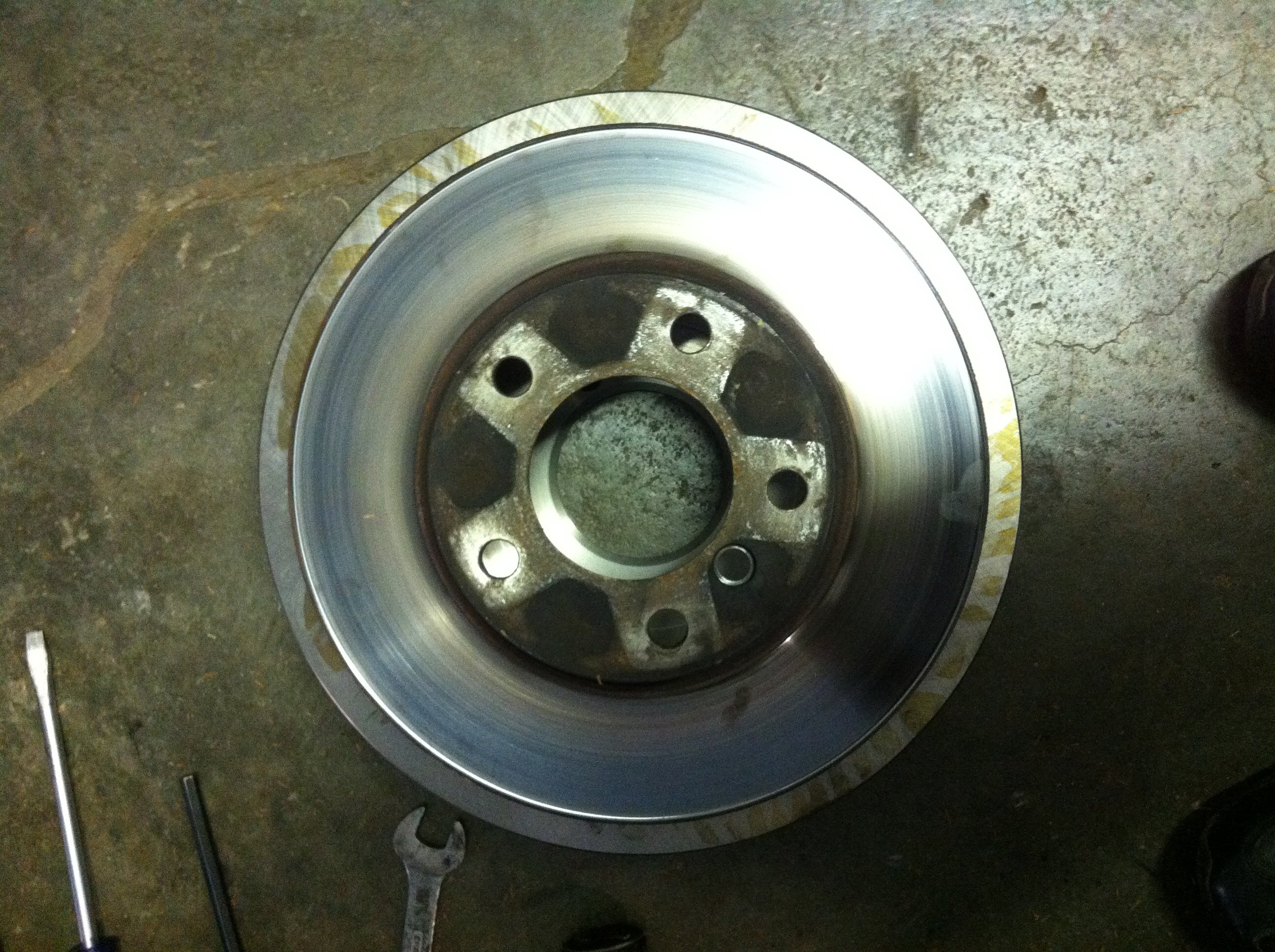

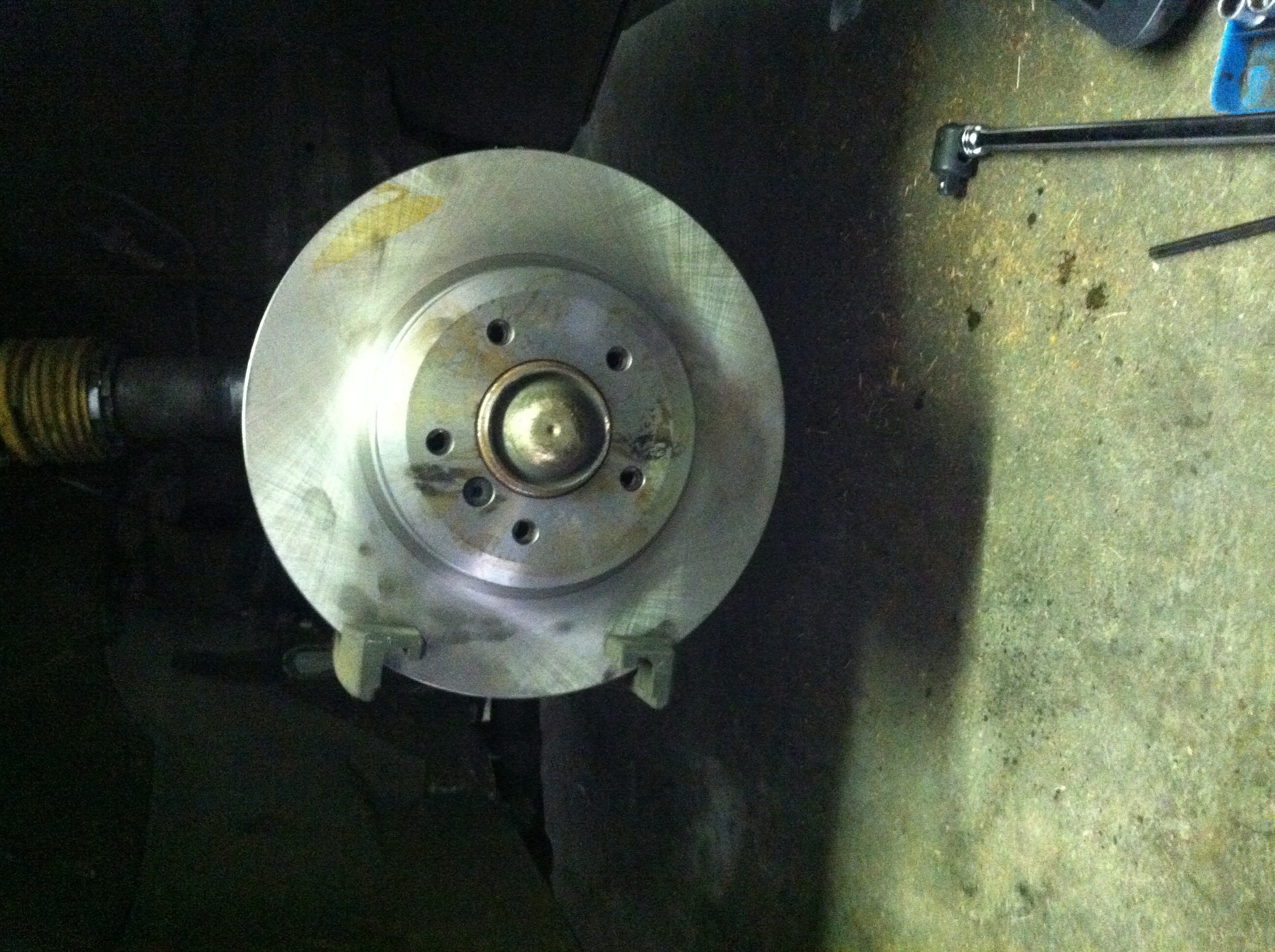

Below is the 325mm disk, notice that you can no longer see the dust cover !

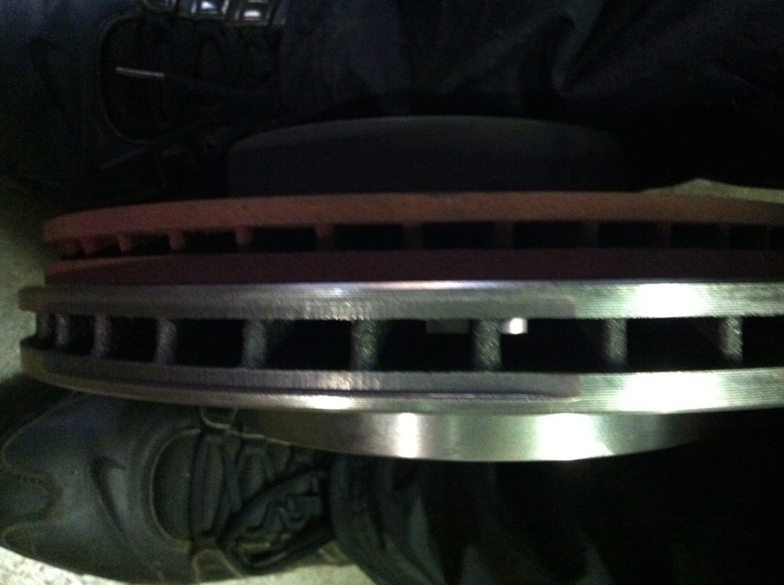

Old disk on top of new disk to compare their difference in size !
Difference in thickness

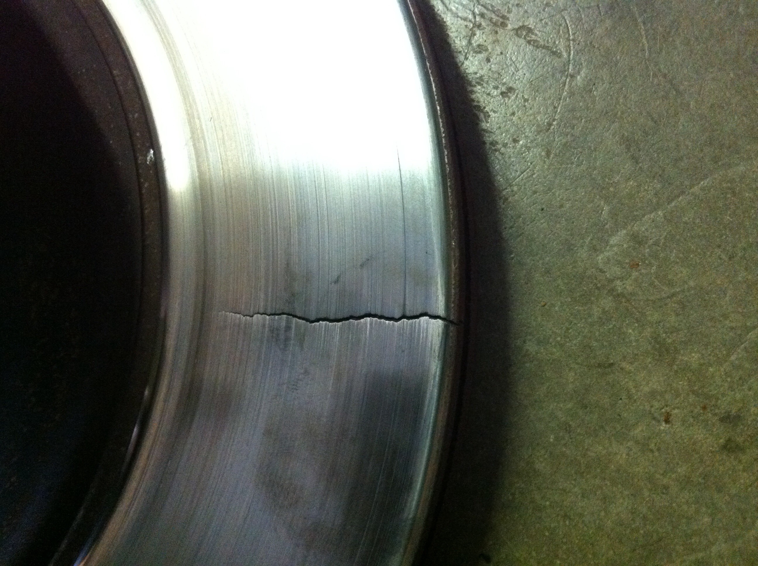

Old disk cracked :shocked:
Will be back with more updates soon.

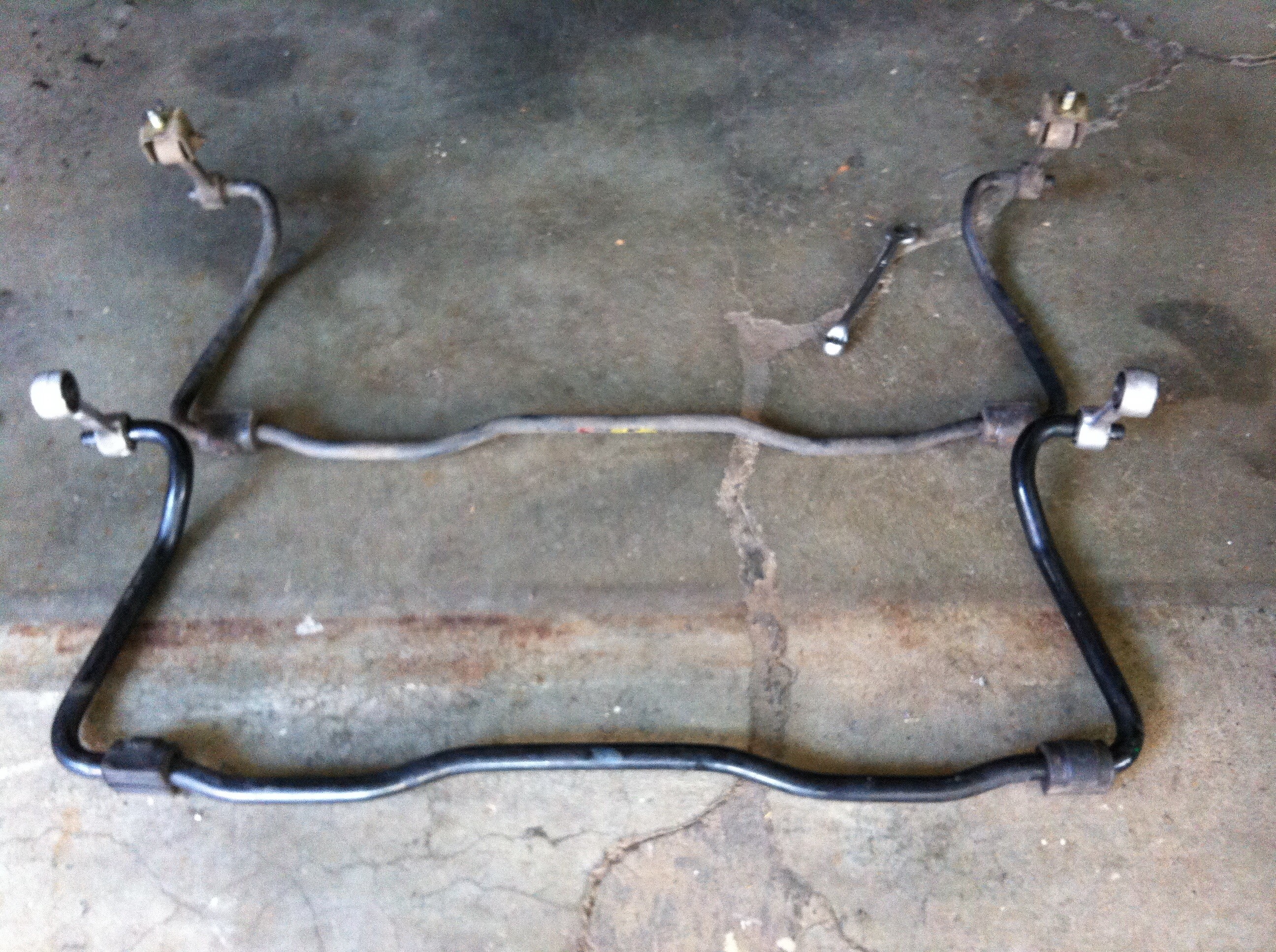

So this weekend I decided to install a M Sport 18mm rear sway bar and new end links, the difference is huge. The rear is so planted, the steering more direct and it doesn't understeer anymore !
Below is the 18mm sway(bottom) vs non M 15mm (top)

Its amazing what a thicker rear sway bar can do, good to see you bought new end links, Im sure your old ones were nackered. Looking good buddy! Whats next?

Nice. Did you cut the dust cover lip? Under the impression that it would rub.
I take it you had to replace the calipers as well?
Theo D
Nope ! No cutting needed, the lip curls inward towards the shock.
Yes I had to replace the calipers as well.
