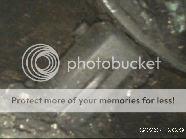

The problem came in when trying to remove the the wheel speed sensor. That thing is properly in there - no gentle persuasion would help. Without wanting to damage the sensor I resorted to a less intrusive approach. I had bought a endoscope previously to investigate a particular issue, which was then used to take a look at the sensor from the drive shaft side. Have a look below at what I found. It looked a little dirty, but nothing too crazy. (The pics were taken over the weekend - I forgot to set the date on the endoscope)

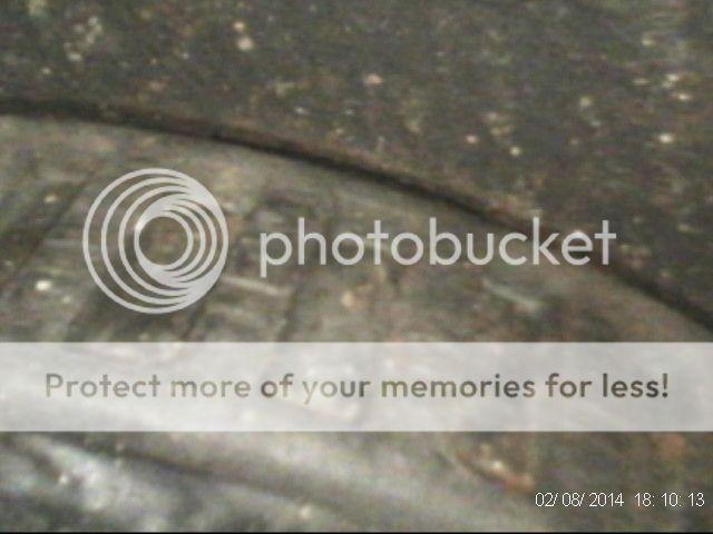

After a couple of blasts of sensor cleaner, the sensor looked a lot cleaner.

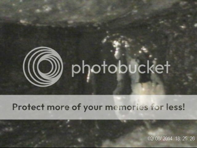

I thought all was good. After a little more cleaning I found the sensor was in fact broken! You can see the white internals of the sensor from a slightly different angle.
My theory is that something stuck to a tooth on the driveshaft and as it came up to the sensor, it just destroyed the sensor housing. The upside is that at least the teeth on the driveshaft are still in good condition.
