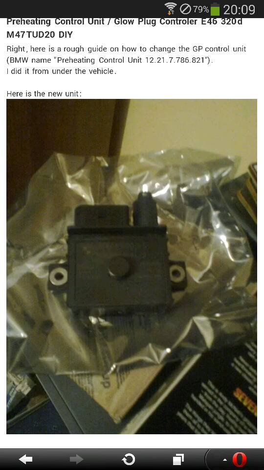

Thinking out loud here, could it be the pre heating control unit that's messing about? Hence picking up all 4 glow plugs as faulty, then again the diagnosis would've/should've picked it up, just my 2c. Note my 'knowledge' on diesels are slim to none so don't take my word for it.

http://www.bmwforums.info/3-series-...low-plug-controler-e46-320d-m47tud20-diy.html that's the link for the e46 320d diesel control unit if that's your fault.
pics of the unit for e46.
