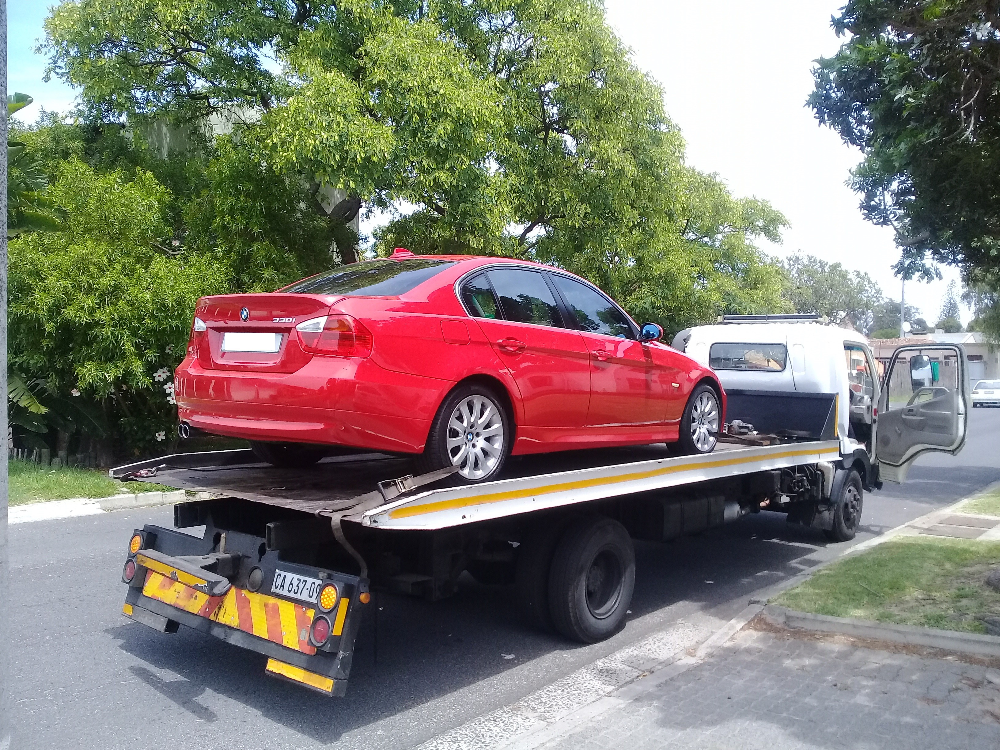

Okay i think to update everyone. I decided its best to be safe and towed my car to a shop in montaque gardens for an assesment. They are busy removing the compressor as im posting this.
